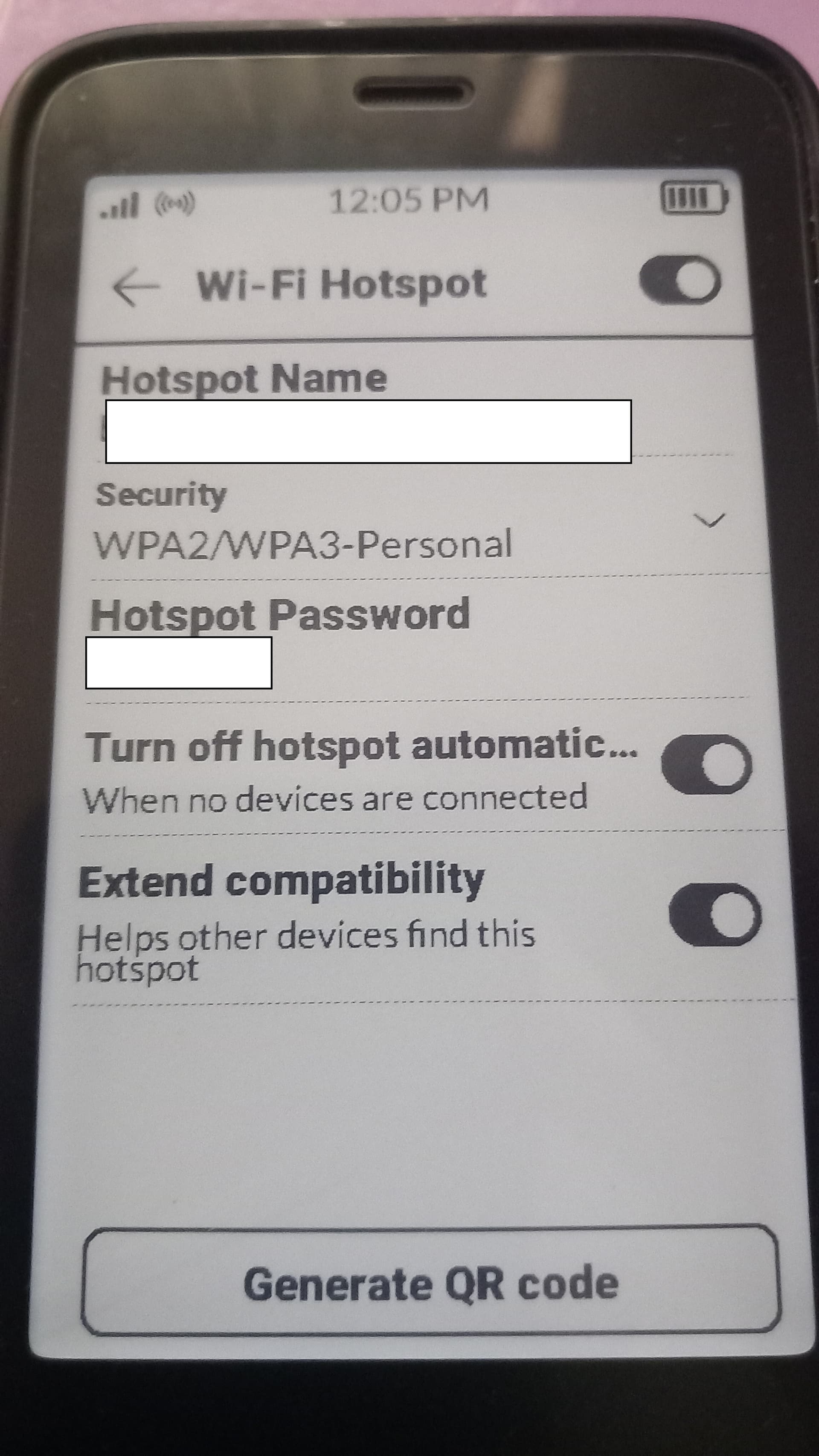

Is my Kompakt unususal in that the hotspot auto not in use switch off function doesn’t work? Like when nothing is using the hotspot it should switch off right?

Hi Urszula,
just to be clear here is a picture of how my phone is set up.
My hotspot does not automatically switch off when it is not connected to any device. It will stay on until I manually switch it off. I have tried this in a forest , anywhere. Its the same.
@jambon I’ve reached out to our team with this because I’m not sure what could be causing this.
@jambon Can you please answer these questions from our team:
These are their questions:
  • How long are you waiting for hotspot disconnect
  • Is device connected to usb-c power?
  • What third party apps are you using - list all apps
  • What devices are you connect to and how many (Macbook Pro can be connected to Wifi even when its ‘turned off’)
  • Have you tried to exit this screen and enter it again? Maybe screen didn’t refresh
