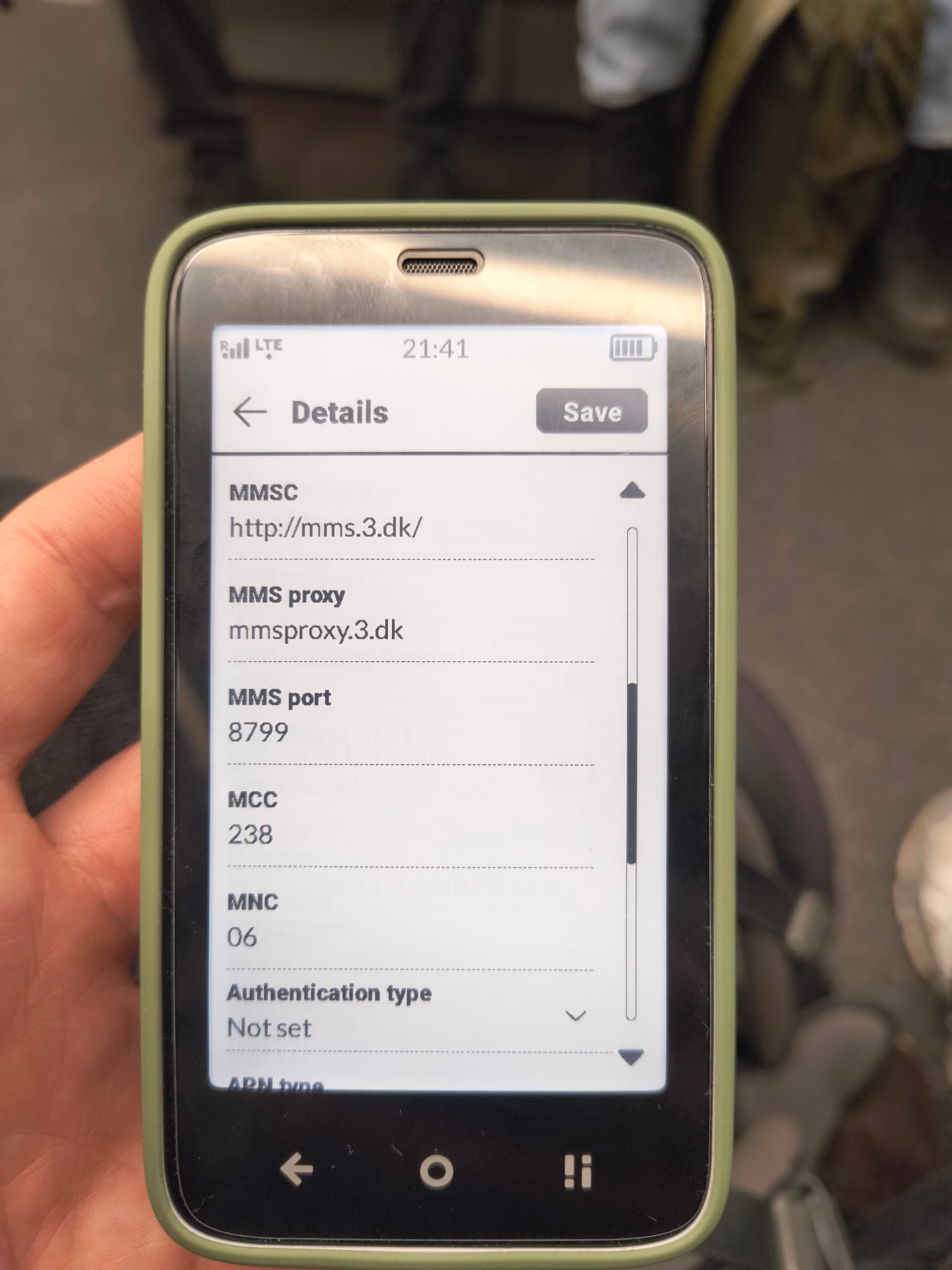

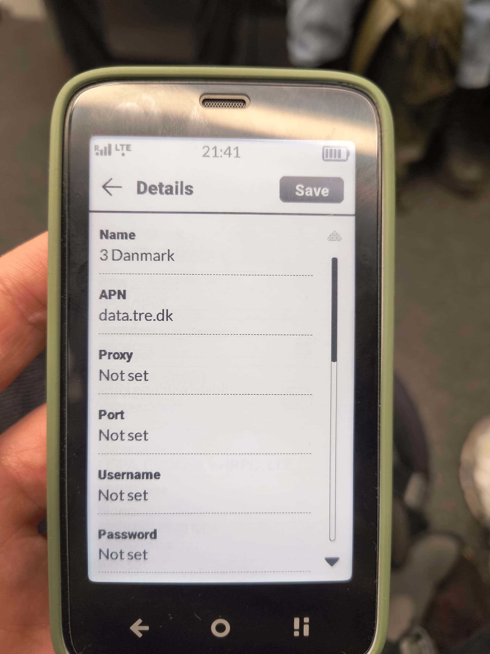

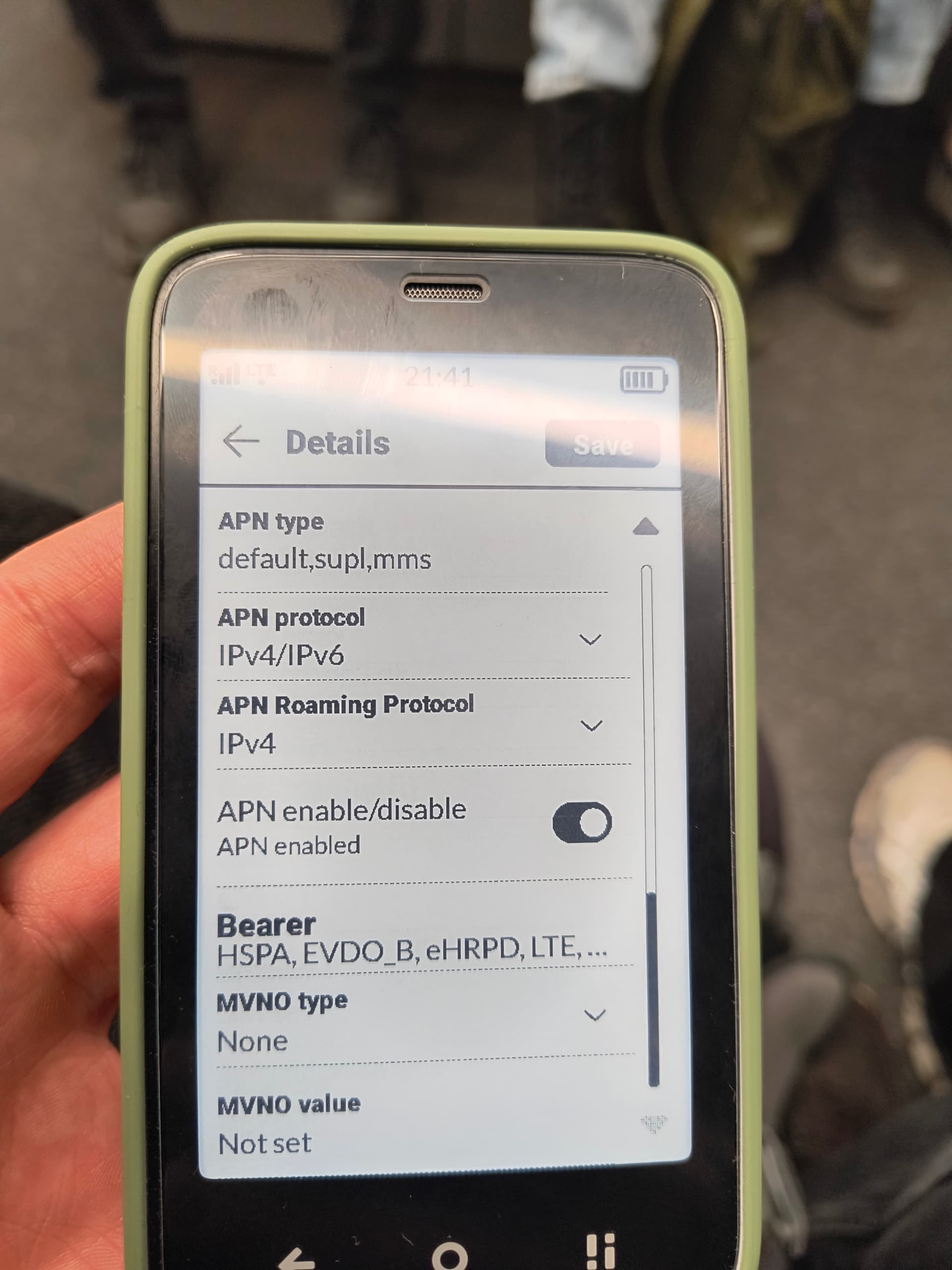

Who is your carrier, and what are your current APN settings? Can you provide screenshots of them?
Carrier is 3, in Denmark. In Germany where I am right now I change between carriers. Without any luck.
Apn I don’t know, but I will take a picture
