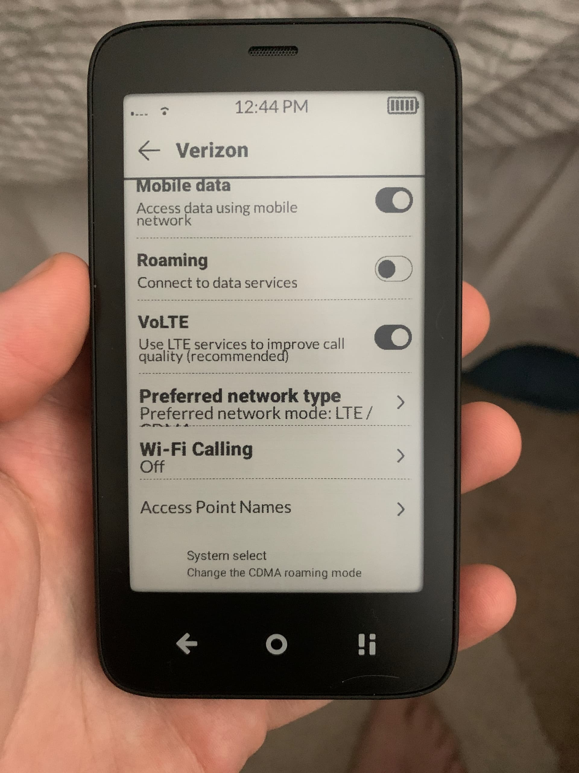

I got my Mudita Kompact (USA) in yesterday. I am not able to receive MMS messages or RCS messages. I’ve read about this problem eslewhere, but I am not able to receive group messages AT ALL. I am not able to EDIT the APN information either. There is no “+” at the top right of the screen. So I cannot test whether that would fix anything. I also saw somewhere MMS settings under the SIM Card options? No such options exist on my phone. Unfortunately, this will be what forces me to return the phone, if I am unable to get it fixed.
@jared I’m so sorry that you are experiencing issues- but welcome to the Mudita Forum :slight_smile: We’re glad that you’re here.
Which network provider are you using?
Let’s see what we can do to help :slight_smile:
Mudita Kompakt supports MMS messages, but currently does not support RCS.
Please check to make sure you have enabled your MMS messages. There are two places to enable:
Network settings & SIM Card settings
Additionally, please check if your APN settings are correct for your network.
Hey, Urszula. Thank you. I’m on Verizon. I saw those previously in the thread, but my Kompakt does not display those options when I go into the settings.
  1. The sim card settings only lets me see the sim card. I cannot click on anything to bring up additional options.
  2. The network options also do not display anything about MMS messages, even when I click into the “advanced” menu.
  3. I can see the APN settings, but it will not let me edit them (though the numbers appear to be correct).
