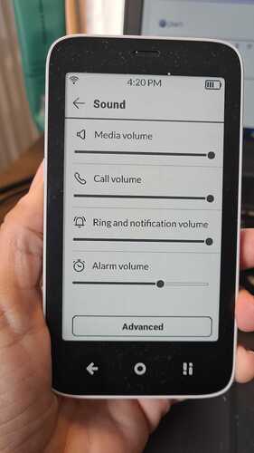

@urszula koodo, a telus subsidiary
@jawn That’s odd. Can you send a picture with your sound settings?
My settings are the same like yours for Media and Call volume, but today I’ve got a call while on the train and relying on the speaker while holding the phone to my ear I had a really hard time understanding the person on the line even with Call volume at maximum.
