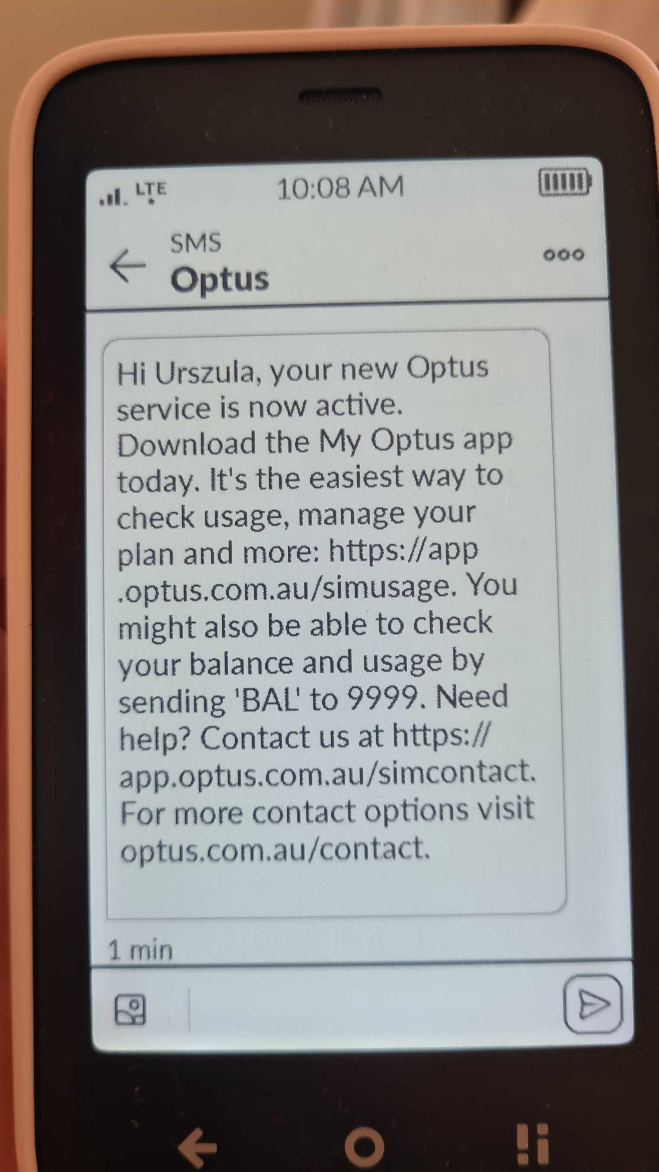

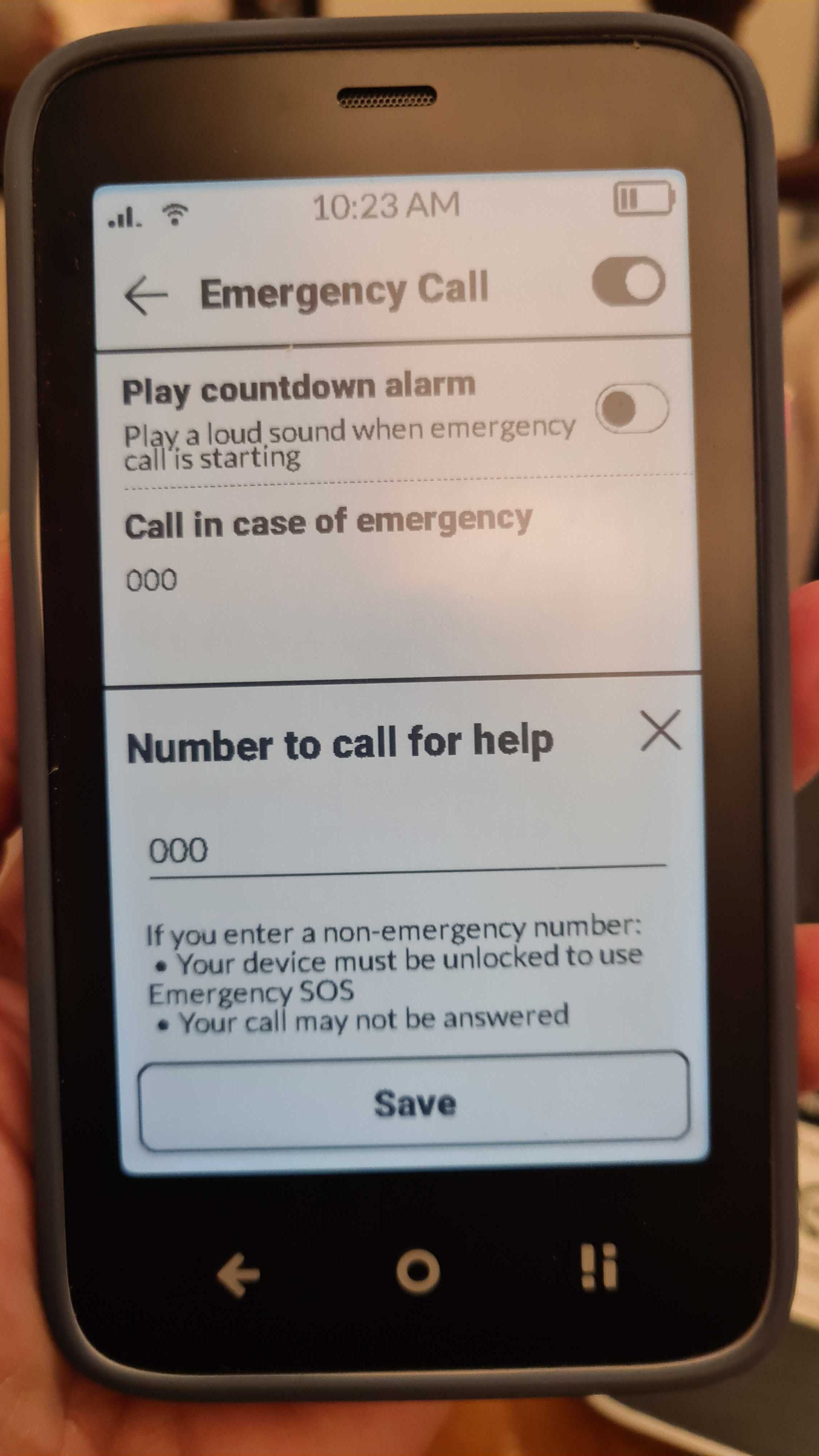

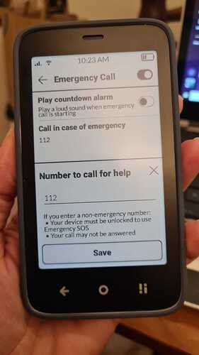

Just a side note, I’m currently ‘down under’ using OPTUS & I was able to dial Emergency services. You can go in to SETTINGS & the device menu allows you to choose the emergency number.
Mudita Kompakt does not hardcode a European emergency number. You can set 000 directly in the Emergency Call settings. That’s what I did.

They are on it. Once I have a clear answer I will post it here. Meanwhile, I am enjoying using my Kompakt ‘down under.’ So far, I have not had any issues on Optus & I haven’t received any messages from Optus about blocking my phone.
