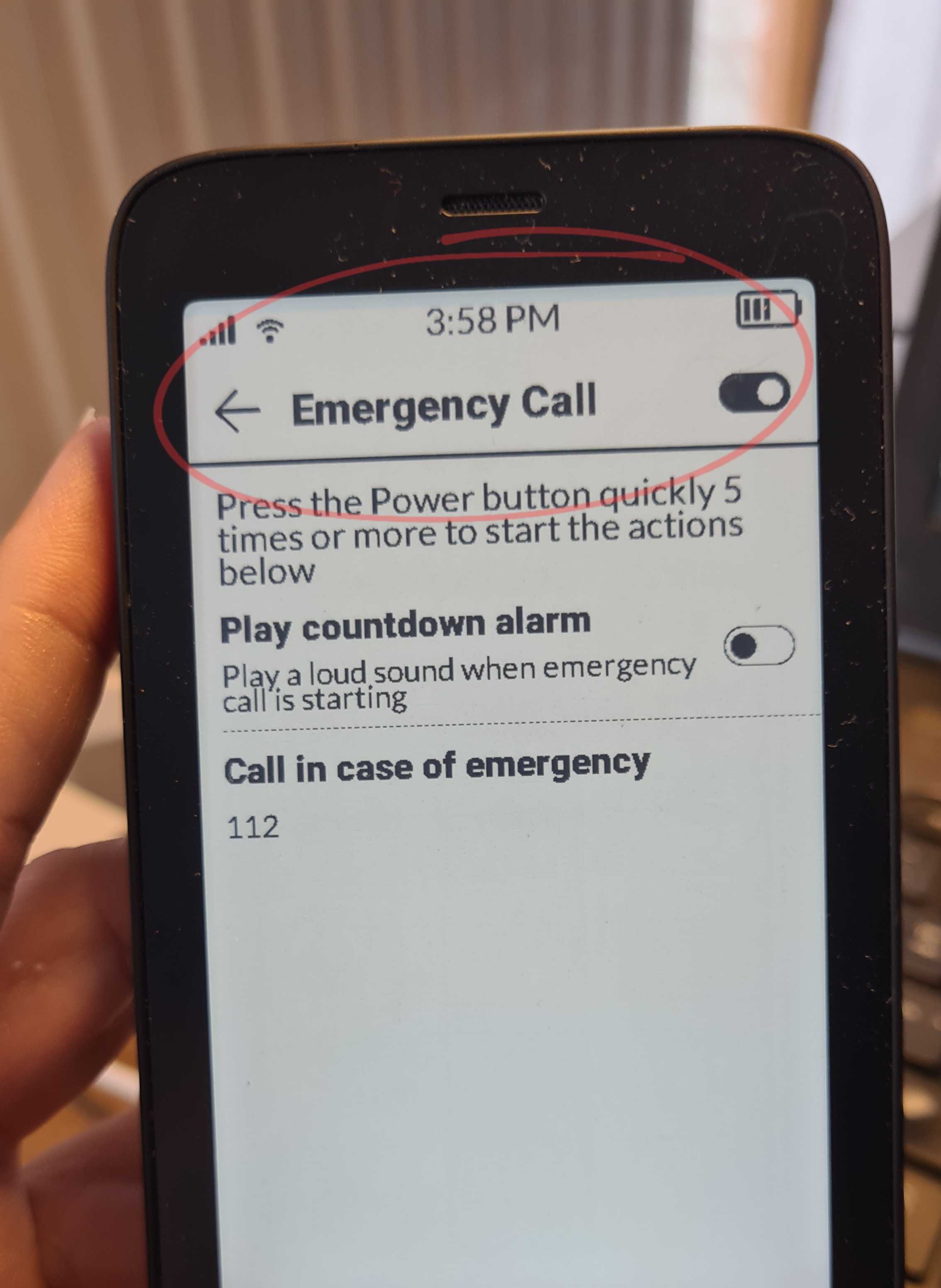

There is a feature in Mudita Kompakt that lets you dial emergency services by pressing the POWER button 5 times in a row. It’s enables by default- but you could turn it off & then just dial dial emergency 112 or 911 directly from the dial pad.

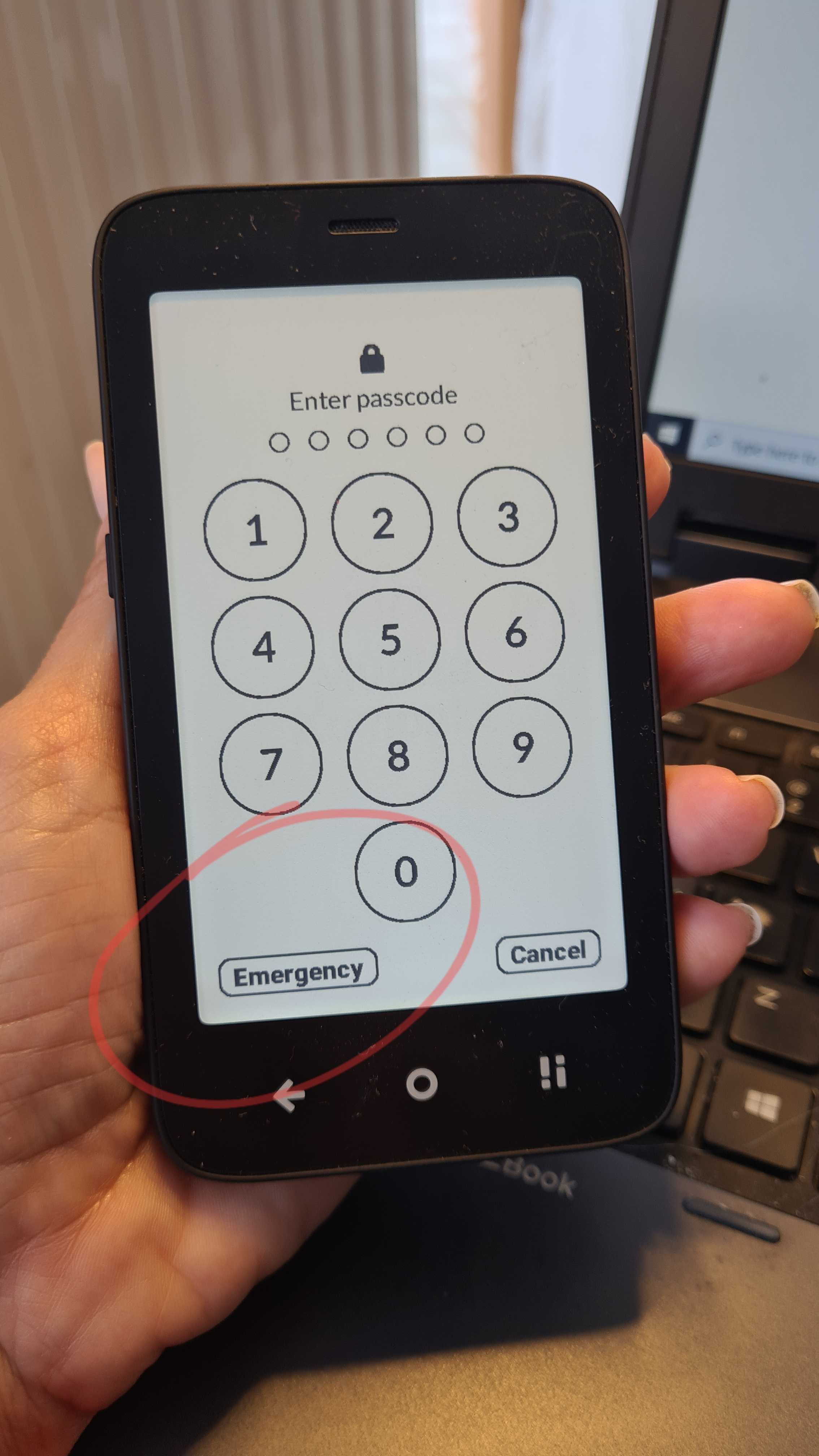

Hi, I also called 911 today with the phone in my pocket. I don’t have fingerprint set. I have to press on the power button, swipe up (Emergency button shows here) and then use a PIN to unlock. So it seems Power button + Swipe up can happen in my pocket.

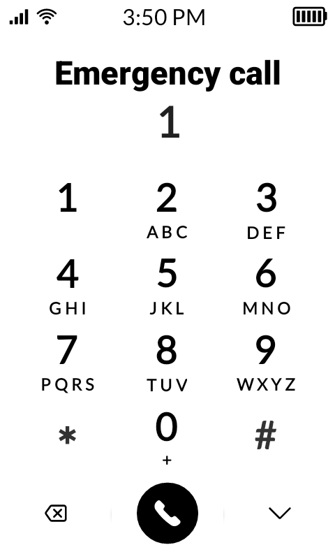

Is the only solution still to change the emergency number to 1 (or something else) for now?

@mary I think you have this option set by default.
You can disable it, but you’ll still be able to call emergency services on the keypad.
Is there an option that the “emergency” option that shows when you are on the passcode screen can be removed? In my experience this is what happens - fingerprint is too sensitive, it props up the passcode screen and from there it is VERY easy to accidental push “emergency” and call 112. I feel that removing that will greatly improve this problem!
Yes, but I find it unlikely that the power button would have been pressed 5 times in a row from within my pocket. I tried it manually on purpose and it didn’t always work. So I’m thinking it most probably got pressed once and then with movement it swiped up and the Emergency option on the keypad was activated.

Yes! Exactly this one :slight_smile: I did follow the advice of other people and changed the emergency number to just “1”… But it still dials it anyway… and it’s getting frustrating.
This is what happens - any skin contact to the fingerprint sensor activates this exact screen and from there “emergency” is pushed and it dials. If we have the option to remove it from there - problem solved. Atleast for this scenario… :slight_smile:
@astratev So, we found the culprit. Let me see if anything can be done about this.
Just wondering, is the issue happening also if the phone is put in the pocket back-to-butt?
Solution is simple, when the screen is locked (showing the Mudita logo, “Mudita Kompakt” and the button hint with arrow), the pin pad should only appear after pressing the button, never after only touching it. But touching with a valid registered fingerprint should still unlock the phone without having to press the button.

i think it could be solved. there is an software issue, the unlock screen should not react to the sensor but to the full press of the button. which is a bug imho. would love to see this fixed as well.
This happened to me this morning while I was out for a walk with the phone in a loose pocket. I have the “dial emergency services” option turned off completely, so it’s definitely that button on the dialpad.
