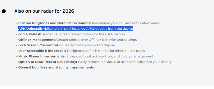

hey! wondering if there is any update on this.
@nyan-nat Currently, there is no native way to do this. I, personally, sideloaded an app called Batch Uninstaller:
APK uninstall is on our roadmap for 2026:
You can see what’s planned by going to the this website:
