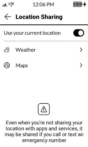

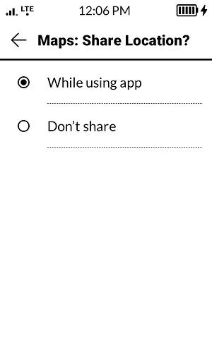

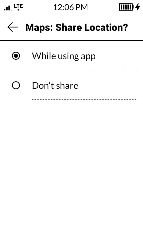

Please make sure you followed these steps:
Turn on “Use your current location”
Go to the Maps or Weather app and select the “Share” or “While using the app” option

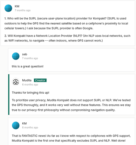

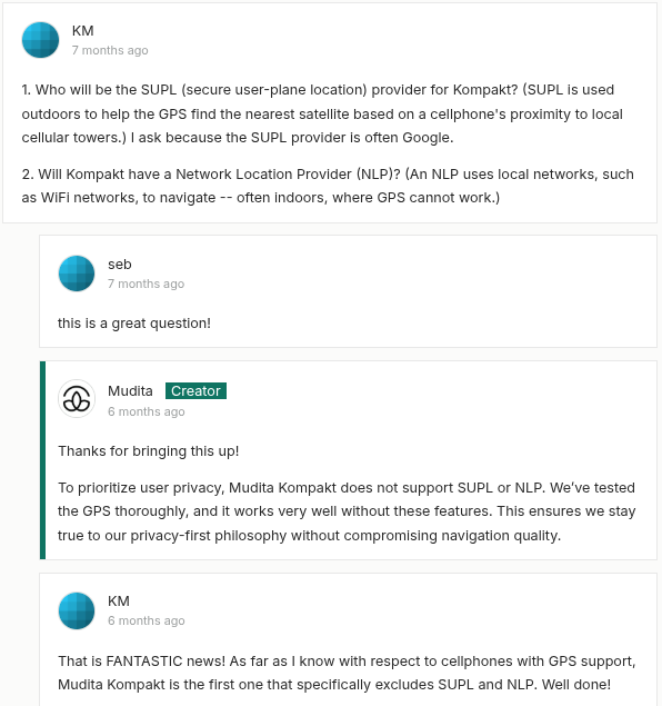

We’d like to clarify how GPS works on Mudita Kompakt & that Mudita Kompakt uses pure GPS, meaning it relies solely on signals from satellites. This approach ensures that your location data stays completely private and never leaves your device.
Unlike most smartphones, which often combine GPS with Wi-Fi, cellular, and third-party services to speed up location detection, Mudita Kompakt is designed differently. We made a conscious decision not to use those additional sources in order to protect your privacy and maintain our commitment to mindful technology.
As a result, acquiring a GPS fix may take a little longer—especially in areas with limited sky visibility, but we believe the trade-off is worth it for those who value security and simplicity.

For those interested, here from the Comments section of the Kickstarter campaign for Mudita Kompakt are the technical details behind the above post by @urszula:

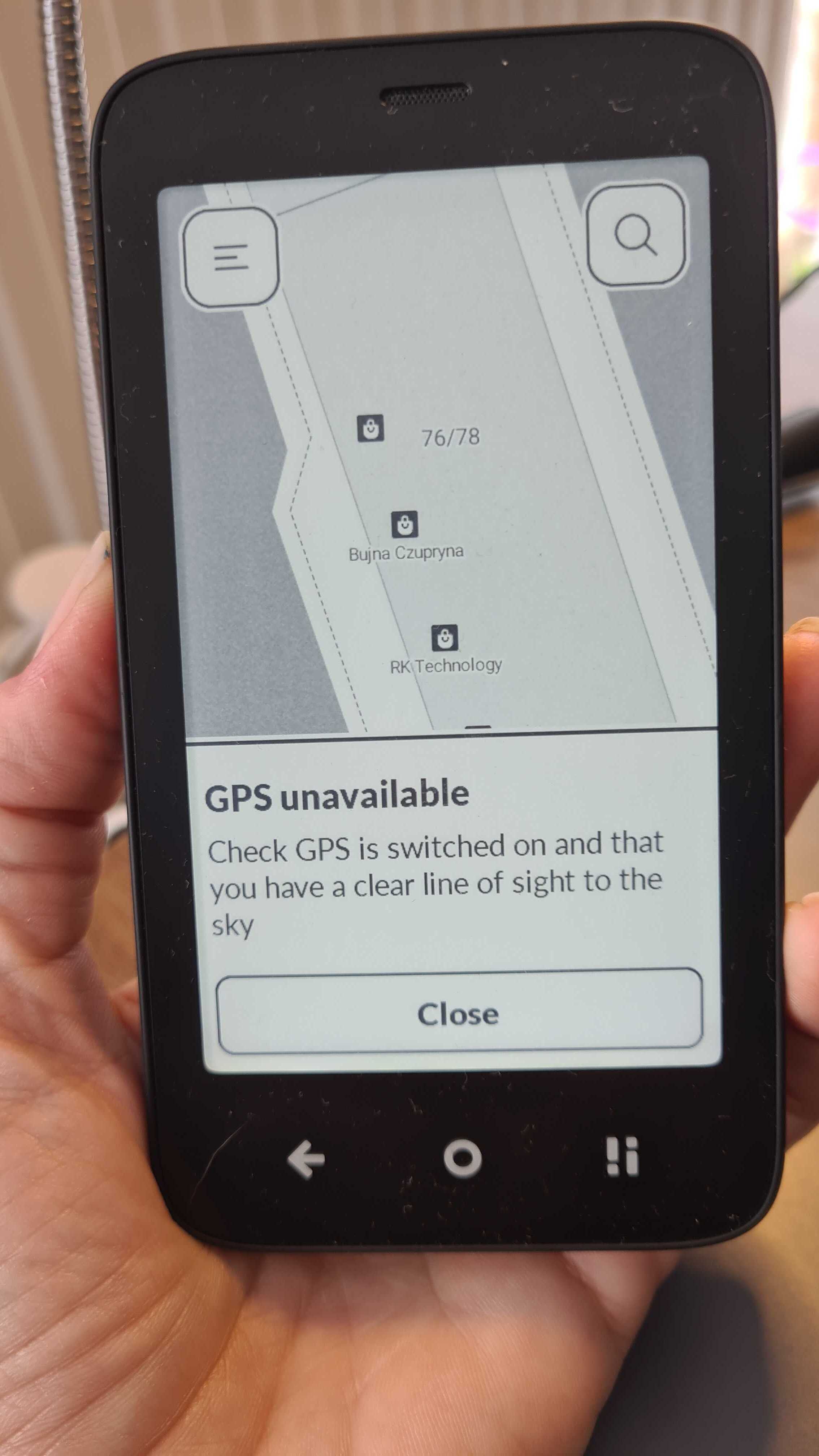

I’m still having this problem. I just no joke spent the past four hours outside on a clear day and the gps never worked; it immediately says “GPS unavailable.” I tried checking my location sharing and permissions settings, toggling airplane mode on and off, offline mode, even restarting the phone. It still says “GPS unavailable.”
@lunaralias17 Is this the message you’re getting?
Yep, that’s it.

@lunaralias17 So, that happens to me when I’m in doors. I’m going to ask devs what could be happening here. After 4 hrs outside, it should work.
Thanks, I tried it again today and still get the error.
Grasping at straws here, but this worked for me when I first received my Kompakt:
  1. Settings…Location Sharing
    Turn on Use your current location
    Under both Weather and Maps, share “While using app”
