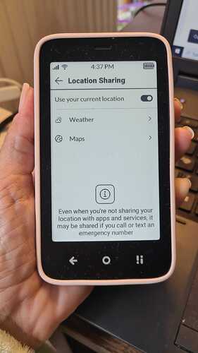

@tennessee Have you had GPS signal at some point & now it’s just stopped after resetting the device?
I just received my phone. It never worked. My phone also showed the weather in Warsaw, Poland when it arrived. I thought it would adjust when I turned on wifi to setup phone.
Default Weather location is set manually. Click on the Hamburger menu on top left, then press the pencil and click on Warsaw to edit your default location.
@tennessee Please make sure you have enable location sharing for BOTH Maps & Weather.
You need to be outside, with the clear view of the sky. It does not work indoors.
It worked this morning. Thank You
@tennessee AWESOME! Good to hear!
