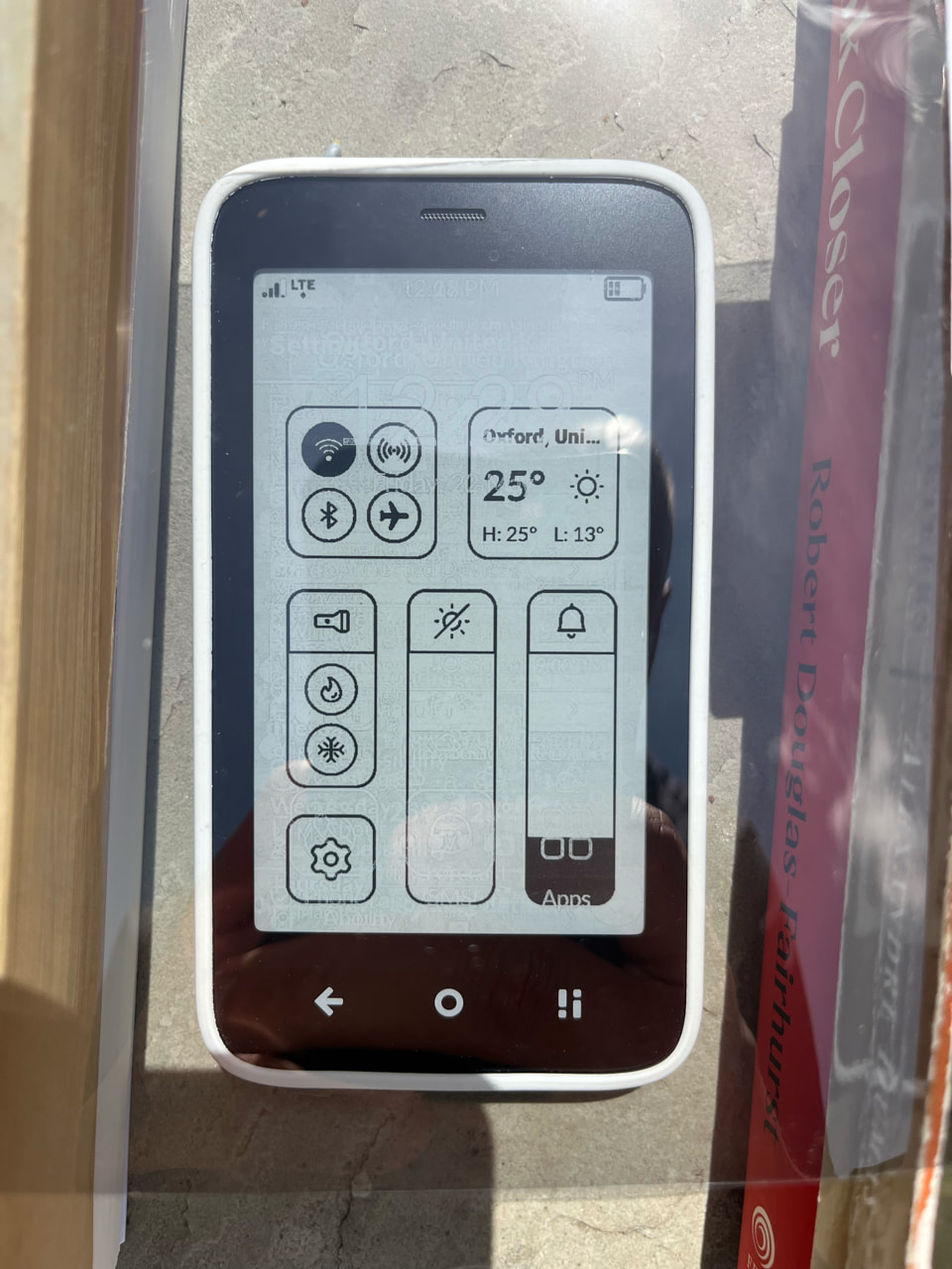

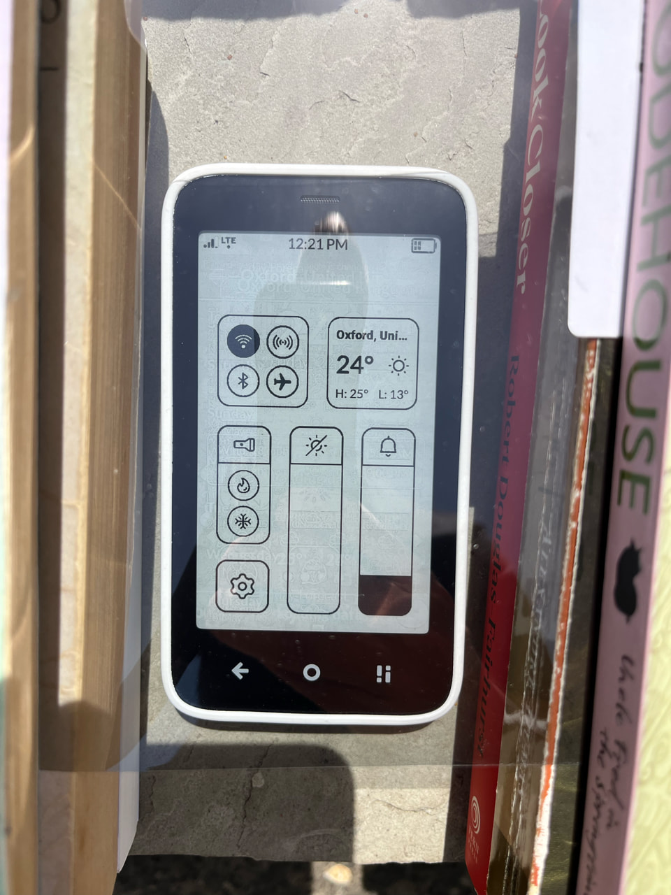

1. Control centre (beneath shield)
1.1 Images
Notice:
(1.1) The time disappears (top of screen).

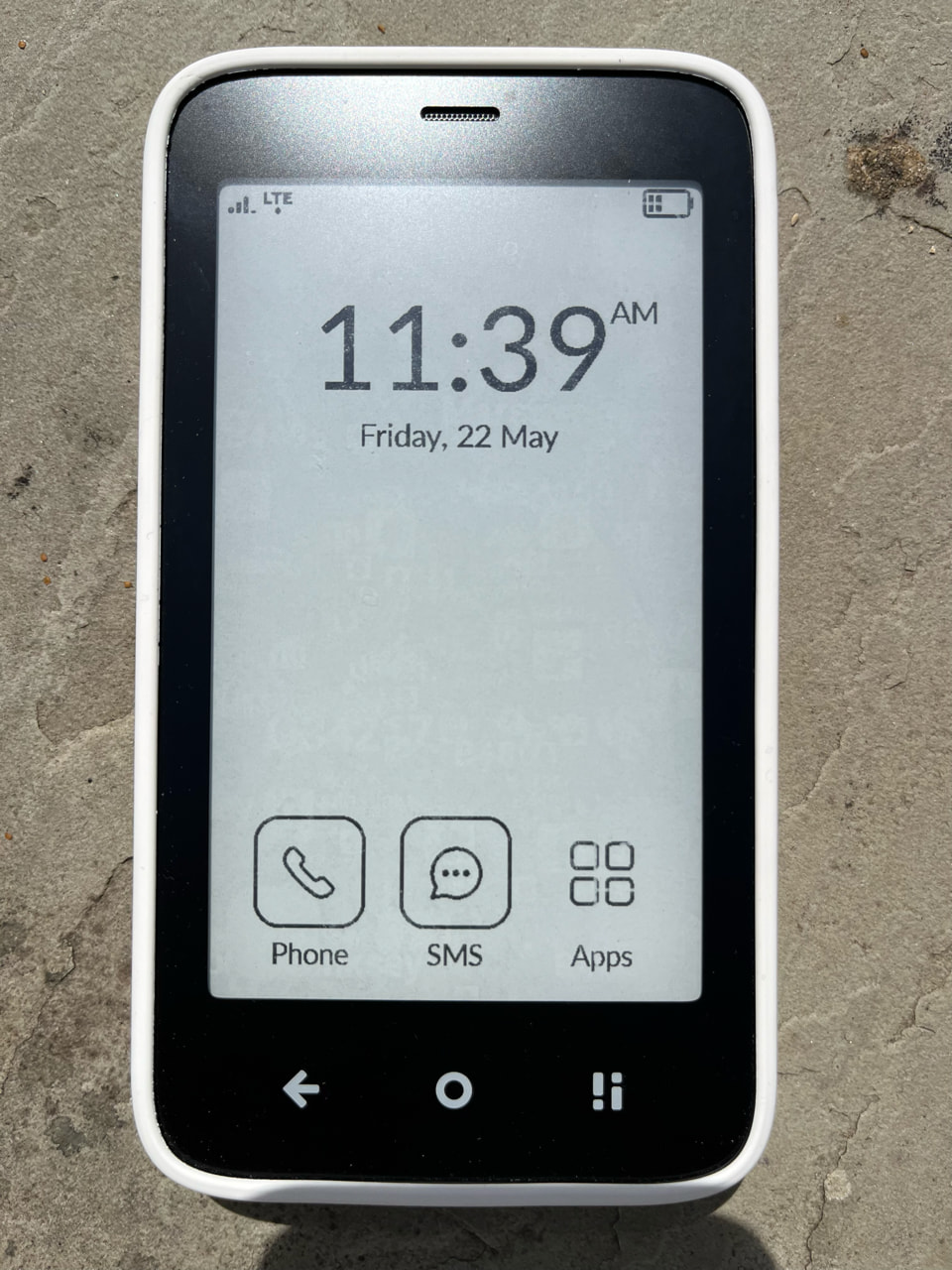

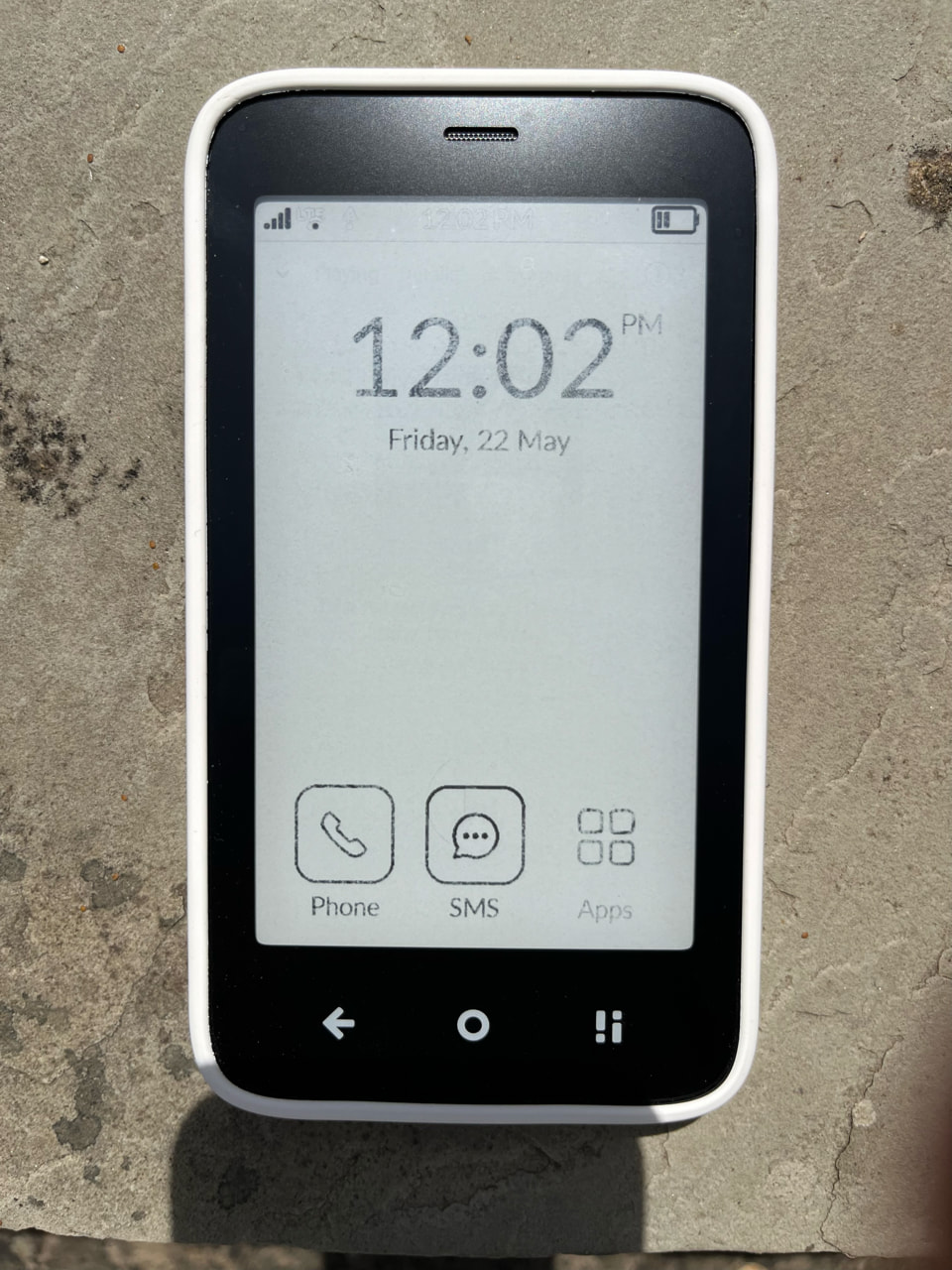

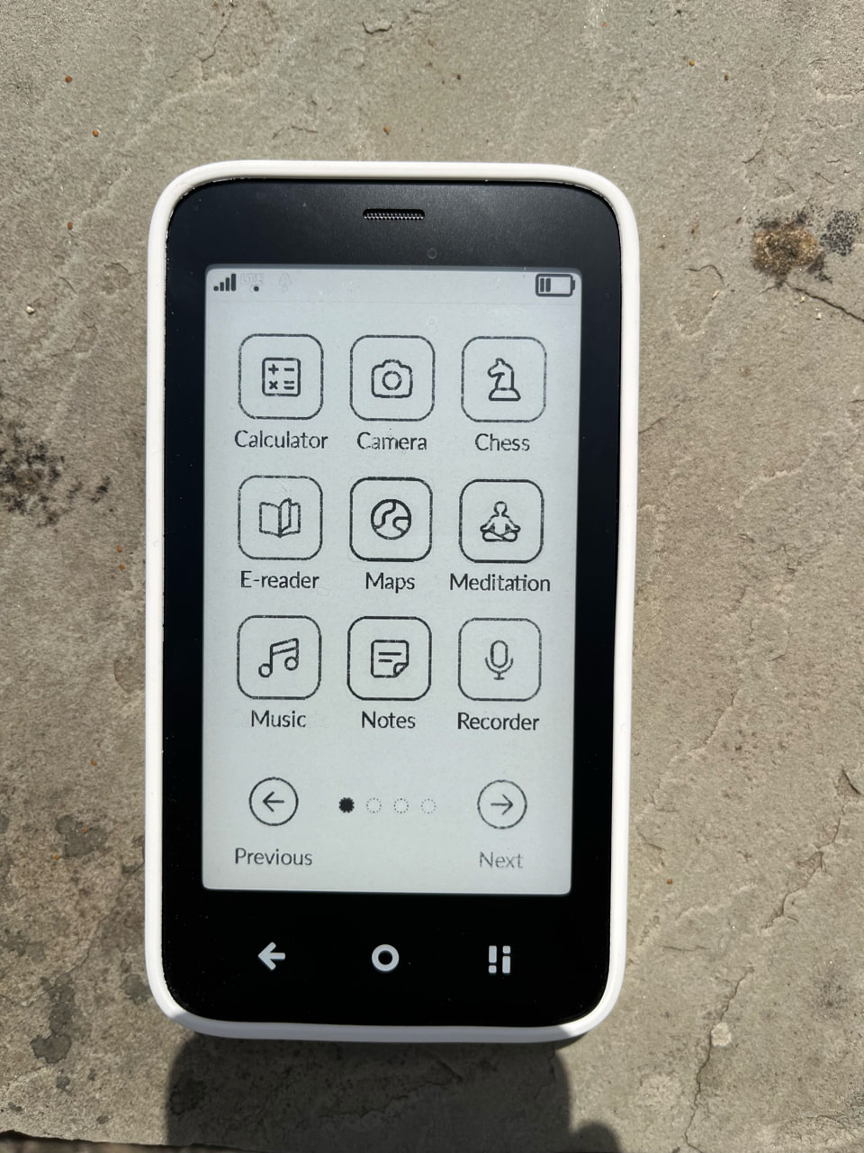

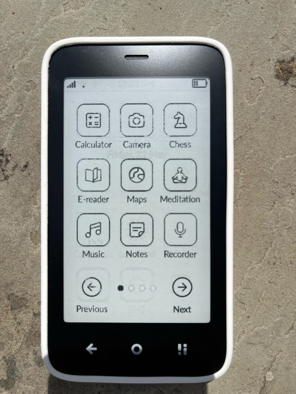

2. Home screen (no shield)
2.1 Images
Notice:
(2.1) Black cells faded to grey
(2.2) The indicator ‘LTE’ disappears.

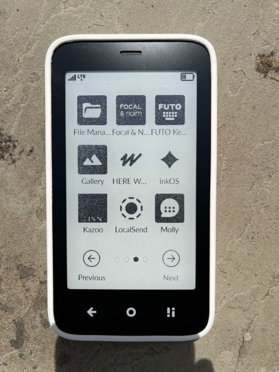

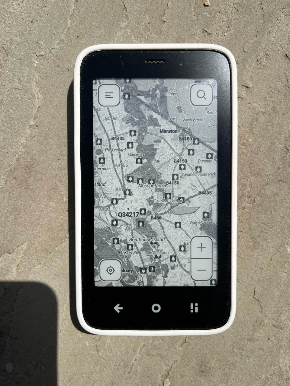

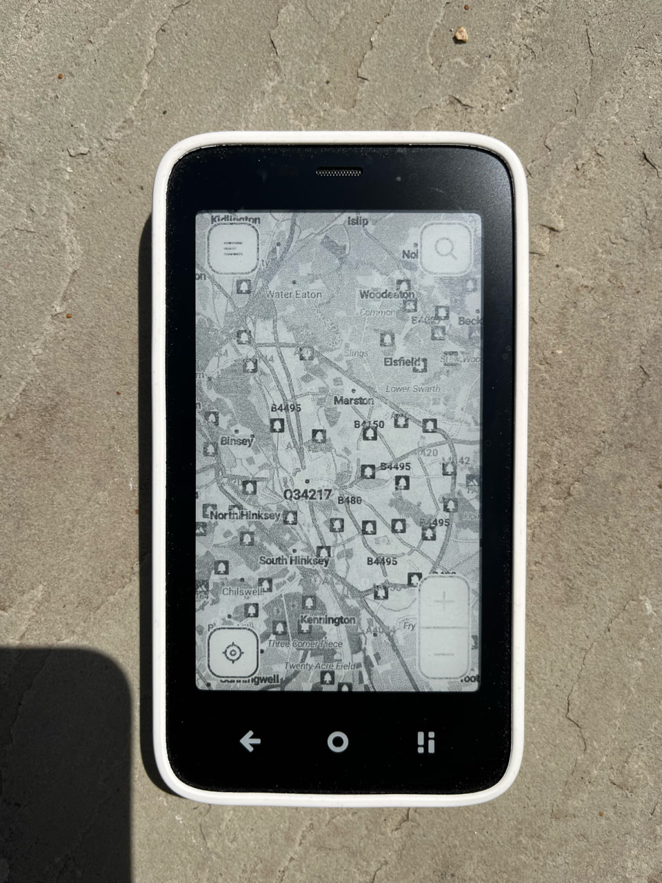

4. Maps (No shield)
4.1 Images
Notice: Black cells faded to grey (esp. control buttons)
4.2 Video

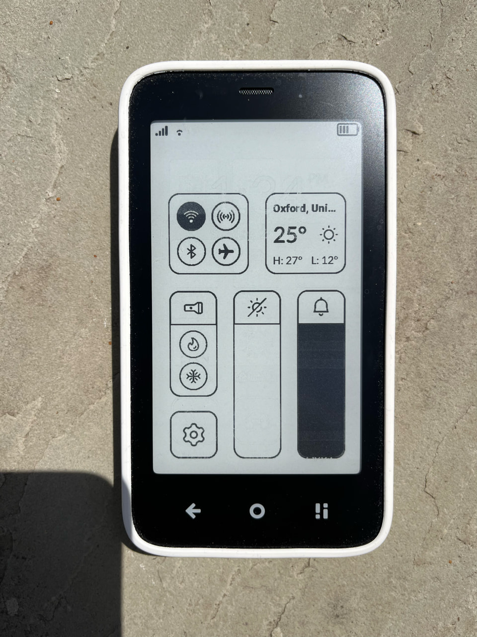

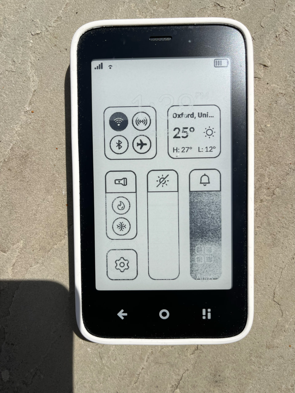

6. Control Centre (No shield)
6.1 Images
6.2 Video

@smuch, you should watch video 4.2 again. Notice the device is locked. (The lock screen de-ghosts the screen.) When it is unlocked pay attention to the rich blacks on the home screen. Within a few seconds, the maps apps is launched and the blacks immediately fade. So, the device does not need to bake in the sun for a long time to see these effects.

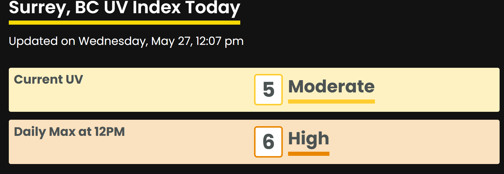

I am not sure how helpful this is to anyone but the current UV index in White Rock/Surrey BC is 5. Right now my screen fades within seconds of bringing out into the sun.
I popped outside an hour ago and when I checked then screen was fine. I do not know what the UV index was then.

@esquared , thank you. I wish more users would test on their devices so we can begin to see the scale of this issue. However, if you conceal your phone behind a standard glass window (which blocks UV), you’ll see the same effects occur. (This is shown somewhere in my earlier analysis.) So, that rules out UV. Later, I used an IRR (infrared reduction) shield, so that rules out infrared and near infrared (NIR).
