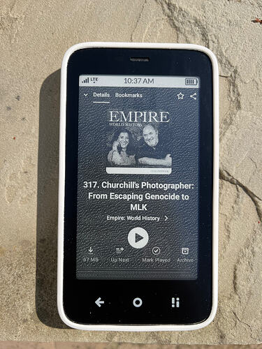

I have a new white case on the way. I’ll expose it to the same conditions (as far as I’m able to replicate them) and see if makes any difference. I presume you don’t have one to test it to see if helps.
As mentioned, if the white case helps, I’ll keep the phone. If not, I’m afraid it’s the death knell.

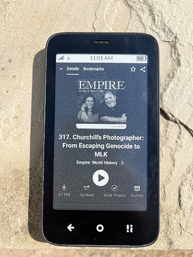

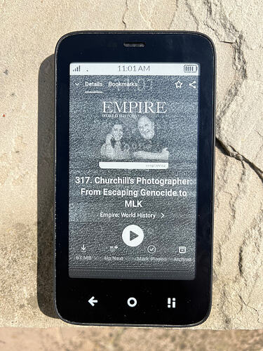

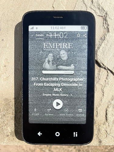

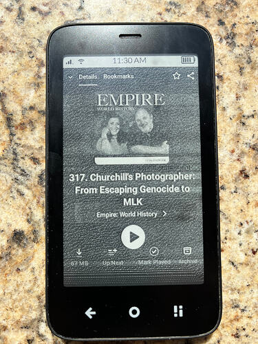

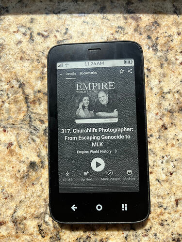

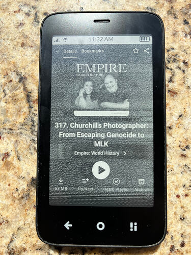

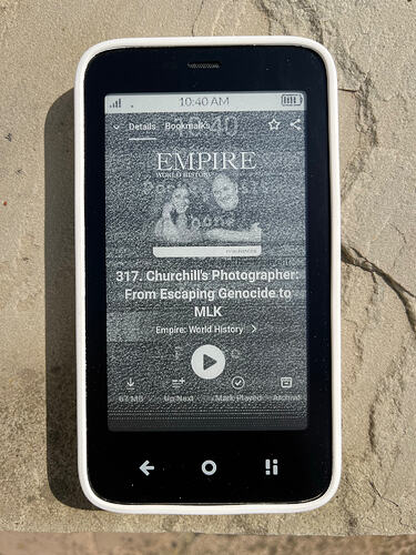

Well, I applied the white case and, I’m afraid, the results are not good. The conditions when taking these photos were 16ºC (sunny), in Oxford, UK.
See images for results.
Without a case:
With a case:
Behind a window (in direct sunlight):
I tested behind glass to see if the reduction in UV (through glass) might provide any insight. There is the greenhouse effect to be considered which makes the spot behind the glass hotter than outdoors on the patio slabs. Anyhow, the same display degradation is visible. What this does show is that UV is not the cause.
In conclusion, the results are the same, with or without a case, with or without a screen protector. The difference in duration to show degradation is neglibile, but clearly it takes less than a minute to see real deterioration of black artefacts in the display.

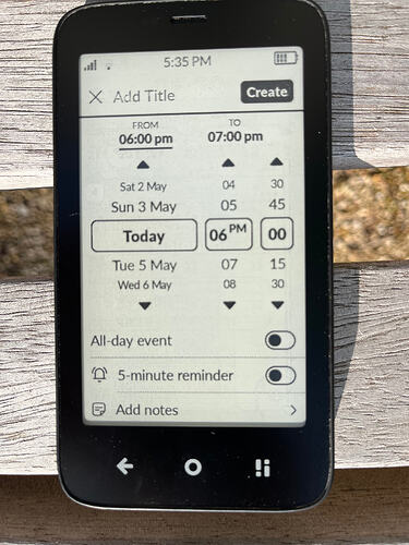

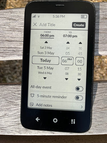

Alarm
Pay attention to the fading of numerals in the centre and box outlines.

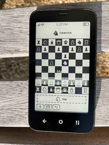

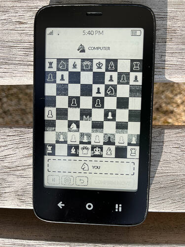

Chess
The 1st picture (which is the better of the two) showing the Chess app already shows the leftover screen display issues from being in the sun.
Notice the material degradation of other black squares on the board.

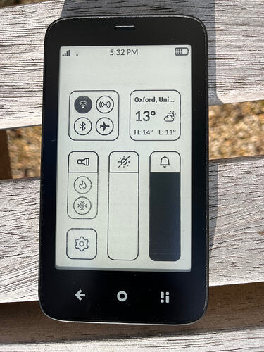

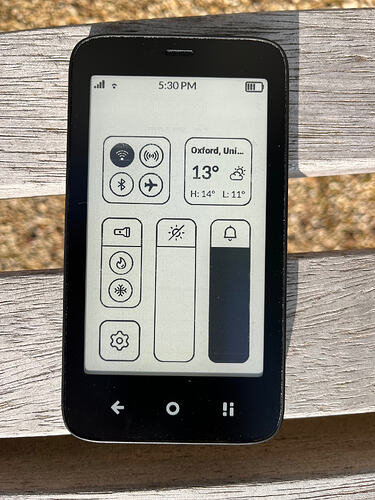

Control Centre
See the torch / flash light box and icons. Also note the gear icon and box outline.

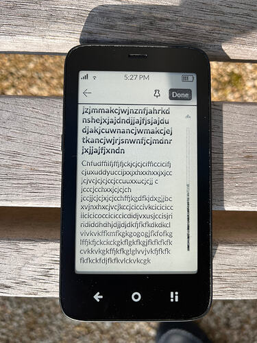

Note
In this 1st photo (of two) showing the Note app, signs of solar radiation exposure.after a short while are already present.

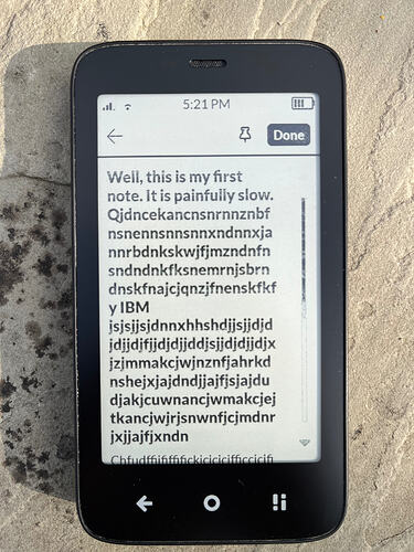

Grainy horizontal lines span the text across most of the screen. (I scrolled down for this.)

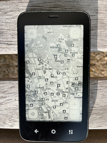

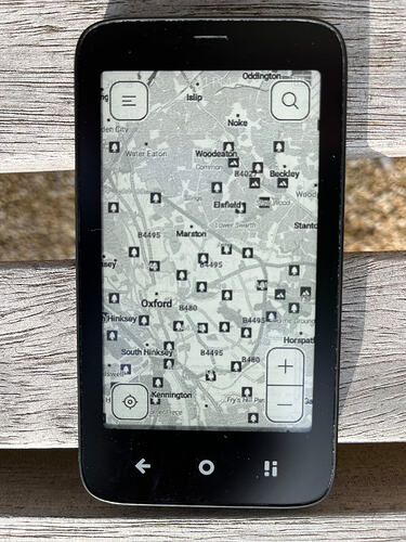

Maps
(Note: This app is full screen so the top bar showing the time is not visible.)
The deterioration is stark and visible across the whole screen. Dark greys have become light. Boxes featuring controls are ghostly pale. Text crispness has disappeared. Some letters are so blurry as to be unreadable. (3 instances of road B4495 are readable in photo 1. Only two are readable in photo 2.)
