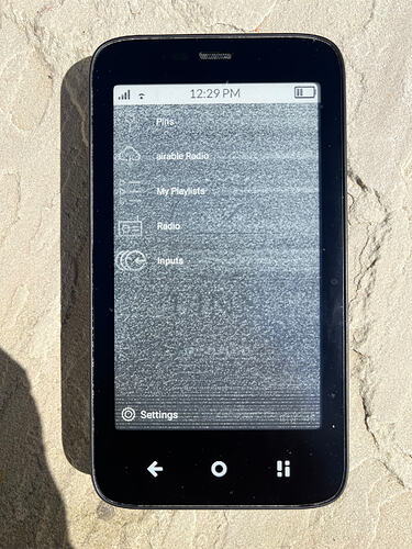

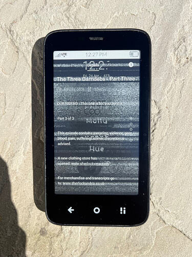

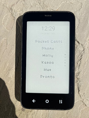

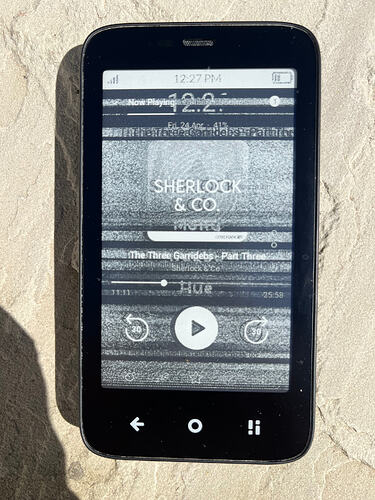

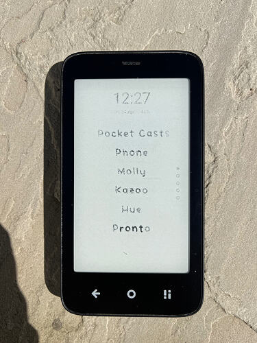

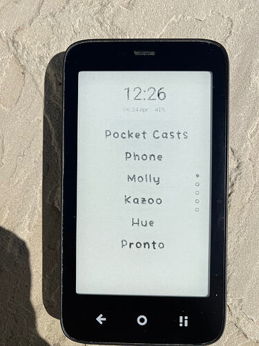

OK. So, we’re enjoying that rare thing in the UK today – sun! It’s forecast to hit a barmy 19ºC today, but hasn’t quite hit that figure yet. Even so, the effects on the MK are ruinous, with most deterioration visible on areas which should display black artefacts.
I’ve categorised these photos into 3 use cases:

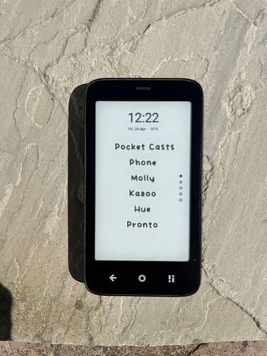

(1) Showing the effects on the Home screen. I use inkOS – a text-based launcher, so mostly white bg and light text.

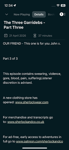

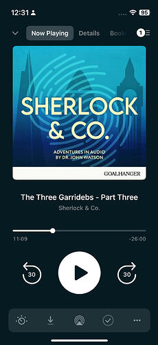

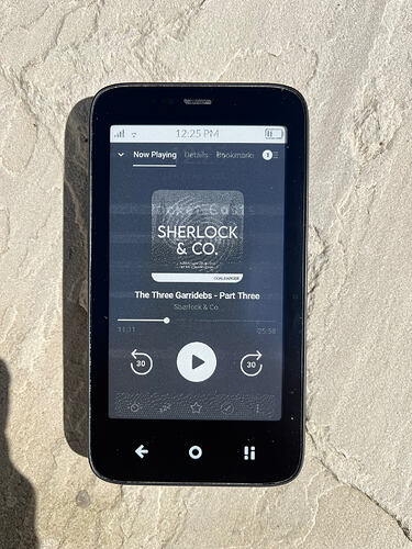

(2) Pocket Casts – a cross-platform app that uses a dark theme. See the Now Playing screen and Episode detail screen. iPhone shows how it should look. Compare the images for the deterioration of the MK in the sunlight.
(3) Kazoo. Another cross-platform app with a dark theme.
This degradation is only 7 mins in the sun (12:22pm - 12:29pm) at 17ºC.
