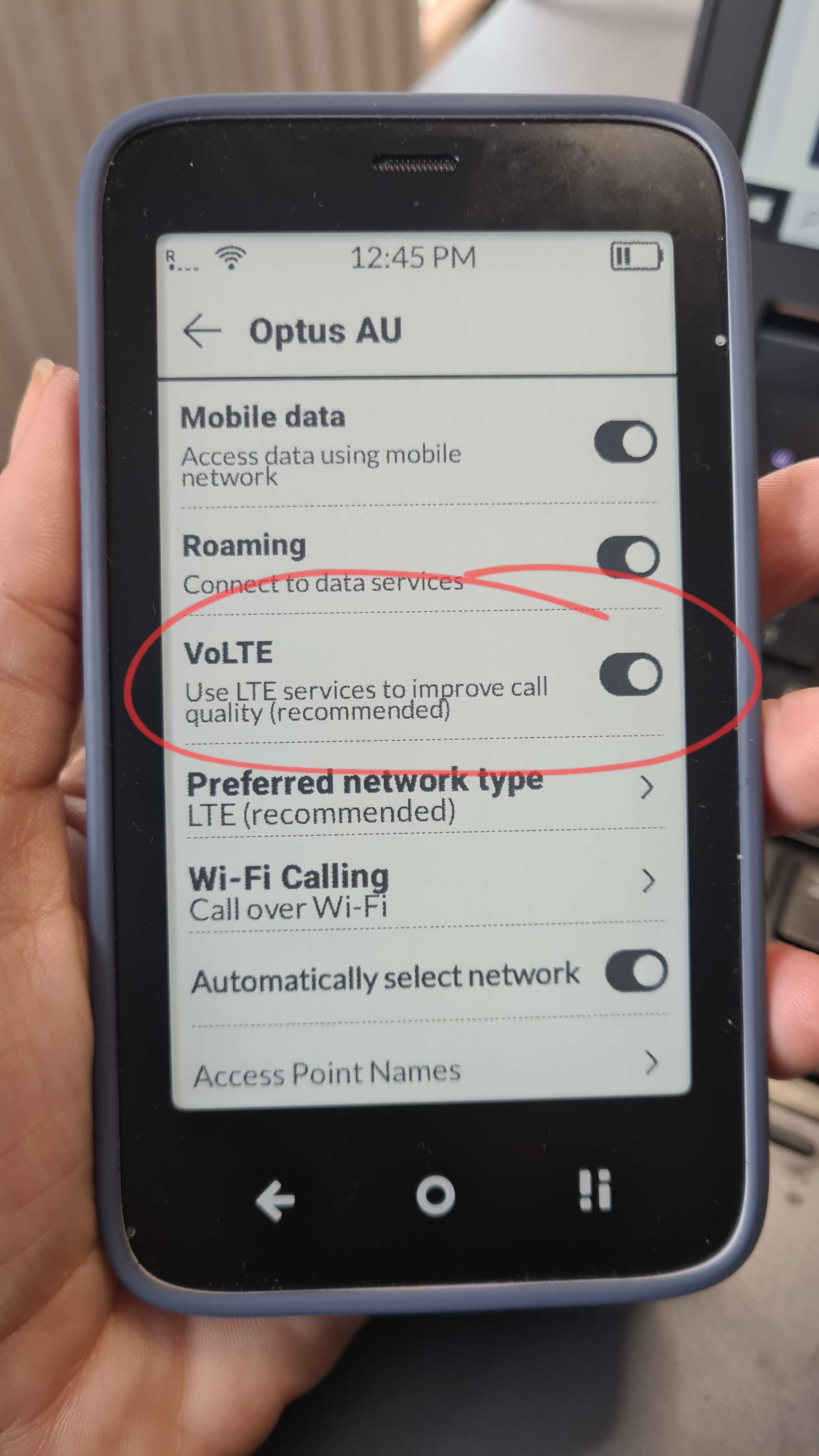

@bidinou What you’re seeing is actually quite common and usually comes down to how voice calls are handled on the network. Even though your phone shows LTE (4G) with full signal, the call may still be routed through 3G depending on the carrier and phone configuration.
Do you have VoLTE enable on your phone?
To put is simply, LTE was originally designed only for data, not voice. To make voice calls over LTE, carriers use a technology called VoLTE (Voice over LTE). So, you need to enable VoLTE for this to work. If VoLTE is not enabled or not supported, the network performs something called Circuit-Switched Fallback (CSFB):
Hi ! Thanks for your reply ! Yep, I understand that. VoLTE is definitely both enabled on the phone and supported by the network…
I think VoLTE worked with my Nokia/HMD dumbphone… Hmm… How can I diagnose this ?
Edit : I heard this could potentially be disabled by the provider, depending on the phone model etc. ?
Apparently, my provider, Orange (the most important in France) is very restrictive regarding VoLTE compatiblity.
Cf. Appel et SMS Wi-Fi - Réseaux Orange ← list of compatible phones.
I have no idea what can be done. Maybe the deal has to be made directly between Mudita and Orange ?
Otherwise it means my phone will stop working in 9 months. I don’t really want to switch to other ISPs because I don’t want to support the other ones for ethical reasons :wink:
