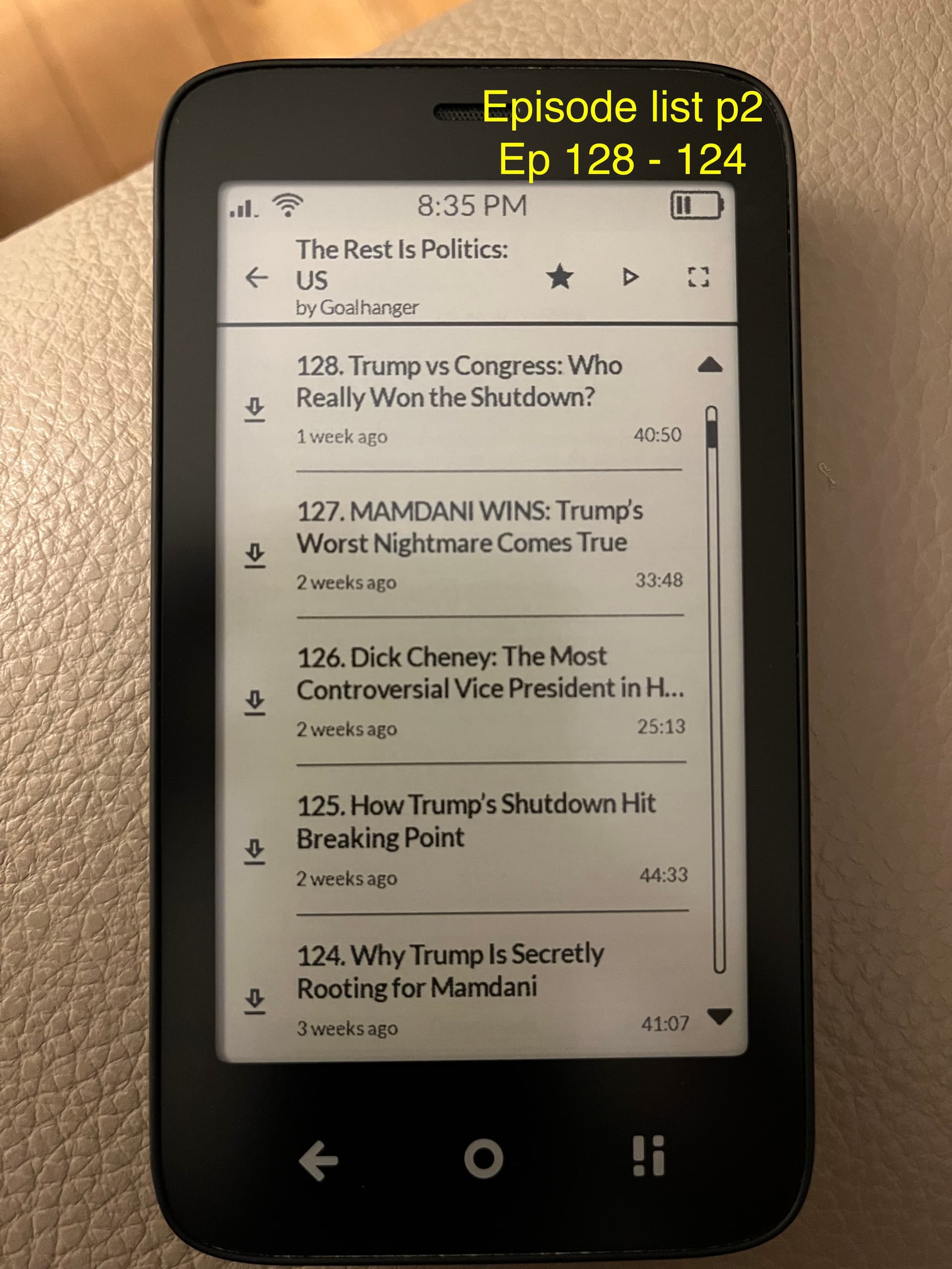

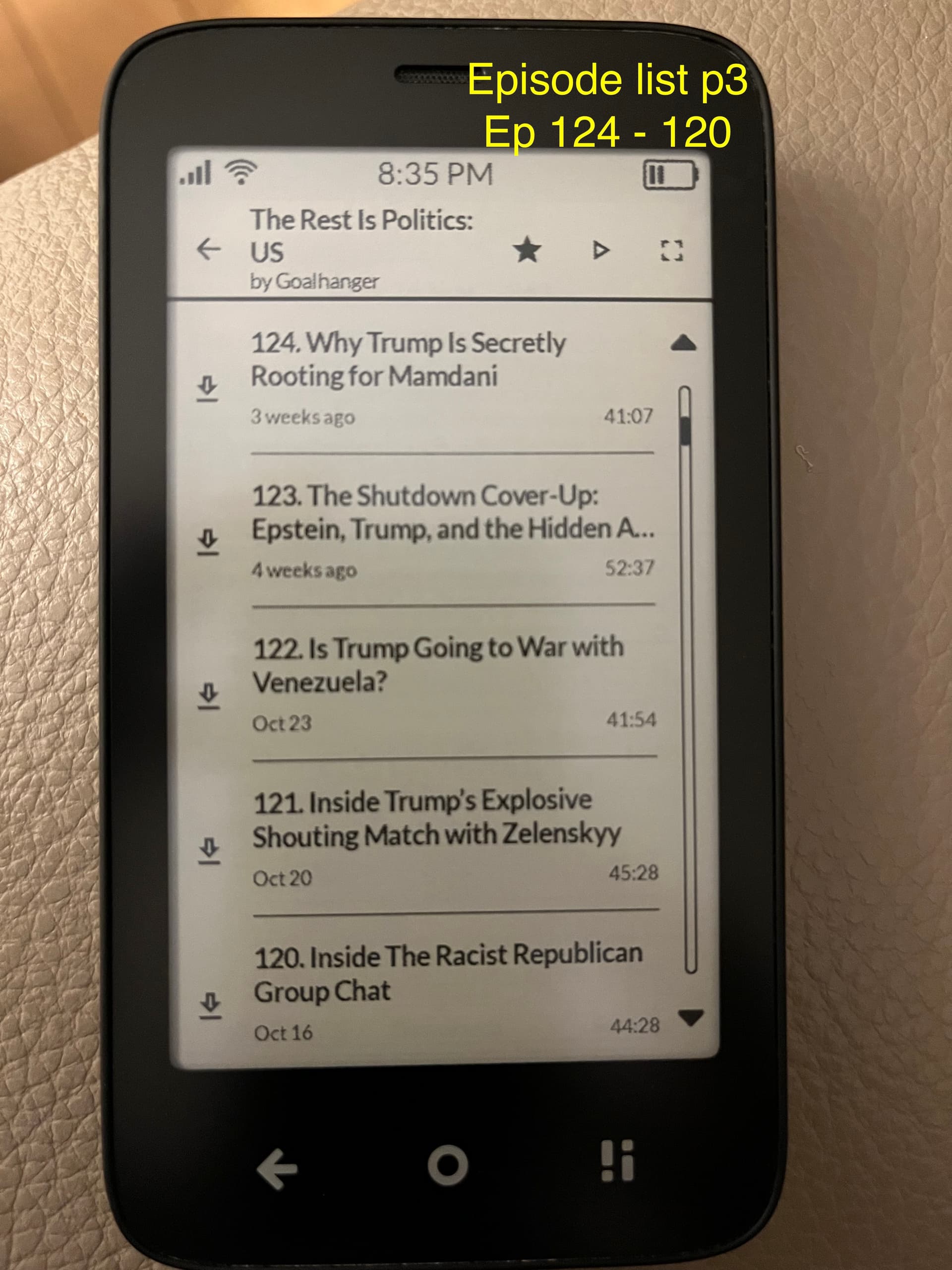

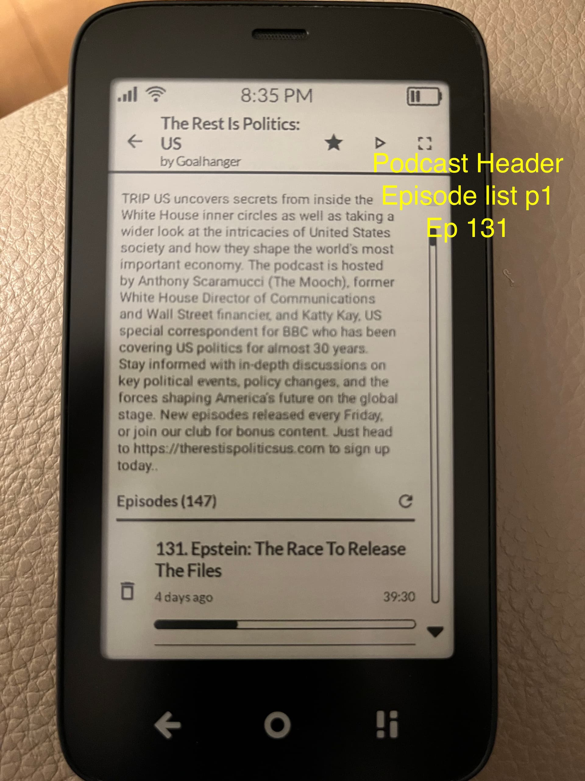

4. Paging through episodes is generally good. 5 episodes are listed, with four new ones with each page. But the very first swipe on the episode listing is problematic. Depending on the length of the podcast description, only one or two episodes might be displayed. Paging to the next page of episodes jumps several episodes. Paging back up only shows those initial few, so there are usually a few episodes from the first page that are never accessible. (See attached pics.)

  1. The paging vs scrolling is done in respect for E-ink and the way it redraws elements. If the icons and such can remain in the same position on “scroll” than the e-ink refreshes less and is easier on your battery and has less ghosting. This particular paging is done by the MMD framework. The problem might be something rendering after lazy column is drawn. I’ll play with it some and see what I can do.

    • Fixes episode scroll issue
