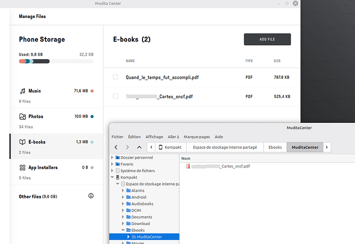

I tried again :
  • Using Mudita Center I’ve uploaded a PDF again. Everything is fine in Mudita Center
  • I close Mudita Center and unplug the phone : the new file is not visible in the e-reader app
  • I plug the phone again, and restart Mudita Center: I see both files in the Center, mais nothing with the file explorer:
  • I restarted the phone : the file is still not visible from the app, and has disappeared from Mudita Center as well.
Then I tried again with several files, including the one that disappeared previously. This time everything seems fine.
I assume there was a transfer problem which made Mudita Center think the file is there whereas the phone has not really received it. This is strange since I tried several times before opening this topic.

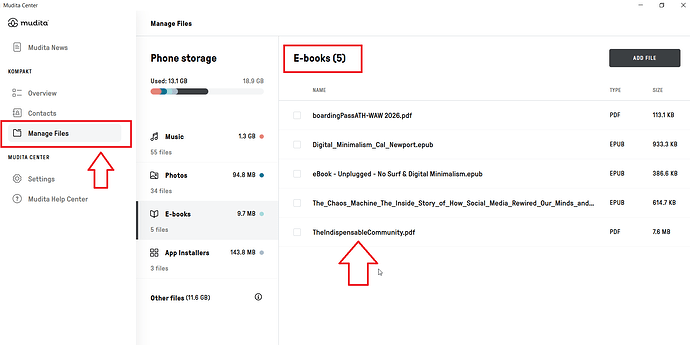

@BVS Since your last post was 8 months ago, I just want to make sure that you’ve updated your Mudita Center application. The current version is 4.0.0 and uploading ebooks (ePUB/PDF) looks like this.
Can you please let us know if this is how your uploading your ebooks?
