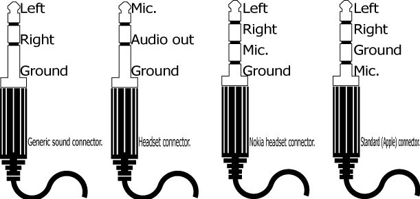

Not sure if this might have anything to do with the problem:

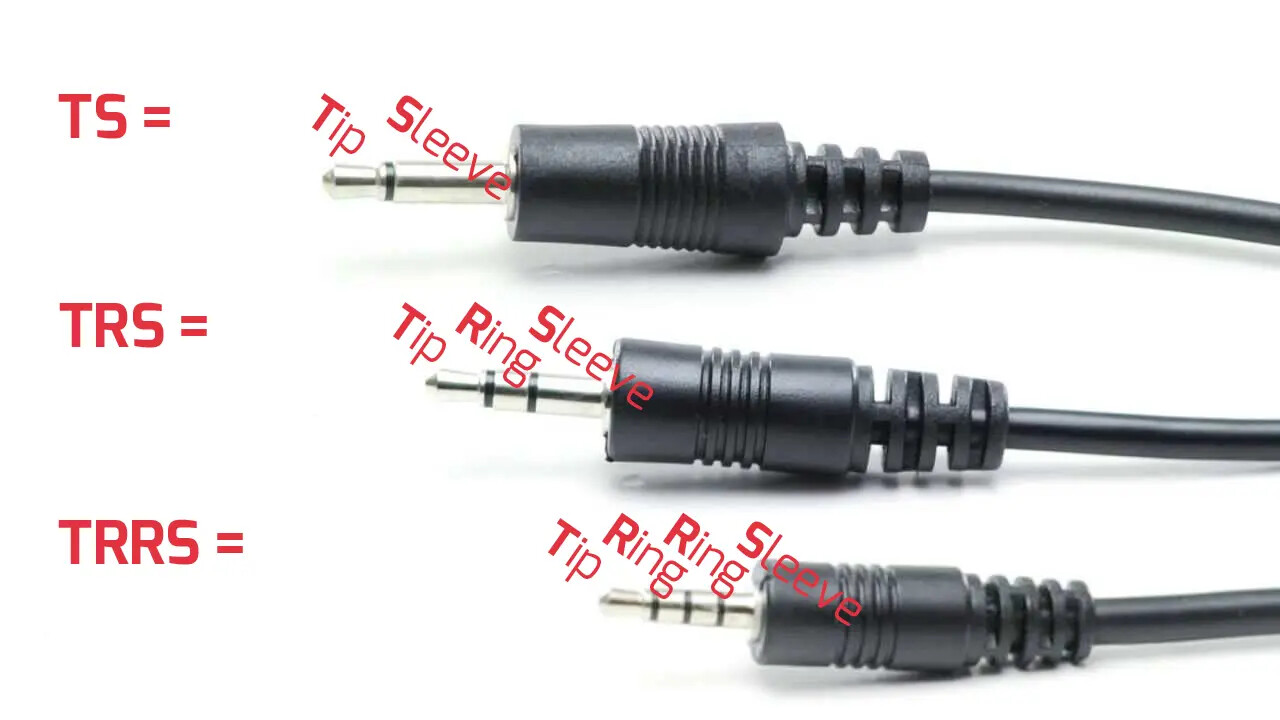

In general smartphone have a TRRS connection, or tip ring ring sleeve connection. See this picture:
Your earbuds might have a TRS connection, meaning you need an adapter. Though I can’t confirm, I suspect your connection does not match the connection of the phone, thus leading to noise.
nope. not the case.

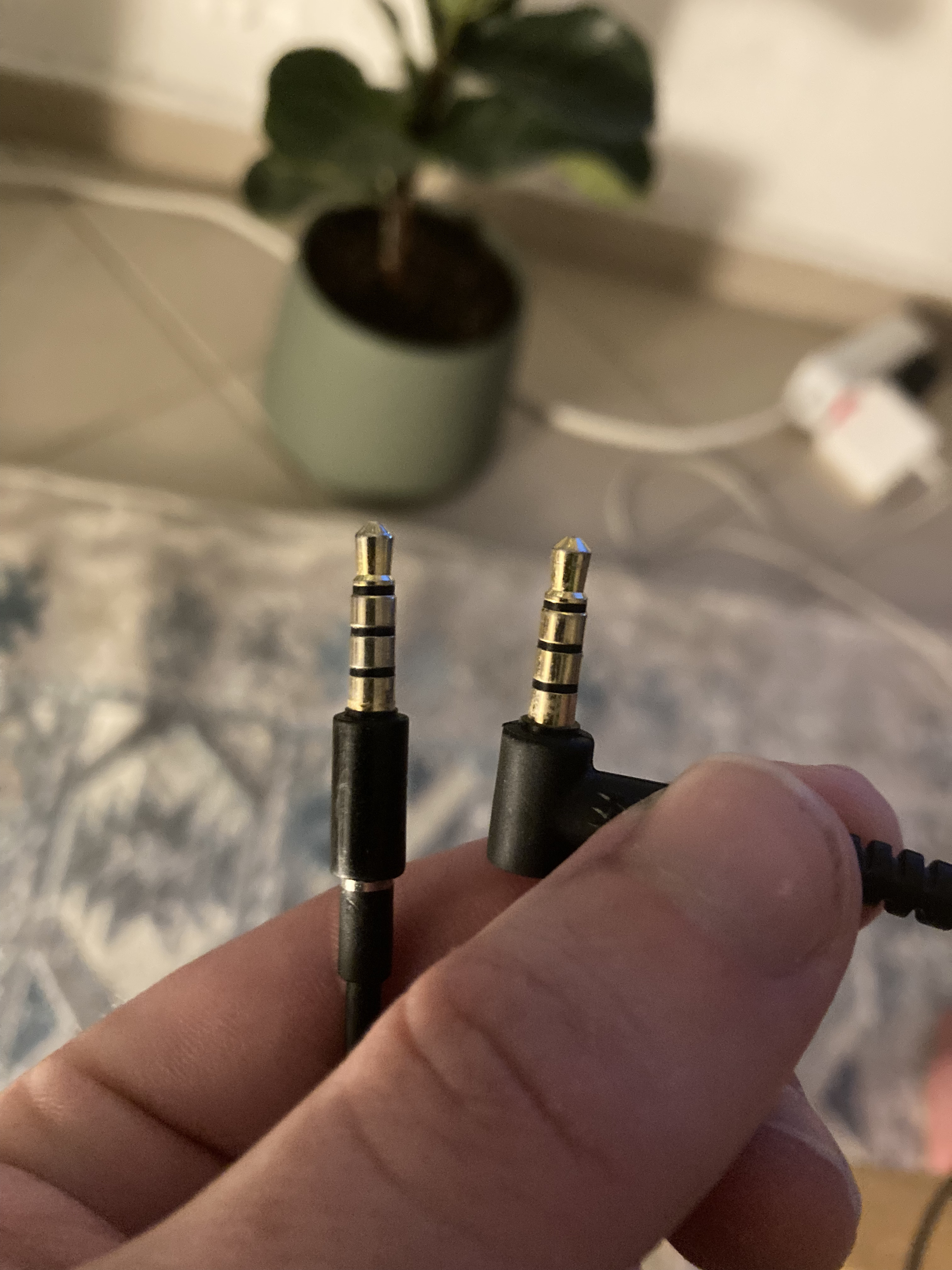

the jacks from both, Marshall and Sennheiser, are identical. here is a picture – you can try to guess which is which :wink:
Marshall ones are on the right :wink:
I am looking into using Mode EQs with this phone, but we’ll see how that goes :slight_smile:
well yeah, but you can tell just because I didn’t hide cable part))
Well, yes. In terms of connection pins - they are the same :wink: If this is your point.
