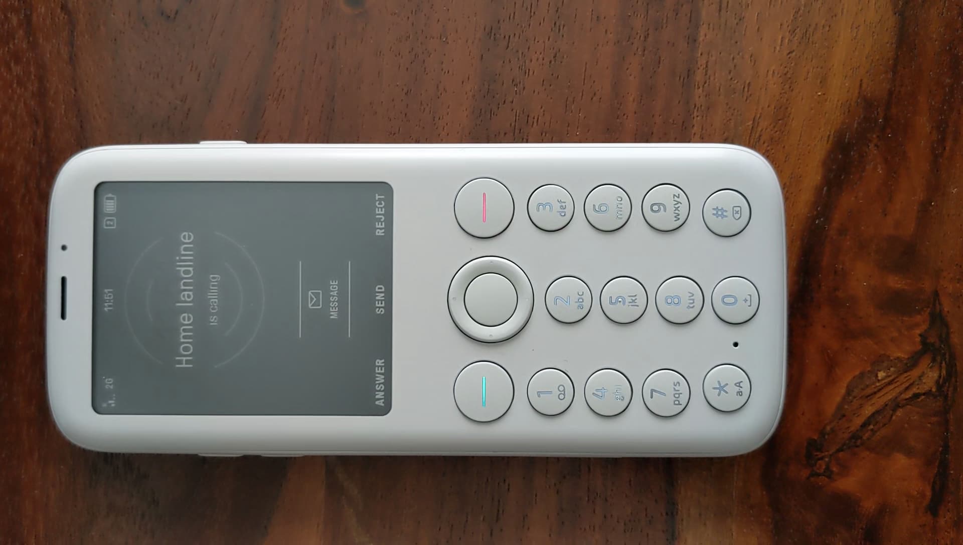

I started using Mudita Pure for the last 10 days. My observation is that for the voice calls, I see “2G” (GSM) on the display next to signal strength indicator during the entire call. Once the voice call is over, it shows “LTE” (“2G” not displayed after the call) for one second and then nothing shows next to the signal indicator.
Is Mudita Pure use only “GSM” for calls? In that case what is “LTE” for? No voice over LTE support on this device?

@urszula, I’m sharing video snapshots of one of the sample the voice call with Mudita Pure. I uploaded the snapshots as video can’t be uploaded. It switches to 2G while on voice call and at the end of the call, LTE appears for a second and vanishes. I observed this for every voice call, irrespective of my location when calling (I mean home/work/market).
