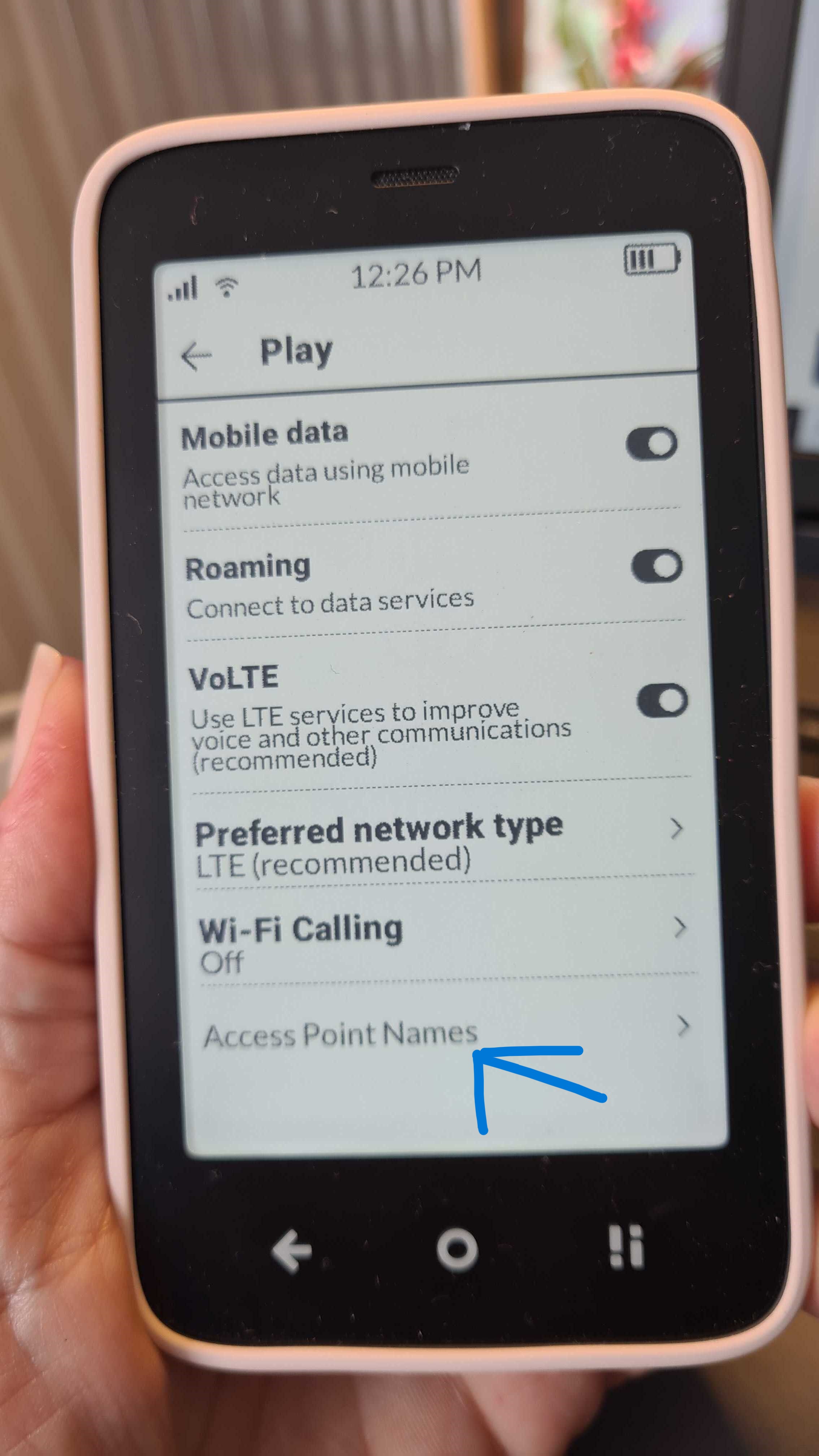

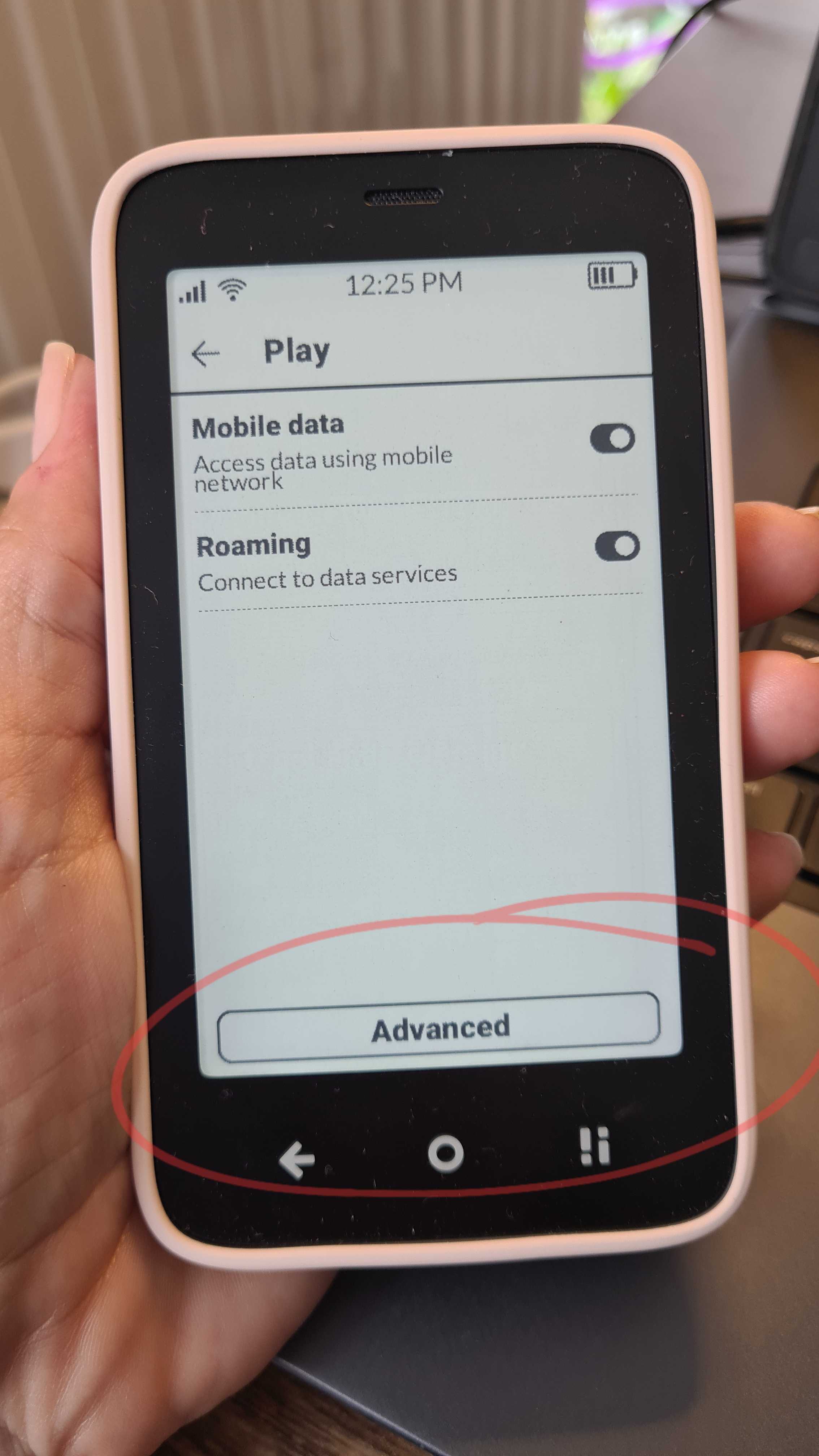

@robmfr When you go into Network & Internet (in the settings) Click on your network provider & then click on ADVANCED.
Then you’ll be taken to this screen, where you should be able to input the APN Settings
When I get to this point I cannot edit the date on the existing APNs nor do I see how to create a new one.
