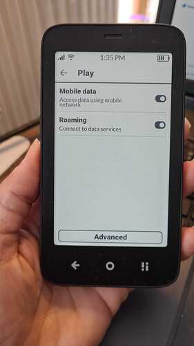

Do you have data enabled on Mudita Kompakt?
I do have data and roaming enabled but the data is just too slow to load I guess. It worked on my iPhone fine so I’m not sure if there is another setting I may have wrong. I haven’t changed anything.

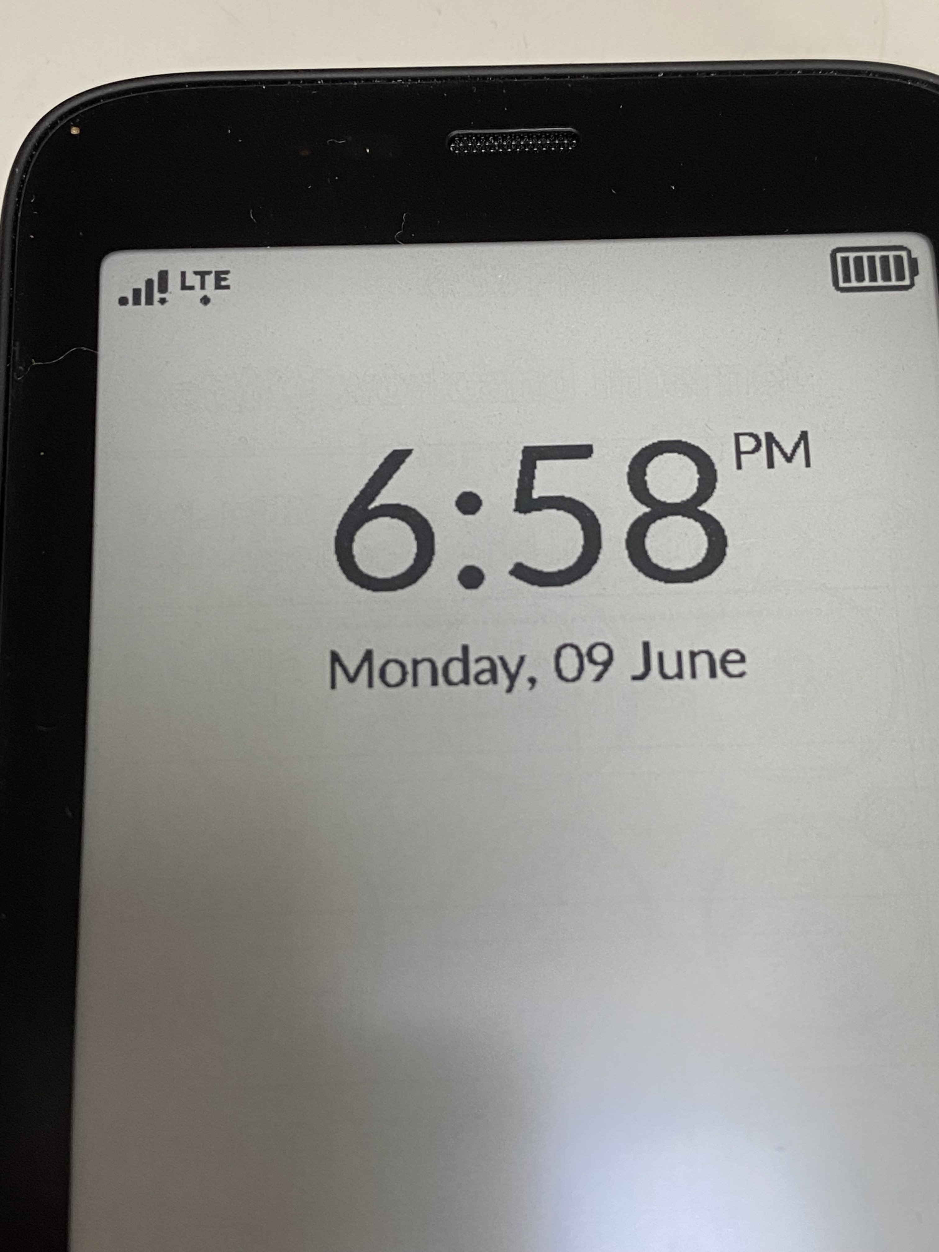

Do you know what it means when your last service bar before the LTE is an exclamation point?

US mobile sim behaves the same. Text is fine, call works but I am very quiet to the other person. No data and have the exclamation point in my service bars.
@tkbunch Can you send a picture, please?
[quote=“anon80904485, post:1, topic:8209, full:true”]
Here is the exclamation point at the end of the bars this is for both pure talk and us mobile.
@tkbunch Thank you so much. I’ve asked my team about this & I’m waiting for a reply.
