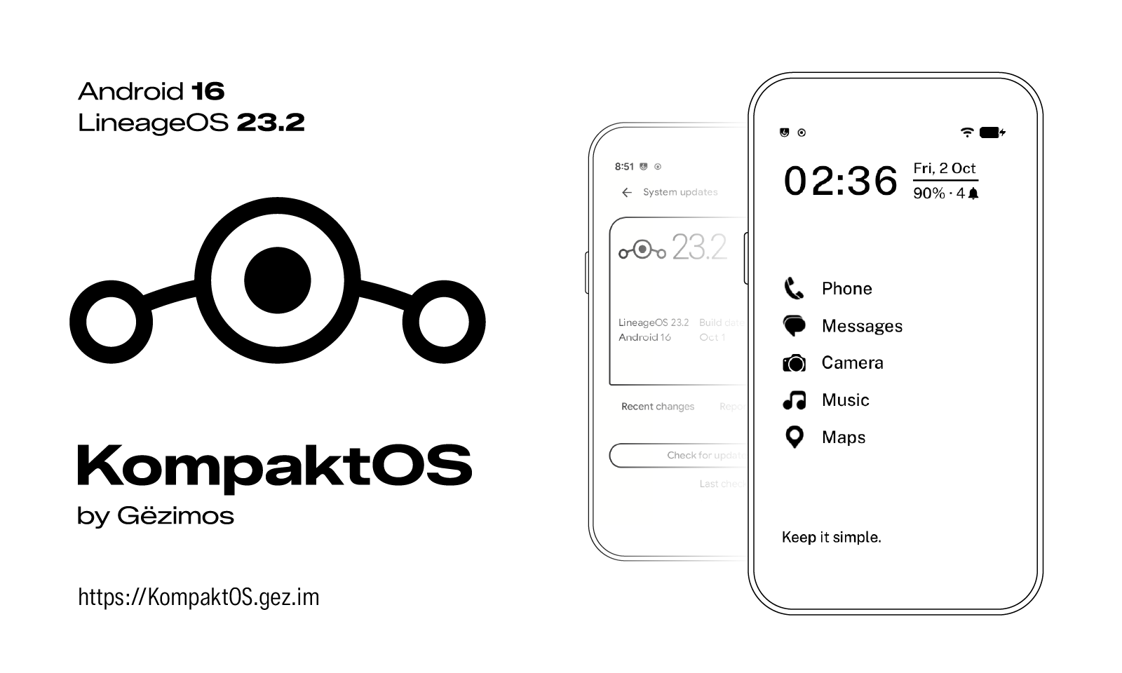

Unofficial LineageOS 23.2 - Android 16 for Kompakt
Documentation & Guide For Installation
We’ll refer to this as KompaktOS as Unofficial LineageOS 23.2 - Android 16 for Kompakt is a mouthful.
This ROM has been customized to work for E-ink devices and for this size/resolution in particular. This means that Settings and all default apps have been customized to be black and white.
It is a full ROM running it’s own LineageOS recovery which you’ll have to install first before installing the Rom. Our custom Kernel, Vendor and Recovery open up some features and fix some others. Most imprtantly makes updating this ROM seamless with ADB side-load, or even with OTA updates.
