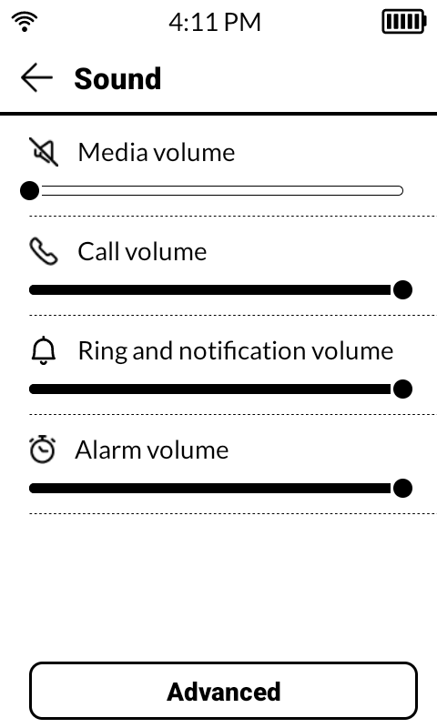

I have an impression there’s some other volume control in charge, not just the one you set when on a call in a regular way. It appears each time after setting call volume and has speaker icon like it was multimedia volume. I’ll keep testing tomorrow because I could get to hear the other party poorly as well as loud enough in speakerphone mode.
I just tested setting Media volume to minimum, and it had no effect on the speakerphone volume, which I now can confirm is affected by Call volume but NOT by Media volume.
I also ran yet another test with Kompakt Phone app in speakerphone mode vs. a deGoogled Pixel 6 in speakerphone mode, with an FM radio speaker the same distance way from the source cellphone in both situations. The Pixel 6 yet again proved to be much louder in speakerphone mode than did the Kompakt in speakerphone mode.
Update: Here is a screenshot of what I discussed: Media volume at minimum and Call volume at maximum led to no difference in the Phone app’s speakerphone-mode volume when compared to Media volume at maximum and Call volume at maximum.
I ran that Media volume test (min and max) because of what @buiosu posted earlier:

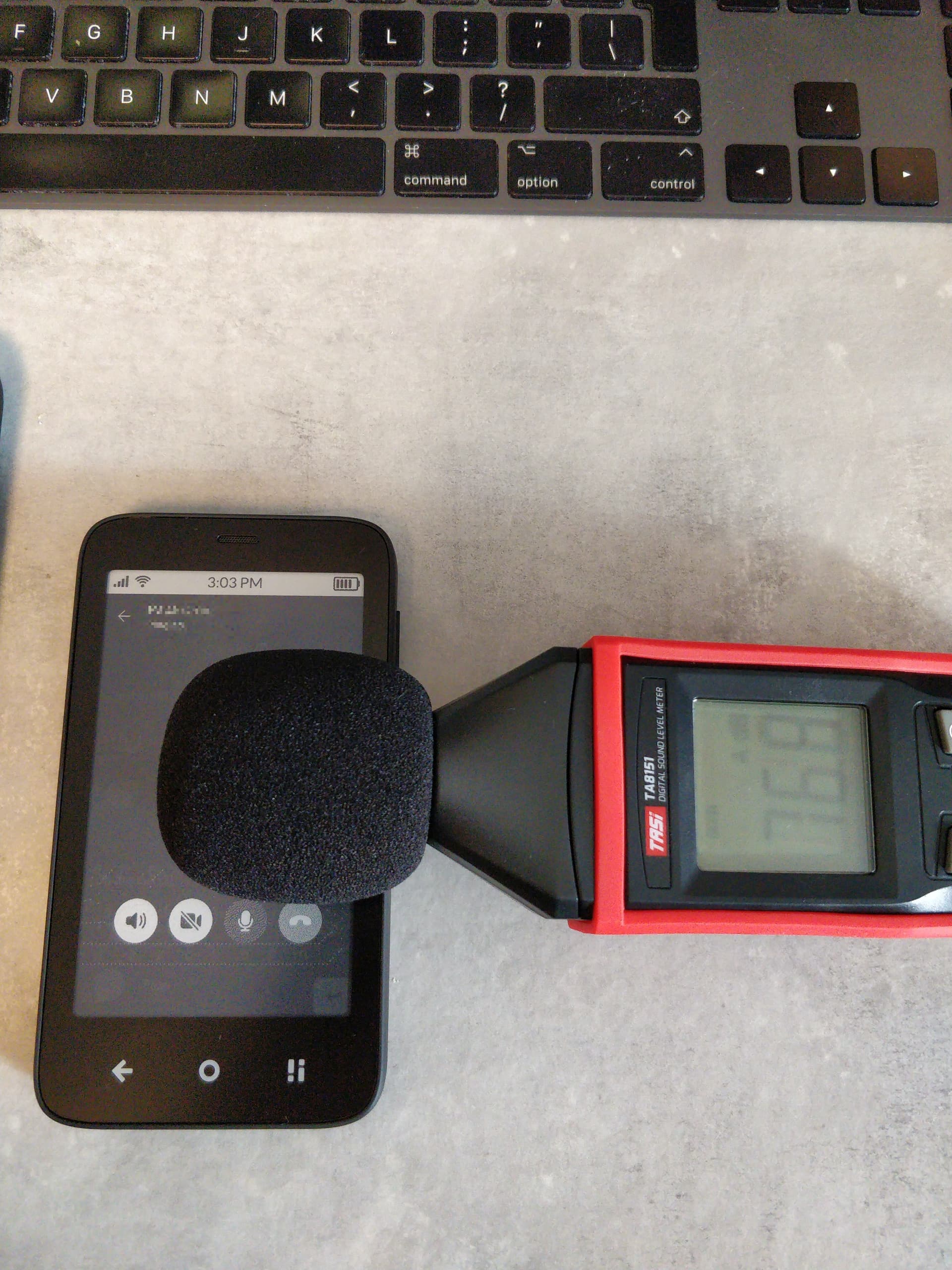

Since I have a SPL meter laying around, I ran a quick test to measure the loudness of the ringing sound from Signal/Molly…
This is by no means a professional test as we would probably need to play the exact same sound under the same conditions on both devices, and compare the resulting sound curves.
However, despite being inaccurate at best, it looks like the Mudita’s loudphone mode speakerphone is actually louder than the iPhone 16 Pro Max (76.9 dB vs 60.5 dB)
For consistency, I placed the mic in the middle of the screen since both the iPhone and the mudita are likely using both loudspeakers to produce a stereo sound.
Again, this is a lazy quick test… so take this with a pinch of salt :wink:
