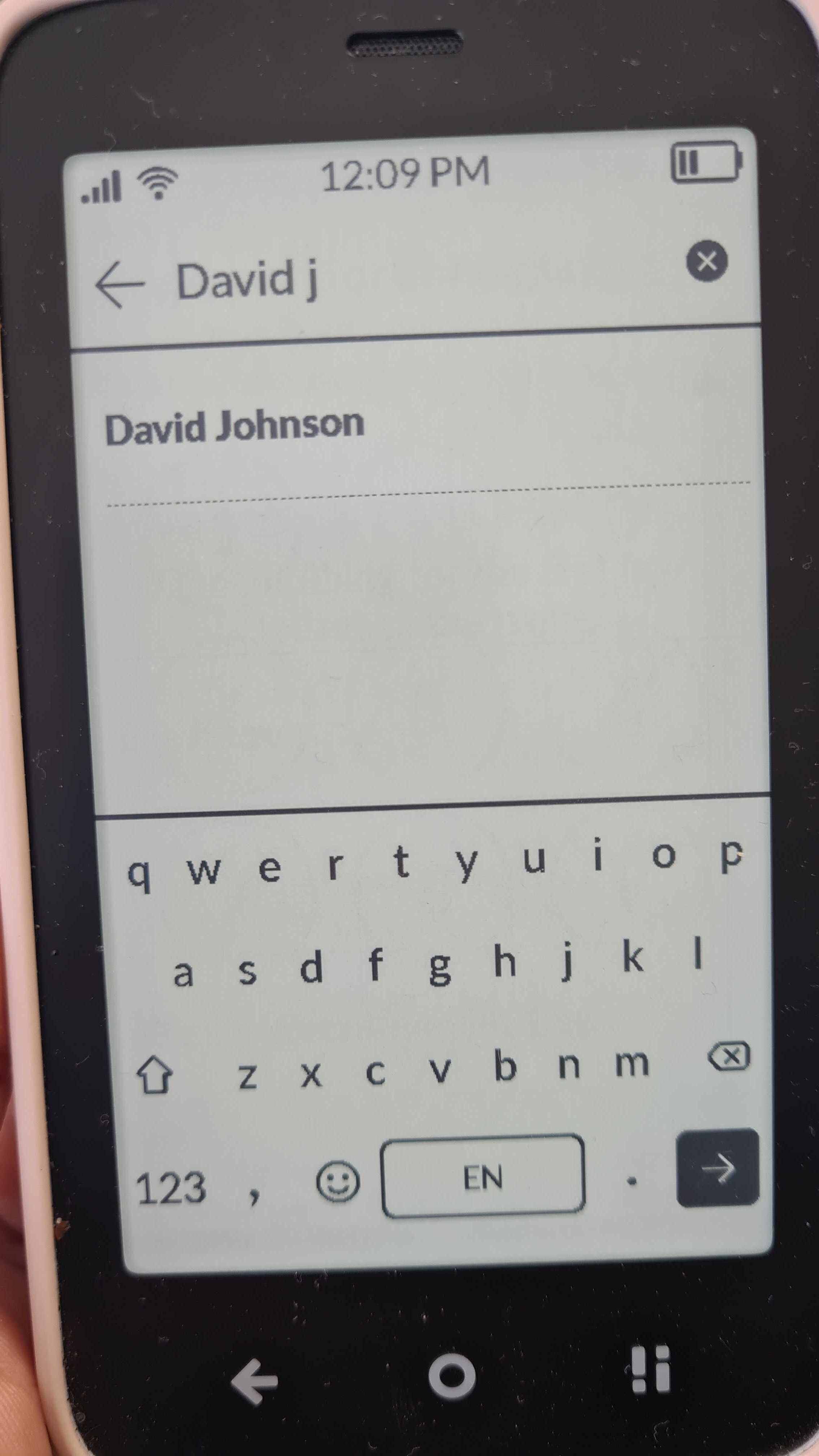

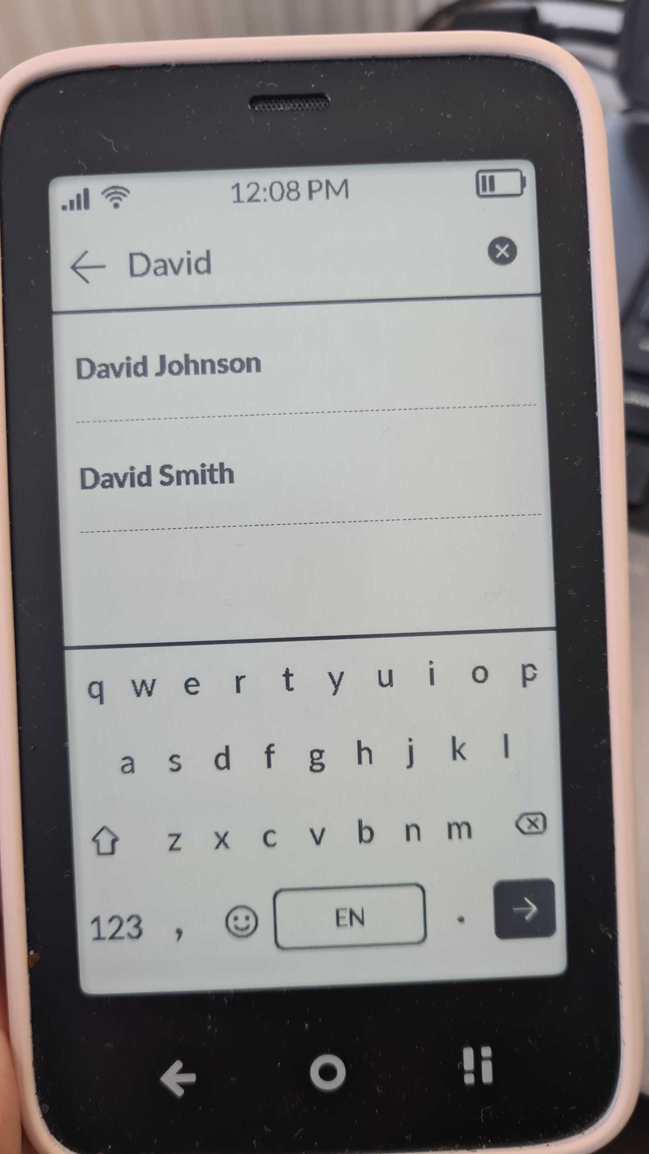

Thanks for the replies, all. My problem was that searching for contacts didn’t work at all (clicking on the search icon would cause the app to crash). It is working fine now: as far as I can tell, all I had to do was update to Mudita OS K 1.2.0. I have now upgraded to 1.5.0, though I had to do so one version at a time.
Yes, as of now, it has to be done one update at a time, but our team is aware of this issue and they are looking into improvements.
