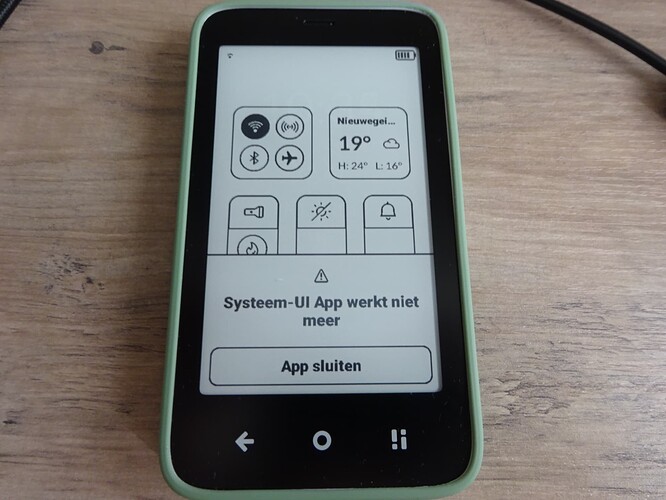

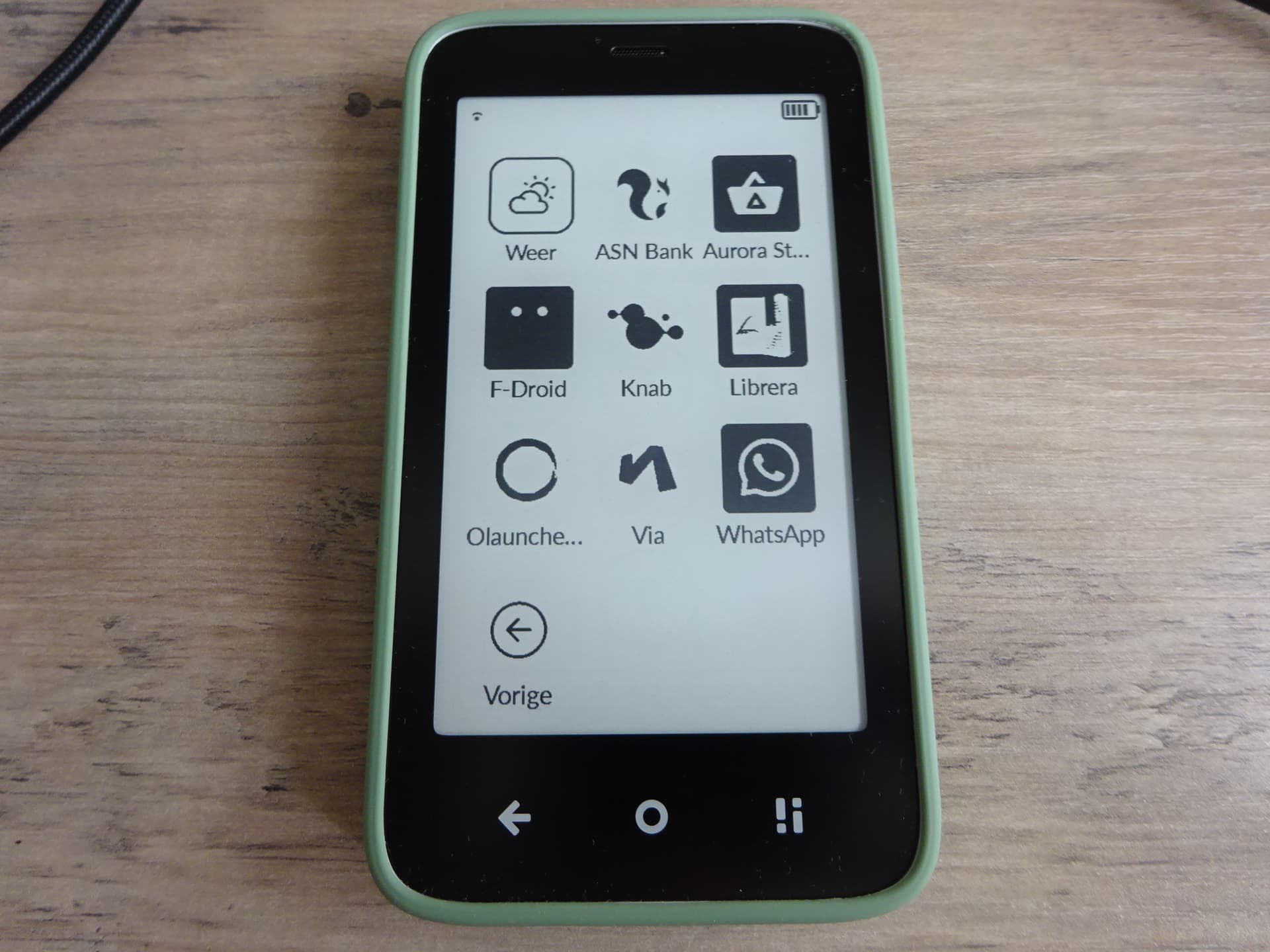

I tried to do a factory reset on my Mudita, but when it’s done I can open the phone with my fingerprint and passcode and all my apps are still there with all my info, wifi is working. So it didn’t do the reset… It just won’t go back to a fresh start. Deleting any apps one by one is also not possible, it refuses to delete anything when I try to delete sideloaded apps (with Aurora Store). And Whatsapp keeps crashing every day. Sometimes it’ll work for a few hours, then it crashes. I uploaded an epub last week, it was there for a few days, then it dissapeared into thin air. How? It wasn’t me. Something isn’t right. Someone else having these same issues?

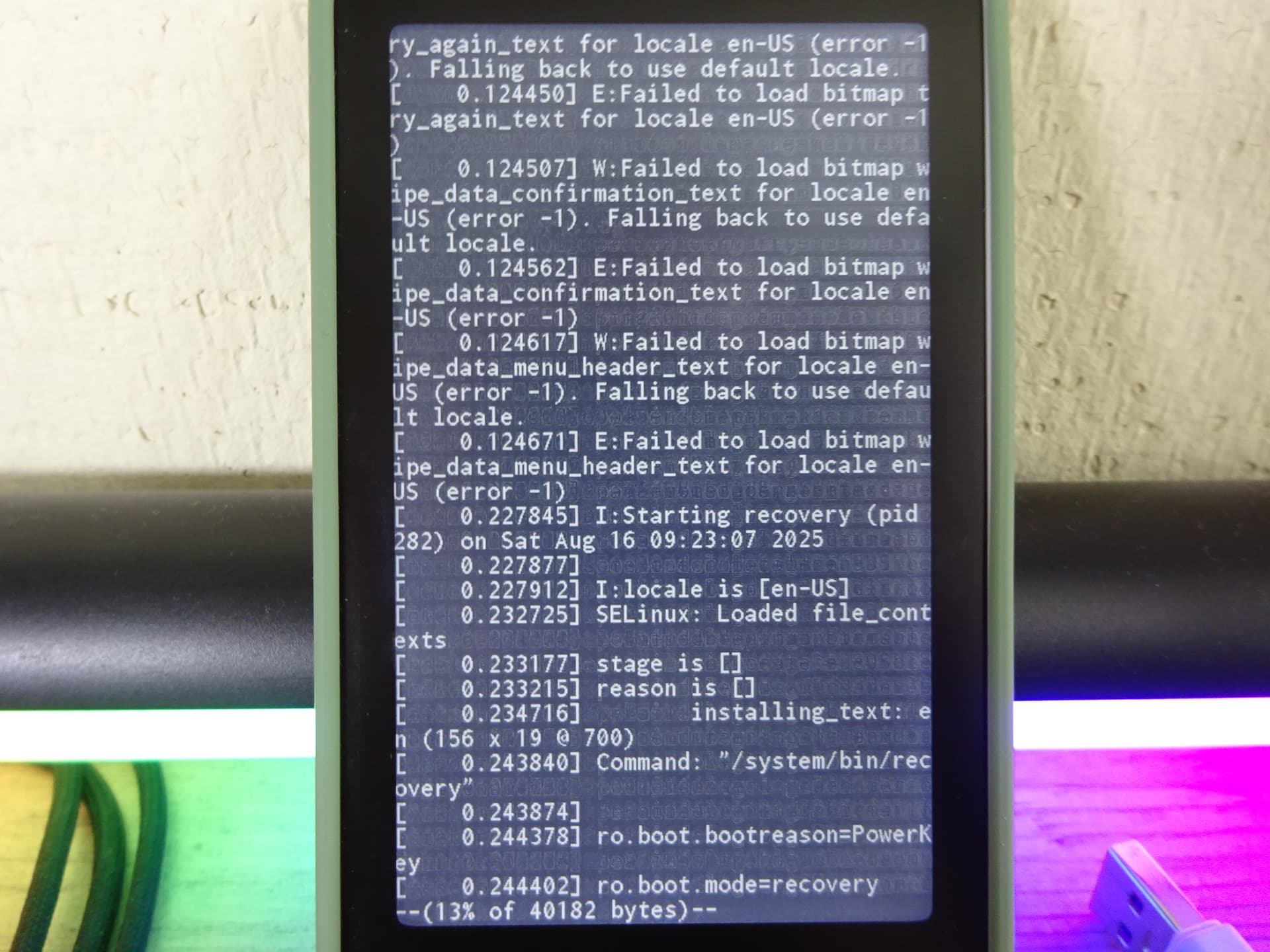

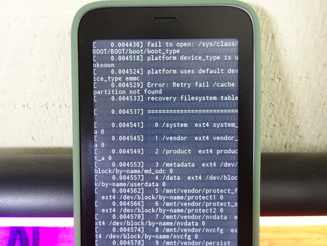

Hi Urszula, I’m back from holiday and thought I’ll give it a try… I have a few sideloaded apps that I tried to delete via webadb. Put in the command lines ‘pm uninstall’ and the name of the app. Looked fine, webadb confirmed the removal and I saw them disappear from the screen of the Mudita. I disconnected the phone properly from my laptop, restarted it and… all the deleted apps are still there! Tried to to a factory reset, that failed. Tried to delete apps via Aurora or F-Droid, still nothing deleted. Than I tried the hard reset. That also gave an error: ‘mke2fs failed with status 1’. See the 3rd photo.

This sound like a partition error and not related to sideloaded apps, because they have no system access to cause something like this.

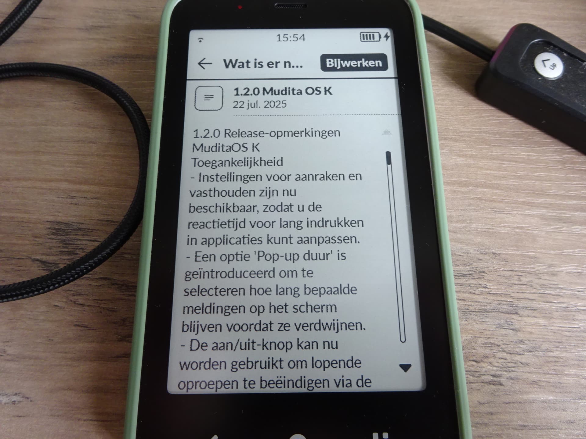

Are you in 1.2.0 and was this issue happening in 1.1.1 version of Mudita OS K?

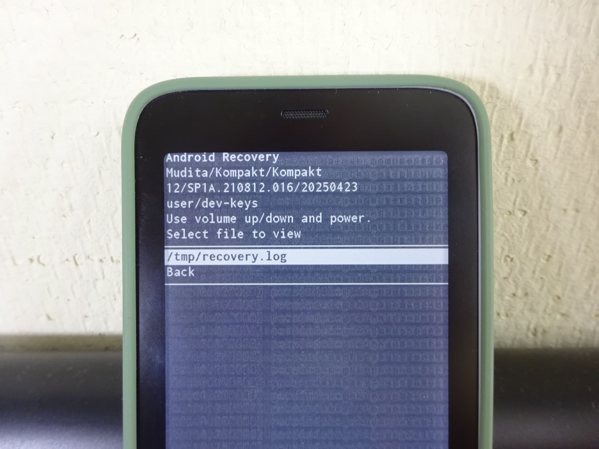

When you go to view recovery logs what does it say? That should help you find the issue
Hi @gezimos
Thank you for the fast response :slight_smile:
The phone is on 1.1.1
There are definitely some fail messages in the log. Is there something specific you want me to look up?
From what I can understand your Recovery is corrupted it’s lacking some files, and on the 3rd image it says “cache partition not found”.
So imo this might have been an issue when it was originally flashed before it was sent to you, or a failed update.
Are you able to update to 1.2.0 using the updater app in Kompakt? That normally should also update the recovery and avoid these issues, but seeing that the cache partition is missing the problem is deeper.
And you should contact the support and give them the logs you provided and they will be able to pinpoint the issue and offer you a solution.

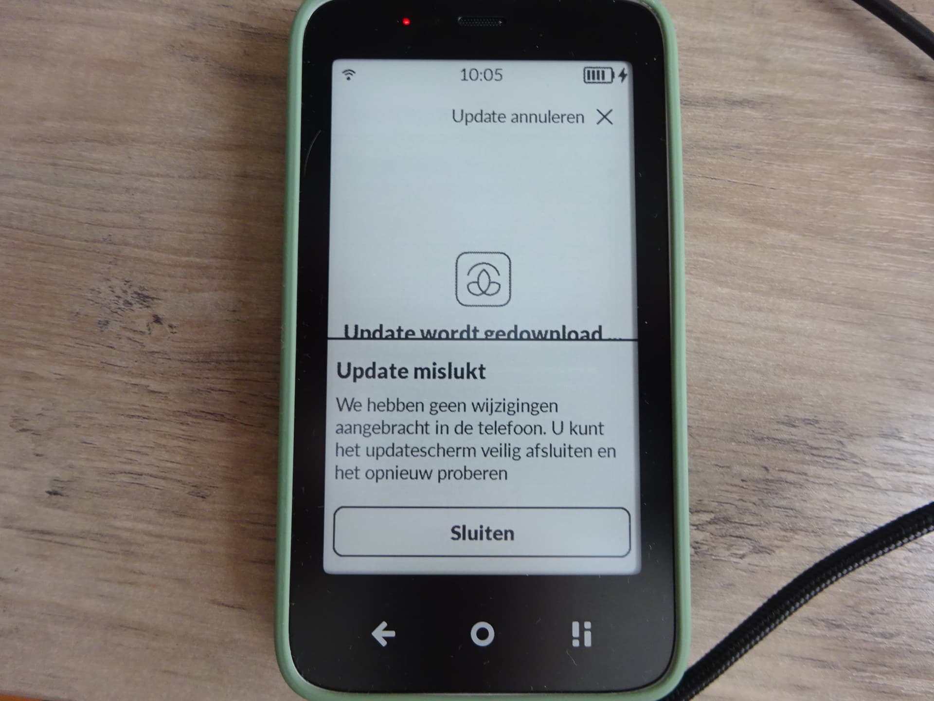

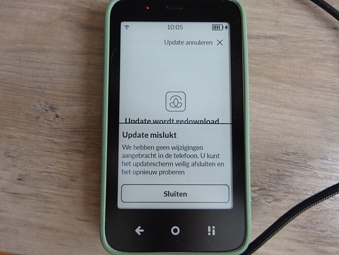

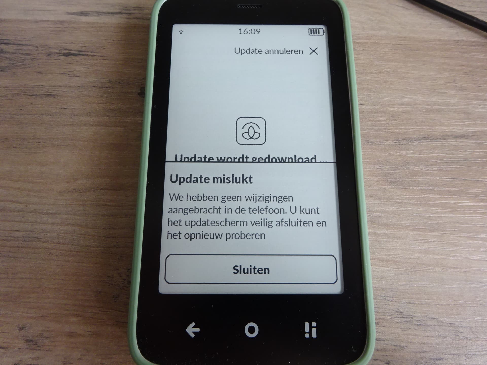

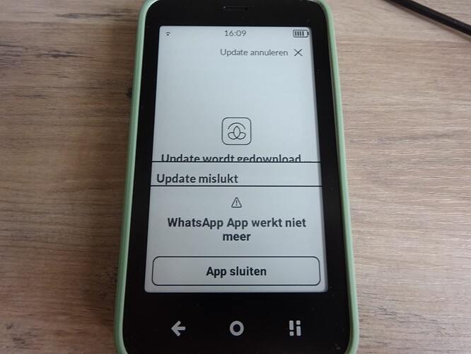

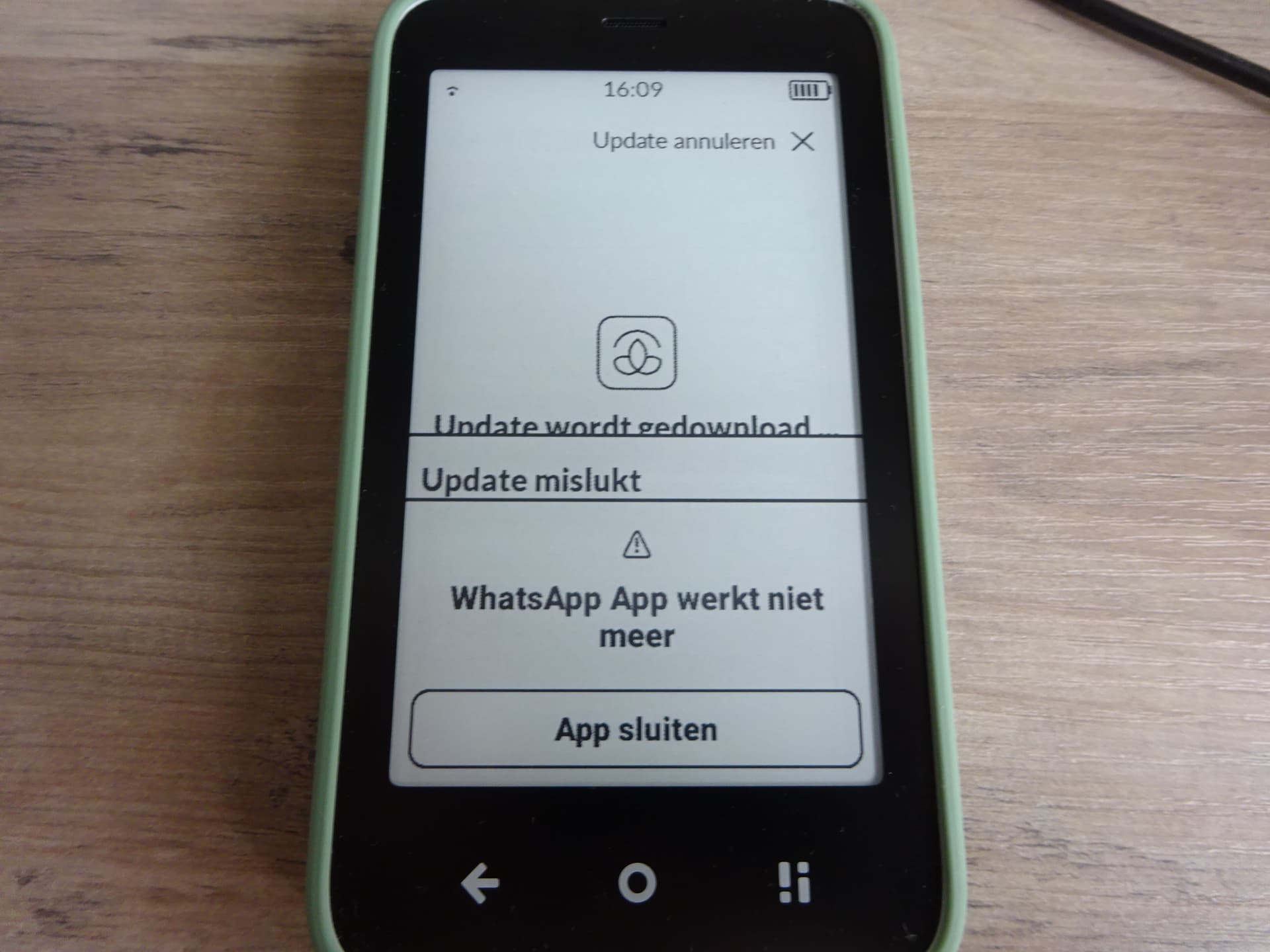

Tried updating again to 12.0 but now it says Whatsapp is not working anymore (who cares) and updating failed again.
Uff, I’m out of ideas. The last think I’m thinking is go to settings → manage apps and click on each of the sideloaded apps and “force stop” each of them and then try to update again.
This might not work because it seems your device has “write” issues. It can read but it can’t write in the partitions. Which is why I assume it’s not allowing you to factory reset.
The “cache” parition is corrupted and that’s why is bringing back the apps even after you delete them :confused:
Technically this could be resolved by flashing the recovery and the android image of Kompakt OS, but Mudita is not providing those publicly.
