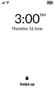

It seems to me that somehow the power button on the side of each of your Kompakt cellphones is getting pushed sufficiently to turn on the “Swipe up” screen, which is touch-sensitive.
