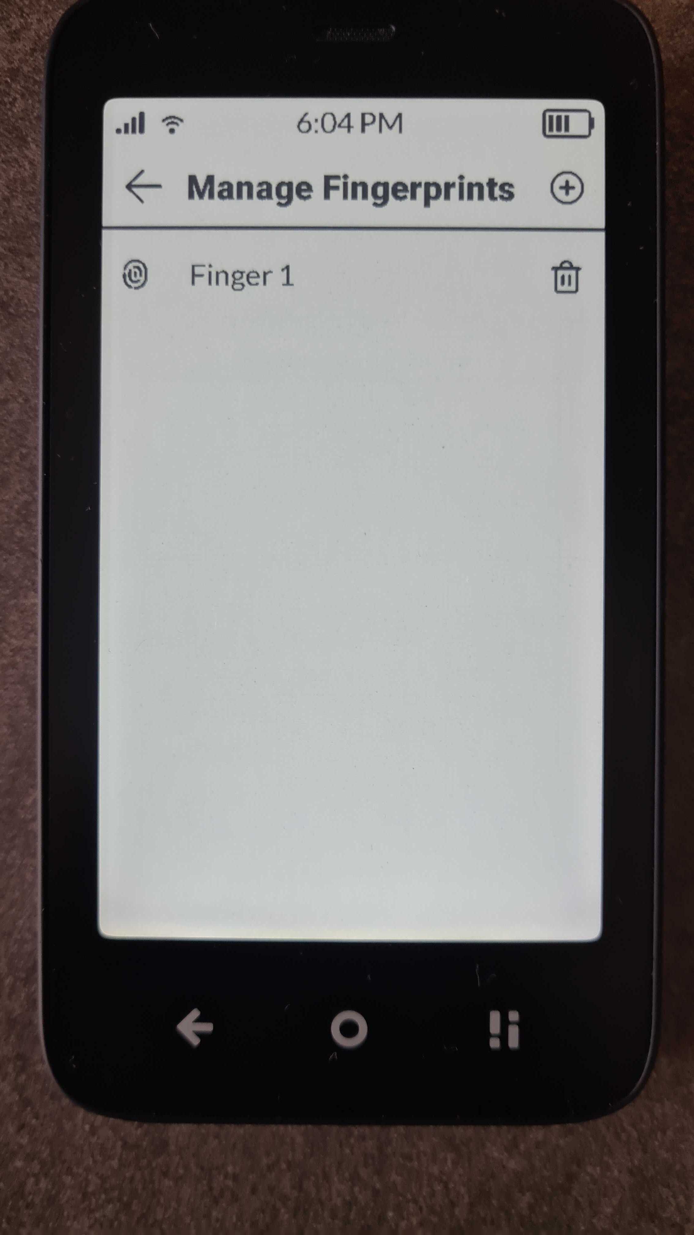

  • Tap Settings > Security > Manage Fingerprints > Trashcan adjacent to Finger 1.

  • Workaround #1 has the drawback of forcing you to use PIN entry when unlocking the Kompakt, unless you are okay with having no security PIN on your Kompakt.

@kirkmahoneyphd Have you tried deleting the fingerprint and then adding it again.
I have to admit, I’m trying to recreate your problem, but I just can’t.
@urszula: Before you posted this, I noticed that the original hypersensitivity in a pocket (same clothes) had decreased over subsequent days. I just tried deleting Finger 1 and re-adding it, and the sensor definitely is not giving me the hypersensitivity that I originally reported.

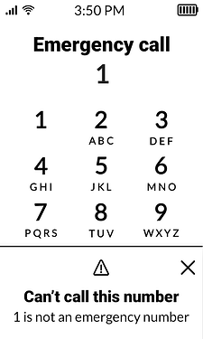

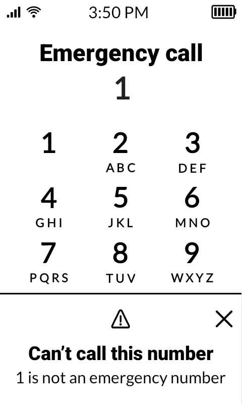

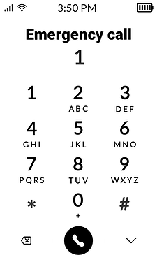

  • Go to Settings > Safety and Emergency > Emergency Call, change the Call in case of emergency default value (911 in my country) to anything else, and tap [Save].
Assuming for this example that you saved “1” as your new Call in case of emergency value, here is what you will get when the [Emergency] pushbutton accidentally gets tapped (e.g., through one’s pocket):
If the black disk containing the phone receiver at the bottom of that screen subsequently gets accidentally tapped, then you will get this:
Of course, this workaround is not ideal, as it means that nobody can use your locked Kompakt in an emergency to call your country’s emergency-services number. But, at least it protects fingerprint-unlock fans from accidentally pocket-dialing their emergency-services number until Mudita can address the “twitchiness” of the fingerprint sensor.
