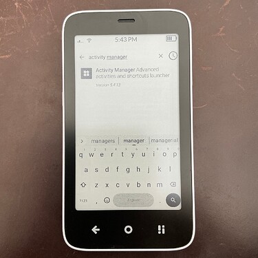

Step 2: Install Activity Manager
Open F-Droid, click the :mag: Search icon at bottom right, and search for Activity Manager. Then click the install button.

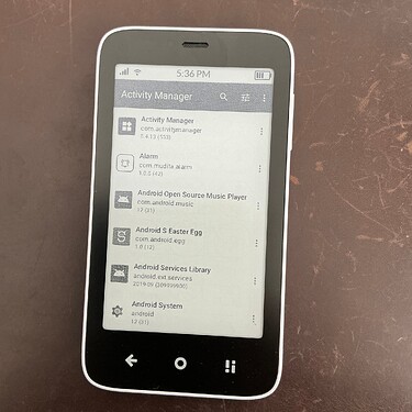

Step 3: Open Activity Manager
Go back to your Kompakt home screen, tap Apps, then open Activity Manager. You will see a list of all of the installed apps and their activities.

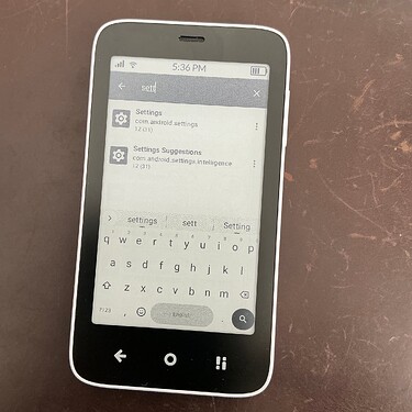

Step 4: Open Settings (com.android.settings)
You can type in the search box at the top to find this quickly. There will be an option called Settings [com.android.settings] - tap on it.

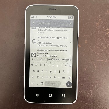

Step 5: Open Settings$NotificationAppListActivity App notifications
There is a long list to scroll through here. So I recommend you use the search bar at the top of the screen. I searched for “notification”. The one you are looking for does have a bell icon on the left to make it easier to identify. Tap on “Settings$NotificationAppListActivity App notifications”

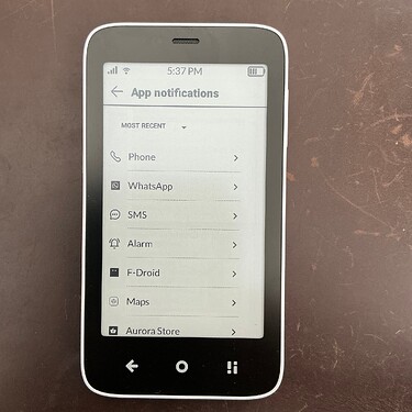

Step 6: Choose the app you want to change notification settings for

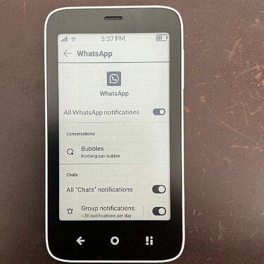

After tapping “Settings$NotificationAppListActivity”, the app notification settings will open. This is a standard Android menu which is normally hidden on the Mudita Kompakt. You’ll see a list of all of your installed apps. Tap on any app that you want to modify the notification settings. In this example, I’ll tap WhatsApp.

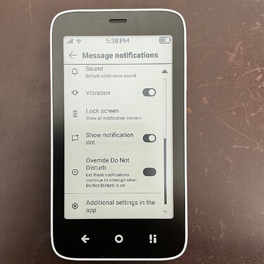

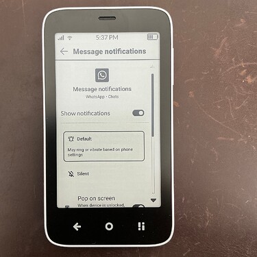

Step 7: Modify the notification settings
This is standard Android settings. You’re able to turn on and off notifications for the entire app, or just type by type (e.g. you in WhatsApp you can change settings for group chats separately to direct message notifications). Note that not all of these settings are supported by the Mudita Kompakt.
