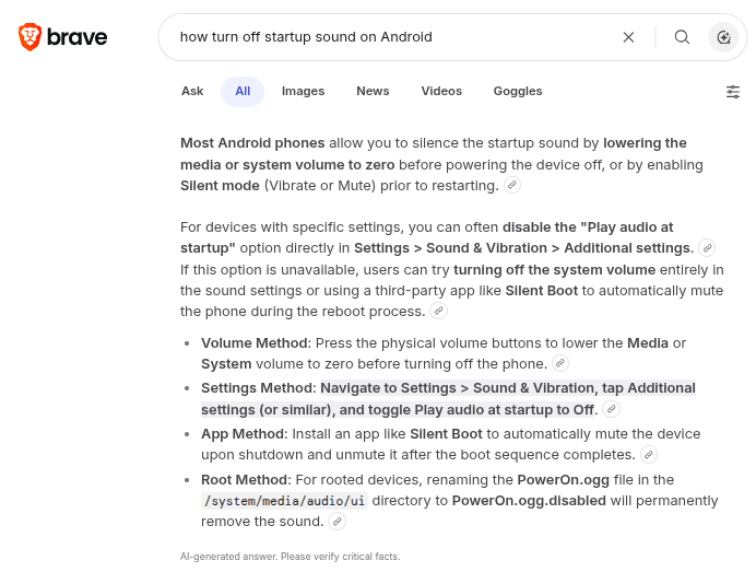

I had the same problem with a notification sound from the System-UI when starting the Kompakt and I could stop it following this instructions:
I eventually managed to fix it with the command adb shell settings put system notification_sound null. The unfortunate part is that now I cannot use the system notification sounds, which I liked a lot. I cannot find their file/mp3 either to still be able to use them. They do not show in the file folders.
