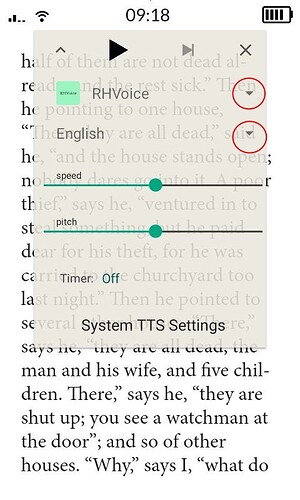

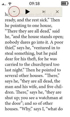

Sorry, you probably need to set the preferred speech engine and language within the app. Once you have opened a book and tapped in the middle of the page, tap on the little arrow to the left of the play button:
Then select RHVoice, followed by Hungarian, using the little triangles at the right edge of the settings page.
The first time you do this, you probably won’t see the speed, pitch, and other things on the page. It may look like the speech engine and language drop-downs are not there at all, but if you tap on that spot the settings should open up. After you save these, you may need to restart the app or your phone.
This is the setting that I sometimes need to re-set. I’m not sure why, but it seems to happen less now.

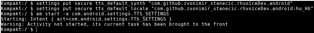

Do I need to enter this somewhere in the webADB interface once I’ve connected the phone?
Sorry, the commands I shared with you before, I figured out in a Linux terminal. I tested it with WebADB and the commands are a little bit different, and I tested this with the RHVoice APK linked above and the first Hungarian voice downloaded. I didn’t test it with an eBook reader app, but it did work with a RSS news app that I use.
Connect your Kompakt, and make sure your phone is unlocked while you put in the commands. Select the “Interactive shell” option.
Set the “Preferred engine” to RHVoice:
settings put secure tts_default_synth "com.github.zvonimir_stanecic.rhvoiceDev.android"
Set the language to Hungarian:
settings put secure tts_default_locale "com.github.zvonimir_stanecic.rhvoiceDev.android:hu_HU"
Then try opening the TTS settings to see if it worked:
(This should open the Text-to-speech output screen on your Kompakt.)
am start -a com.android.settings.TTS_SETTINGS
