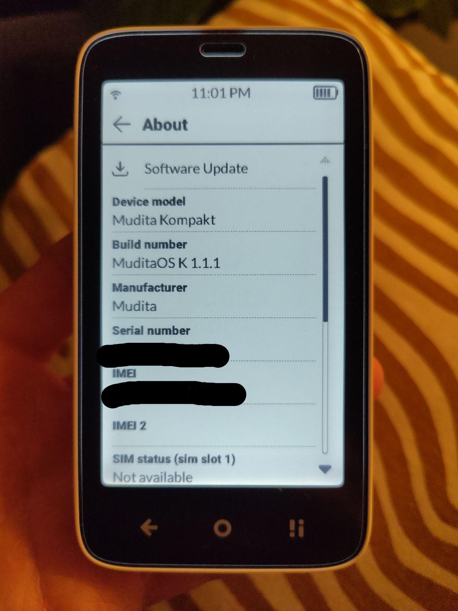

I did some further research, and I noticed that the IMEI 2 shows blank in settings (About section). Also there’s no EID, which is related to eSIM. Could be that it’s been hidden in OS K, but I find this quite suspicious - could be related to why SIM2 and eSIM don’t work.
Could you check if you have those visible?
i have imei on boths sim cards
Okay thanks for checking! This is getting interesting.
@urszula, should I submit a support ticket about this, or could you check this from the team? My About page looks like this - is it normal?
@anoniononioning Yes, Please submit a ticket for this. I’m not sure what’s happening in your case,
For an update, I got a response from customer service and it indeed seems that there is something wrong with my device. It’ll be a warranty case, so I recommend you to contact Mudita if you haven’t already done so @tobias1988 :pray:
I have the same problem that i cant add my second E Sim. I cant add it via QR-Code and my Carrier said that i need to give them the EID NR. of the device to add it. Idk if it is only my device, but it seems suspicious, that there is no EID number visible, because my carrier said, that this is mandatory for E-Sim to work. I think this is mostly the problem for the people who have this problem.

I also appear to be unable to move an esim from my existing phone to the Kompakt. T-Mobile support asks for the IMEI of the new device, and I provide IMEI2 (is that correct for the esim?), and they say it doesn’t work, and ask for EID. But no EID is listed.
@slowpaste Unfortunately, our team has informed me that at the moment, this is not possible. The EID number will be available starting from version 1.2.0, and it will then be possible to share it with the provider in order to generate a QR code for eSIM transfer.
Please note that not all carriers support transferring an eSIM to another device. In this particular case, the transfer is supported, but since the EID number is required and is currently not visible in the OS, the transfer cannot be completed until version 1.2.0 is released.
I’m so sorry for the inconvenience.
