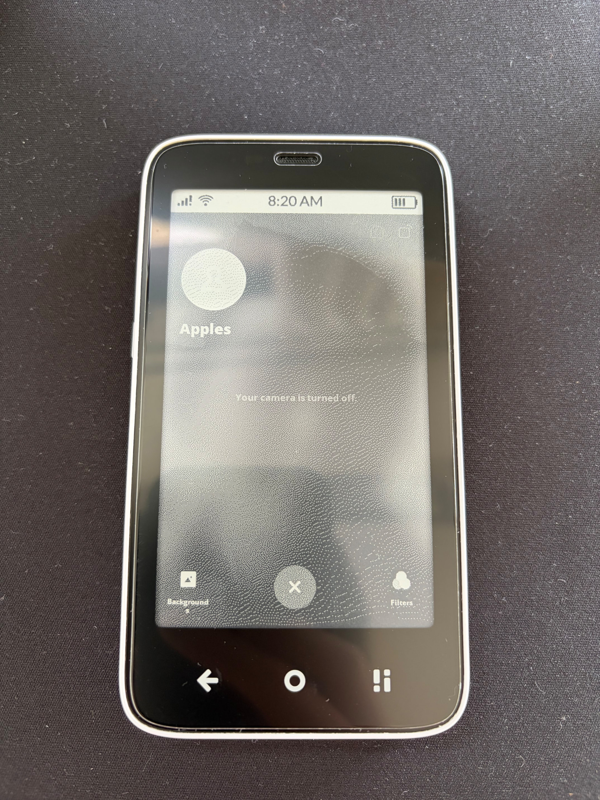

I sideloaded the LINE application onto my Kompakt, but it seems like while the camera is detected for video calls, it always says that the camera is disabled; even though it is enabled with the proper permissions. Does anyone else also have this issue?
You might need to enable the camera. I don’t use LINE- but I use WhatsApp & I had to enable the camera.
I already tried enabling the camera, but it still doesn’t work. None of the buttons do anything either. I already allowed the app to use the camera while in use.
@lightsaber Are you trying to use the video call option? Like I mentioned, I’m not familiar with Line, but I’m wondering if maybe there is an issue because Mudita Kompakt does not have a FRONT-FACING (selfie) camera & it’s quite unusual to make video calls with the REAR camera (but WhatsApp uses the REAR Kompakt camera).
Yes I’m using the video call option in this case, but I should still be able to flip the camera to use the rear camera. Besides that, using the app to take photos/videos via chat doesn’t work either (it crashes the app). I grabbed a snippet of the adb logcat output when I try to use the camera to take a picture in chat.
