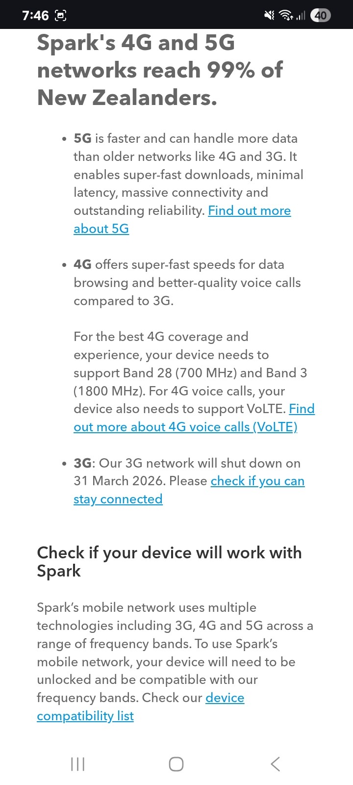

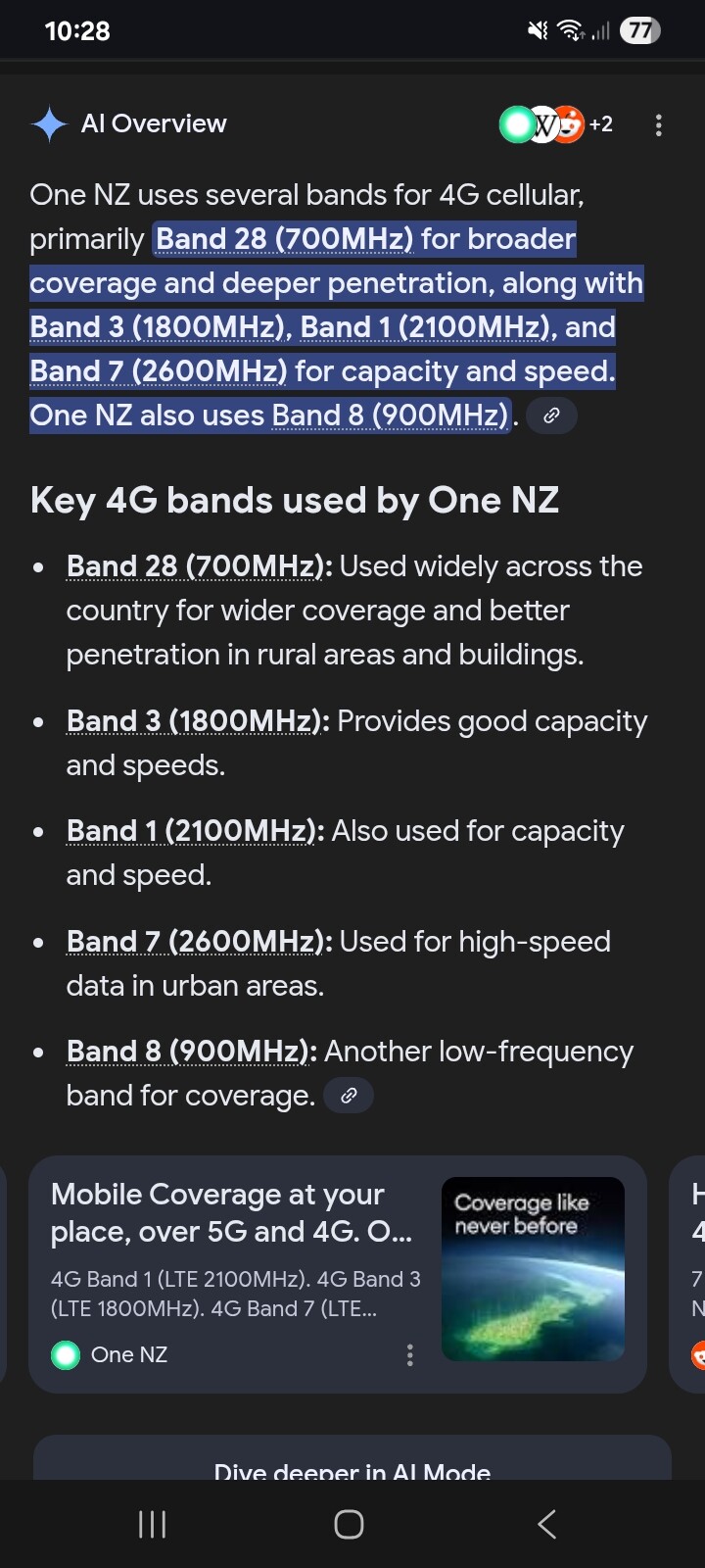

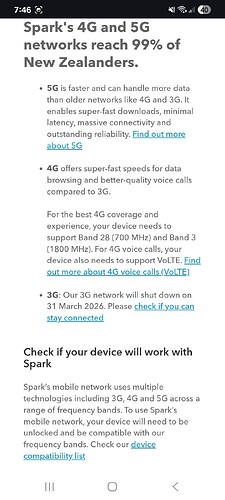

hi team - i had zero cellular coverage with my kompakt recently, where my colleagues with normal phones had connections - it seems that OneNZ (ex vodafone) are using Band 28 (700MHz) for rural areas ie us, and mudita kompakt is missing this bandwidth - is there any possibility that this may be incorporated in future, or a one-off fix? My intended kompakt use is therefore significantly impacted by this particular missing bandwidth.
Your observations are correct. Mudita Kompakt does not support Band 28, and unfortunately this will not change in the future- with this model of Mudita Kompakt.
Hi urszula - thanks - could you please explain the design philosophy or constraints that lead you to omit band28? It seems that the other main provider in NZ is even more reliant on this bandwidth than my current one (I have just investigated to switch to try and resolve!). This would explain why for months OneNZ has been telling me that my mudita was not capable of transitioning to their removal of 3G, and I presumed it was just because their database of obscure cellular devices was deficient).
Please note this deficiency on your website so that NZers in particular (what about other global jurisdictions) can know that the kompakt will not work properly in NZ.

That makes sense to me! However, as @ianp stated above, this needs to be explicitly cautioned about on the Mudita website so that other New Zealanders do not fall prey to this deficiency.
@stephenshutters Thank you for the feedback. We do list all the bands on our website & we don’t hide the fact that Band 28 is not in the list of bands. This topic was also posted on the Forum & on Kickstarter prior to anyone buying or backing the project, so we did our best to be as transparent as possible.
