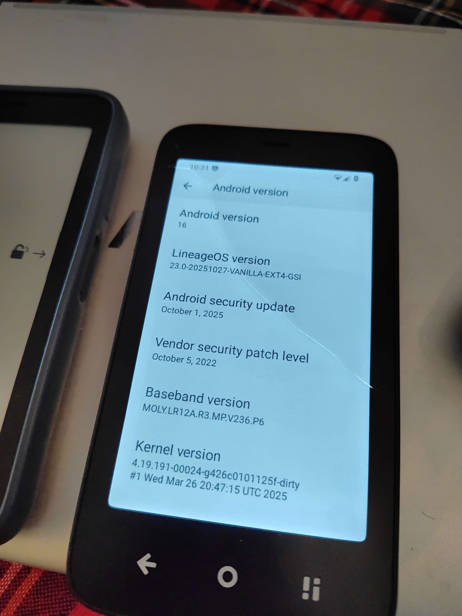

So thanks to @jayloofah, they figured out that MuditaOS 1.1.1 is the only version that will boot a GSI. Unsure what mudita did on the newer versions but they should fix it… lucky I had an old dump of that version.

Hey guys just wanted to say that me and another person when in halves to fund a kompakt for a dev who plans to make a custom gsi for it. Those who want to flash a gsi, I would probably wait until whenever they get the phone and get the custom gsi created. Me and several others are using random gsi’s from online which do have some bugs which one of them being the phone restarting when receiving an incoming call with the display locked. There is a workaround that seems to fix it by enabling a list of settings in the treble settings that comes with the GSI. I am not sure what other issues there are yet but I think having one custom, bug fixed and with eink controls like the dev plans on doing will be much better of course. Currently to make this work you do have to downgrade your phone to MuditaOS 1.1.1 which obviously Mudita does not support so you have to use a system dump for that and then you can flash the GSI. I have not created any instructions on how to do this yet because I am letting Jay have first dibs with that since they were the one who figured out the whole boot issue which was needing to downgrade.
My experience with the GSI is that LineageOS 23(android 16) does feel a bit more slower than LineageOS20(Android 13) so for that reason I have flashed android 13 back to my phone that ive been tinkering with. RCS messaging does work when you flash the GSI with gapps built in but google pay does not. Oddly the tmobile digits app would not work with the original gapps it comes with but after flashing the microg conversion magisk module the digits app finally worked which allows me to send/receive calls/sms through the digits app with my main number. This modded device I have a different sim in for data only. I did also notice that vanilla GSI without gapps feels the most snappy which makes sense since less system resources being used. The main thing I appreciate from the GSI is the native recent app switcher and native notification bar pull down/pop up notis,

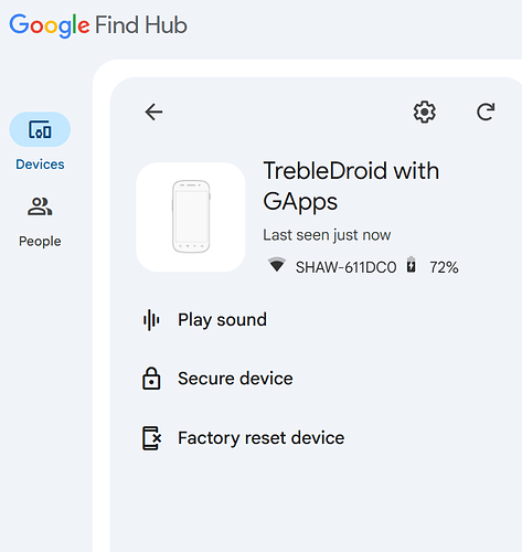

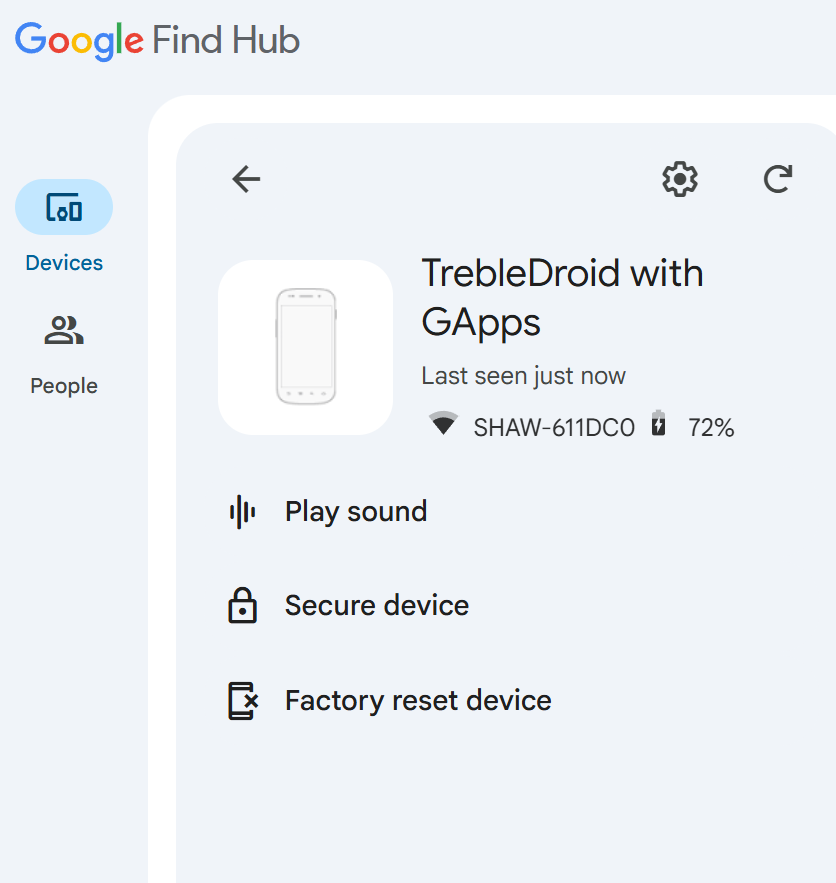

Yes Find My Phone feature works. I installed the GAPPS version of Lineage 20 GSI See below.
