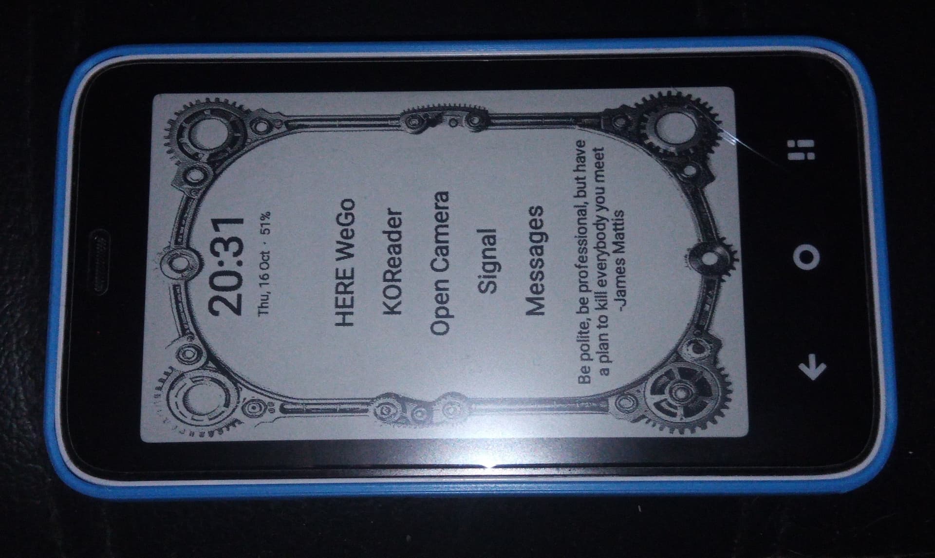

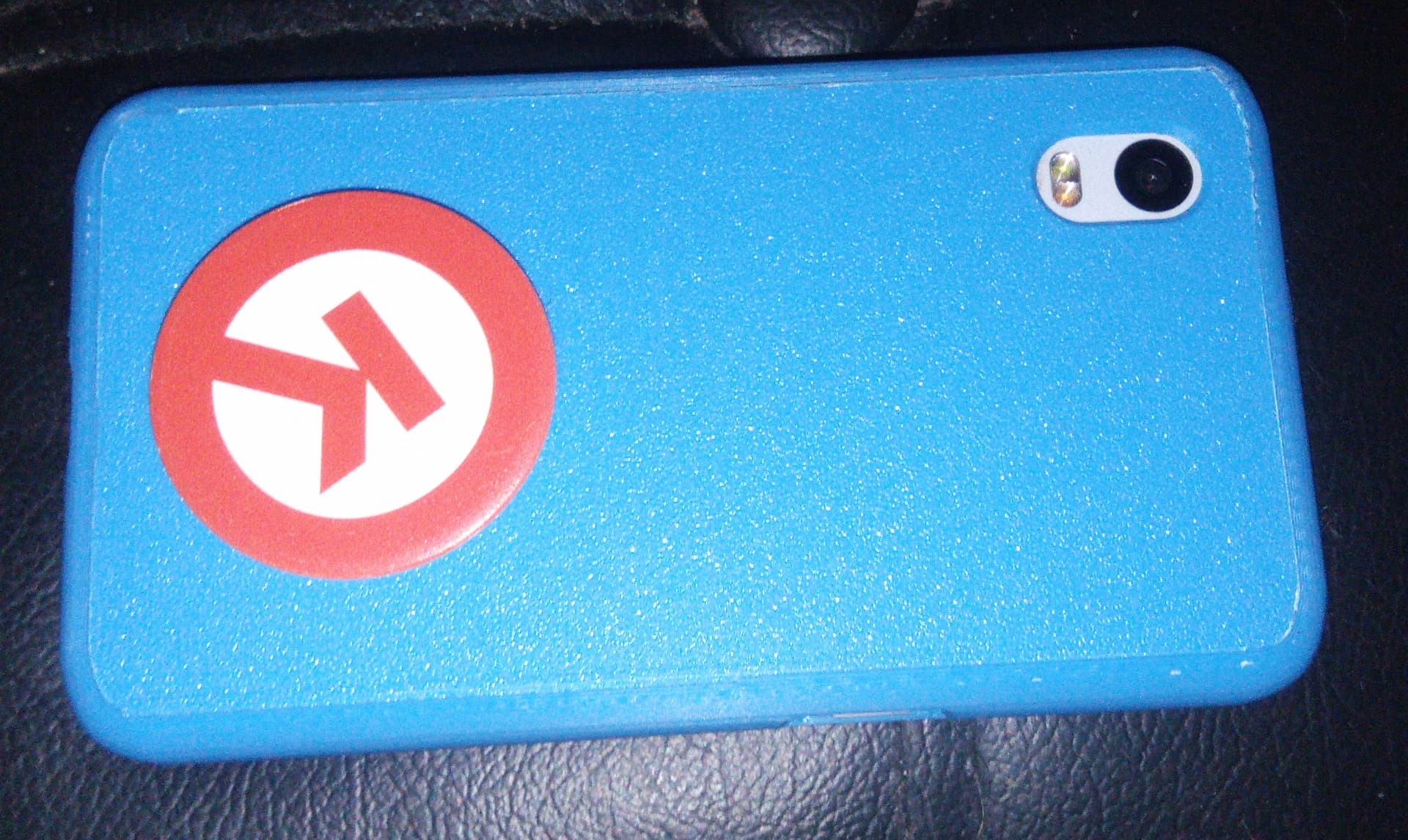

I used PLA. It’s probably not the best choice but it’s what was available, probably better than nothing, and it’s still much more pleasant to hold than the case I got from Mudita. If you have more options, though, I’d go with TPU since it’s more rubbery and probably provides better shock absorption.
Don’t mind the free gas station pop socket on the back, lol.
This was my third run. First was too small. Scaling it up by 1% worked pretty well but on this latest attempt I changed the scaling on the width to only +0.5% and it’s even better.
It is worth noting that the need for scaling might be the result of me using PLA. I might eventually try the original dimensions using TPU since that has some more flexibility to it.

The texture on the back is the texture of the print plate and the sides get some texture too just from the way the filament is deposited. I have smoothed out other models post-print just by spending a few minutes with some sandpaper. I don’t plan to do it for this because I like the texture and it makes it easier to hold but it’s totally doable if you wanted a smoother case.

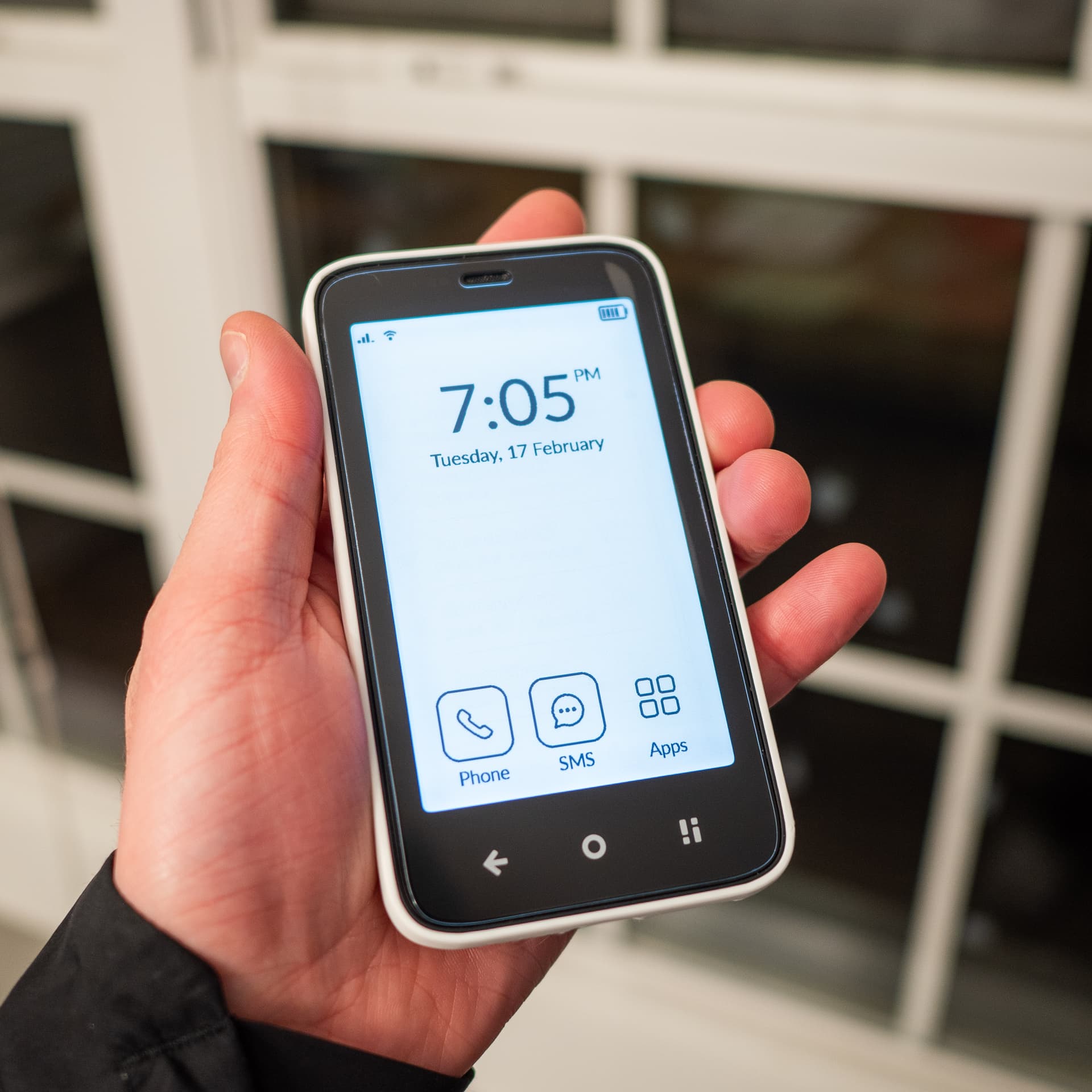

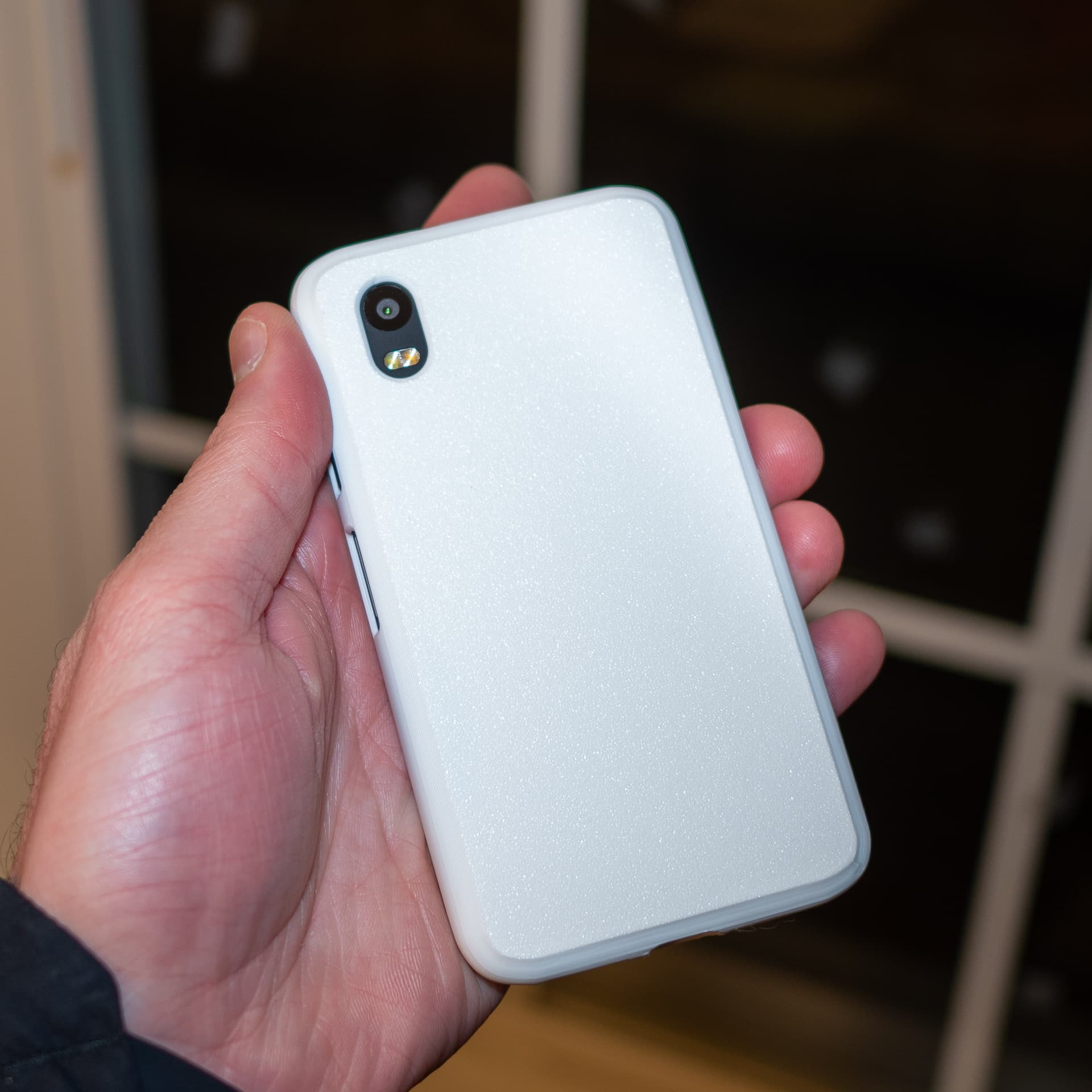

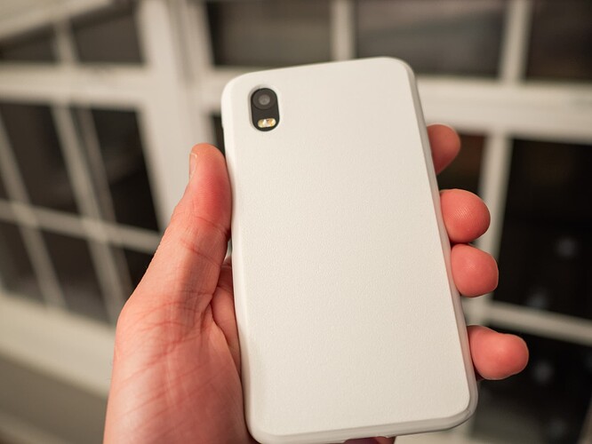

I just printed this print using Matte white PLA on my Bambu Lab a1 and it turned out fantastic!
I am going to experiment with making a version that has MagSafe mounting point so you can easily line up a MagSafe ring for wireless charging and using MagSafe accessories like car mounts etc.
That’s so cool. Looks really good.

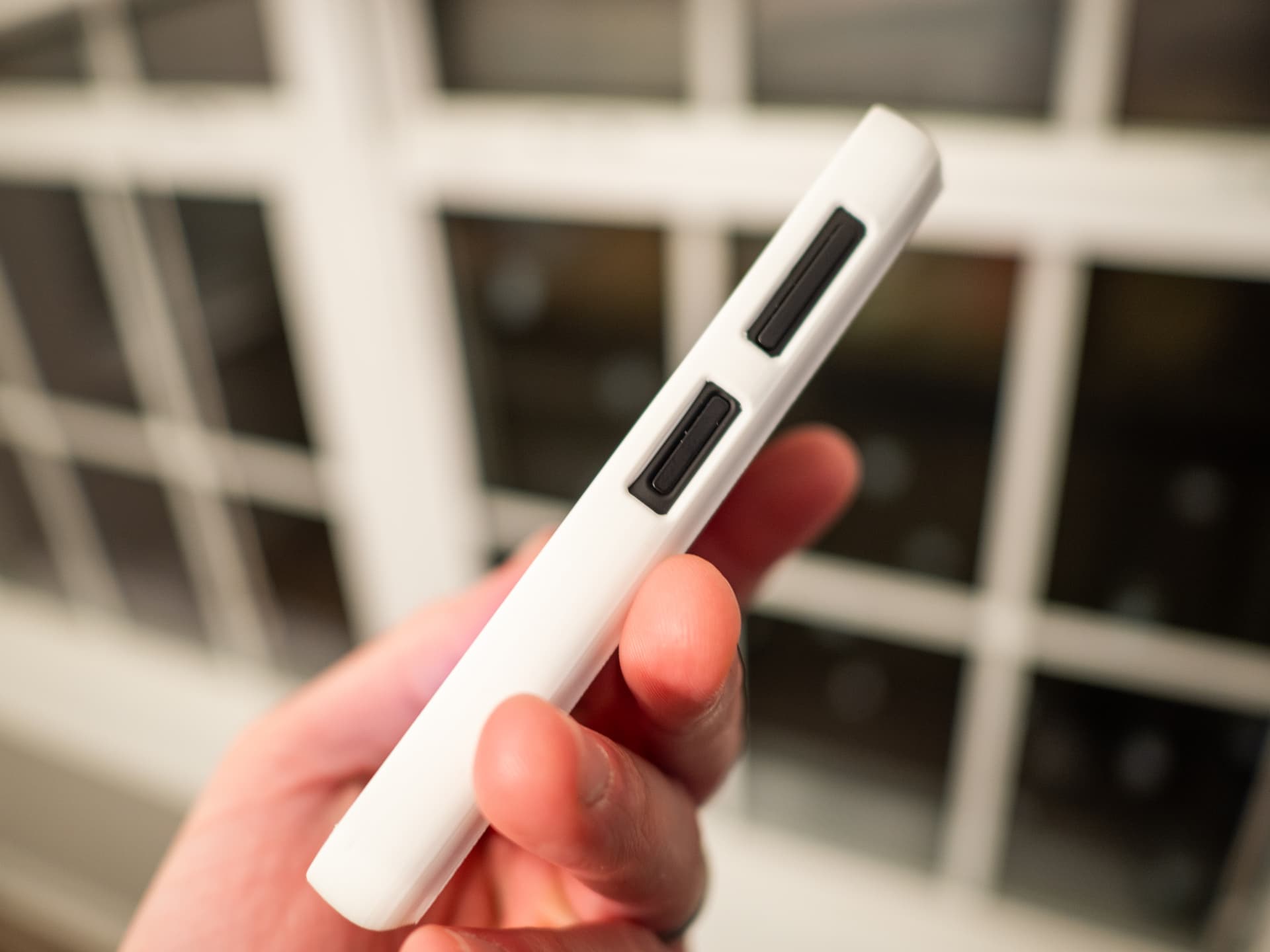

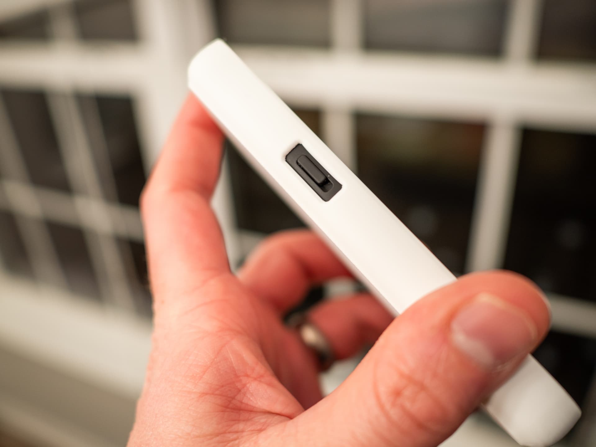

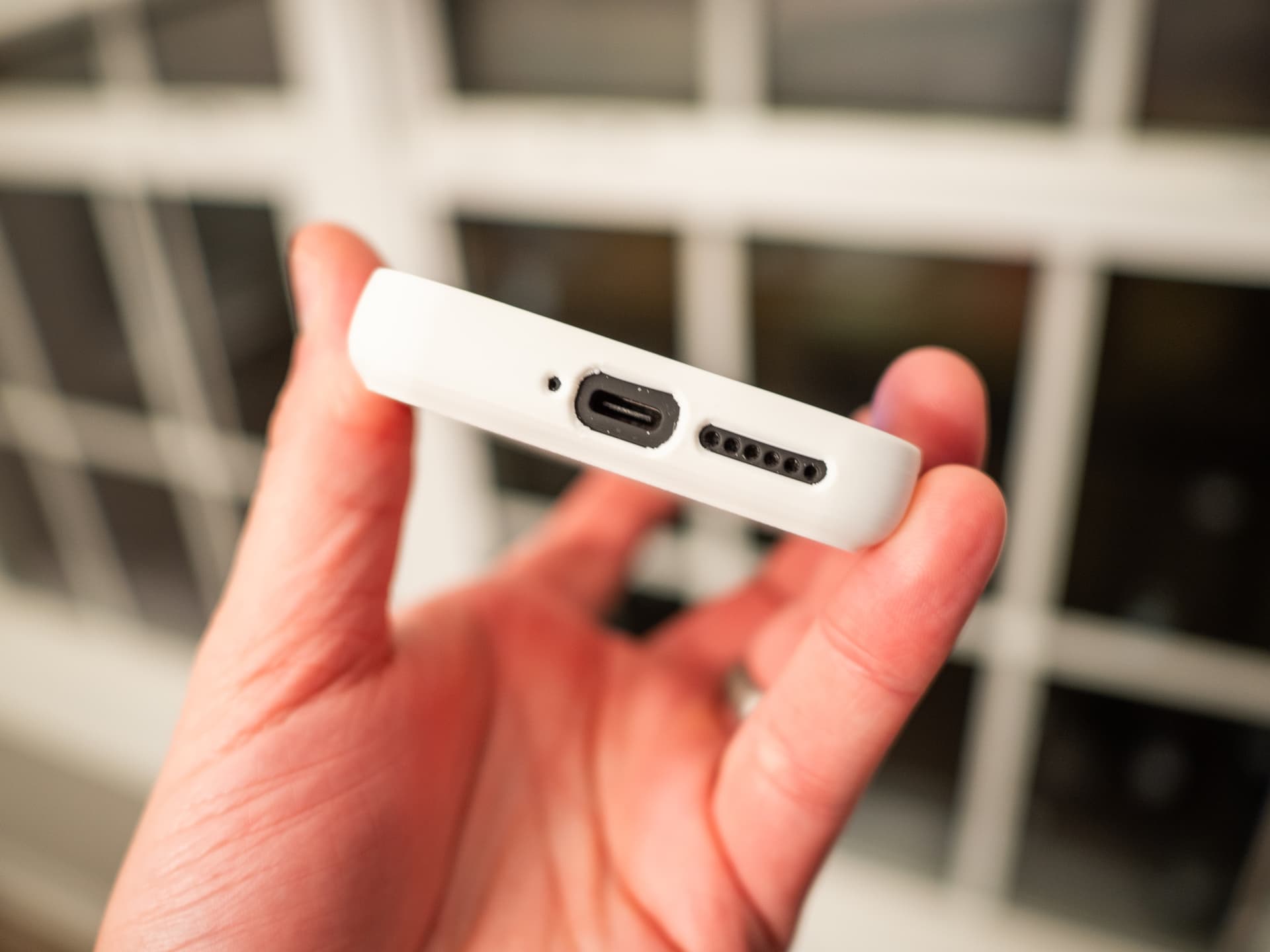

I printed one of these - scaled to 101% on a Bambu A1 in PLA. It worked great. Drilled out the headphone jack a bit though since it is a tad tight.
why did you go 101%?
101% allows a little space for a velvet liner perhaps.
On my printer 100% was too tight. Would not even fit on. 101 seems great.
I had the same issue where printing at 100% was too tight. After doing my first one on a filament printer using PLA, I recently printed a new one using a resin printer and a mix of ABS-like and Tenacious D resins. I thought it would be fine with the more flexible material but once again 100% was too tight. I expanded the length and heigh by 1mm and the width/thickness by 0.5mm, and that fit really well, though I will probably have to take a drill to the holes that are now slightly off.
