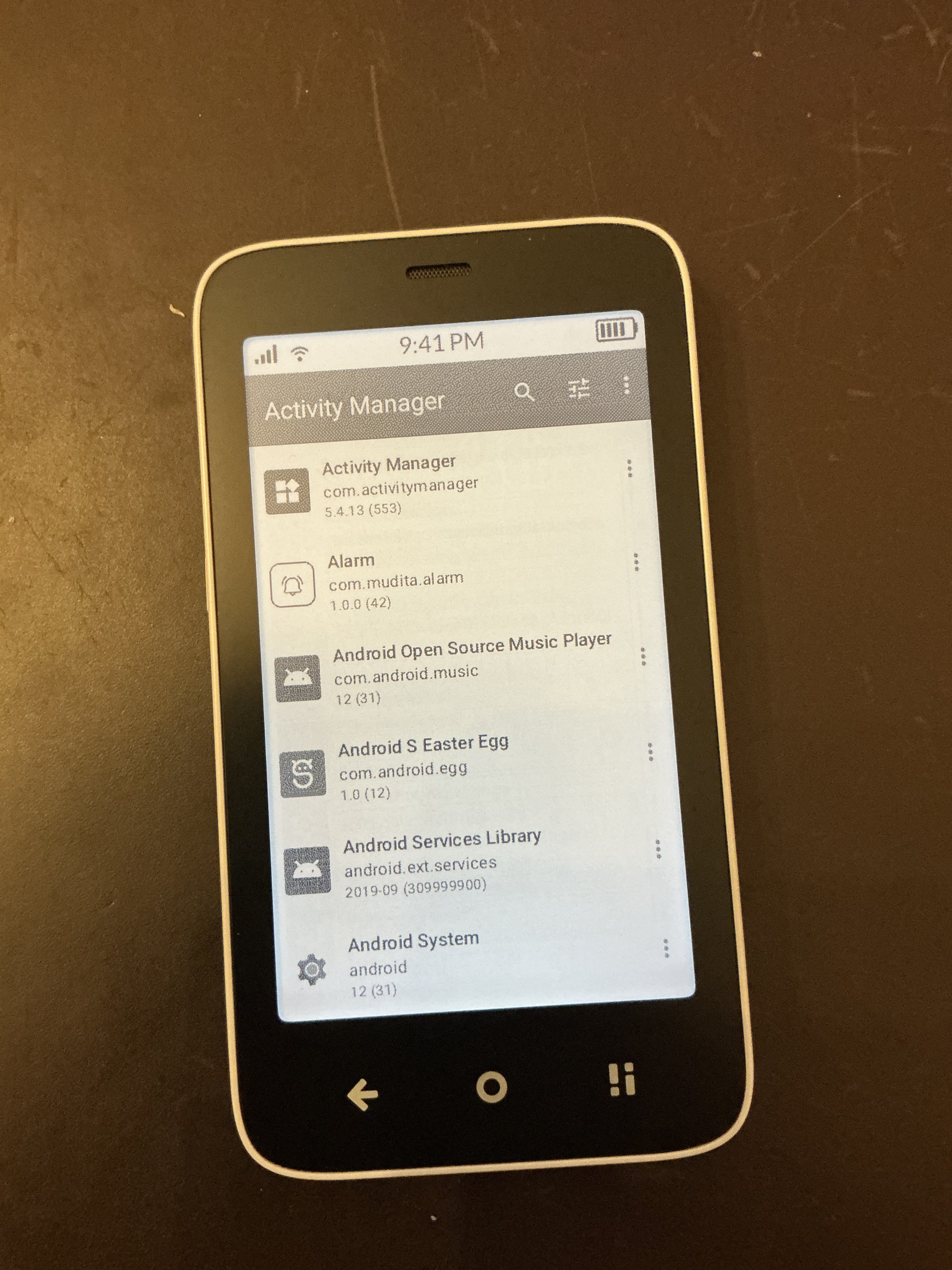

Step 1: Sideload the app “Activity Manager” (I got it from F-droid)
Step 2: Open Activity Manager

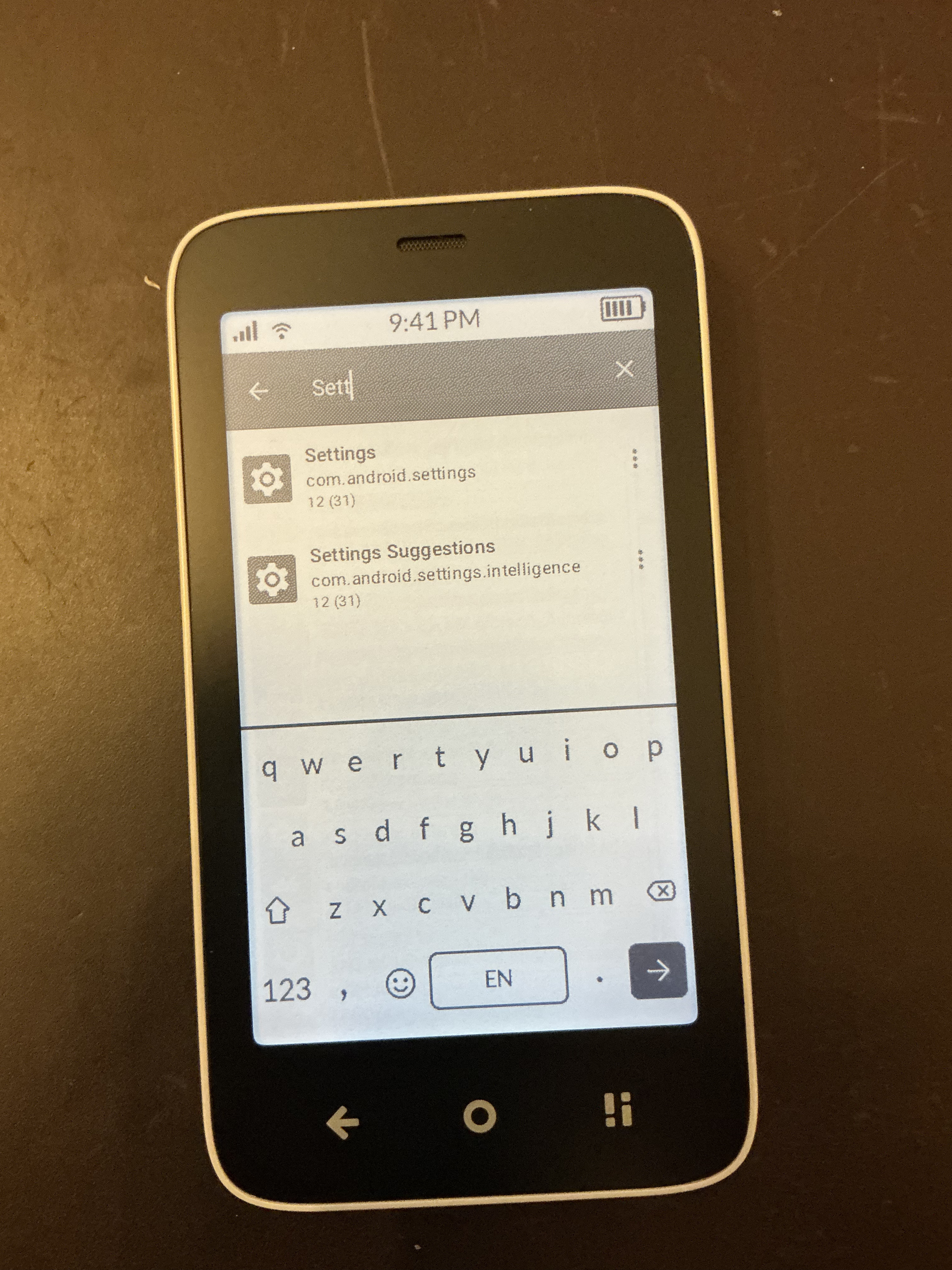

Step 3: Find “com.android.settings”

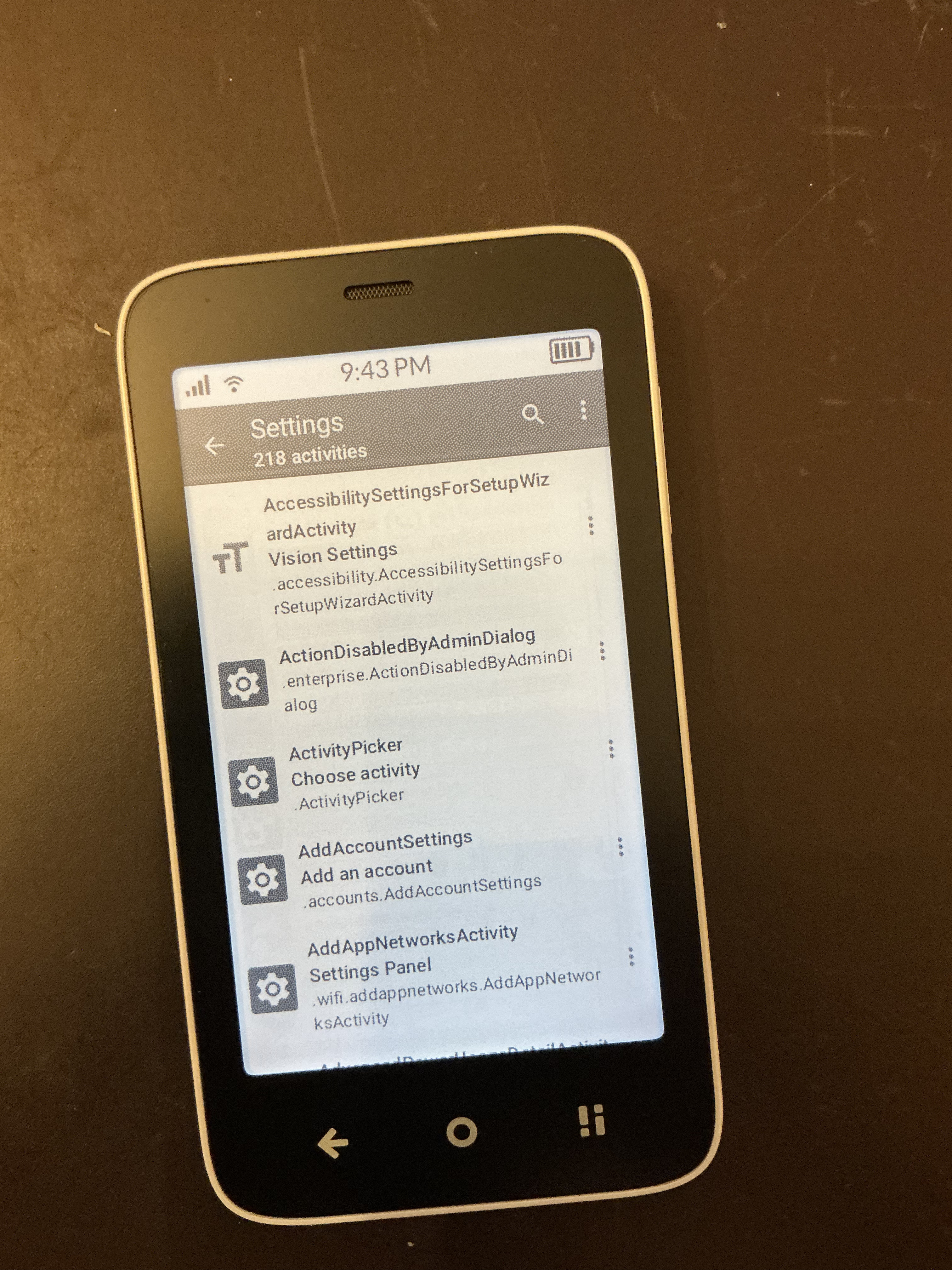

This is how it looks after opening com.android.settings

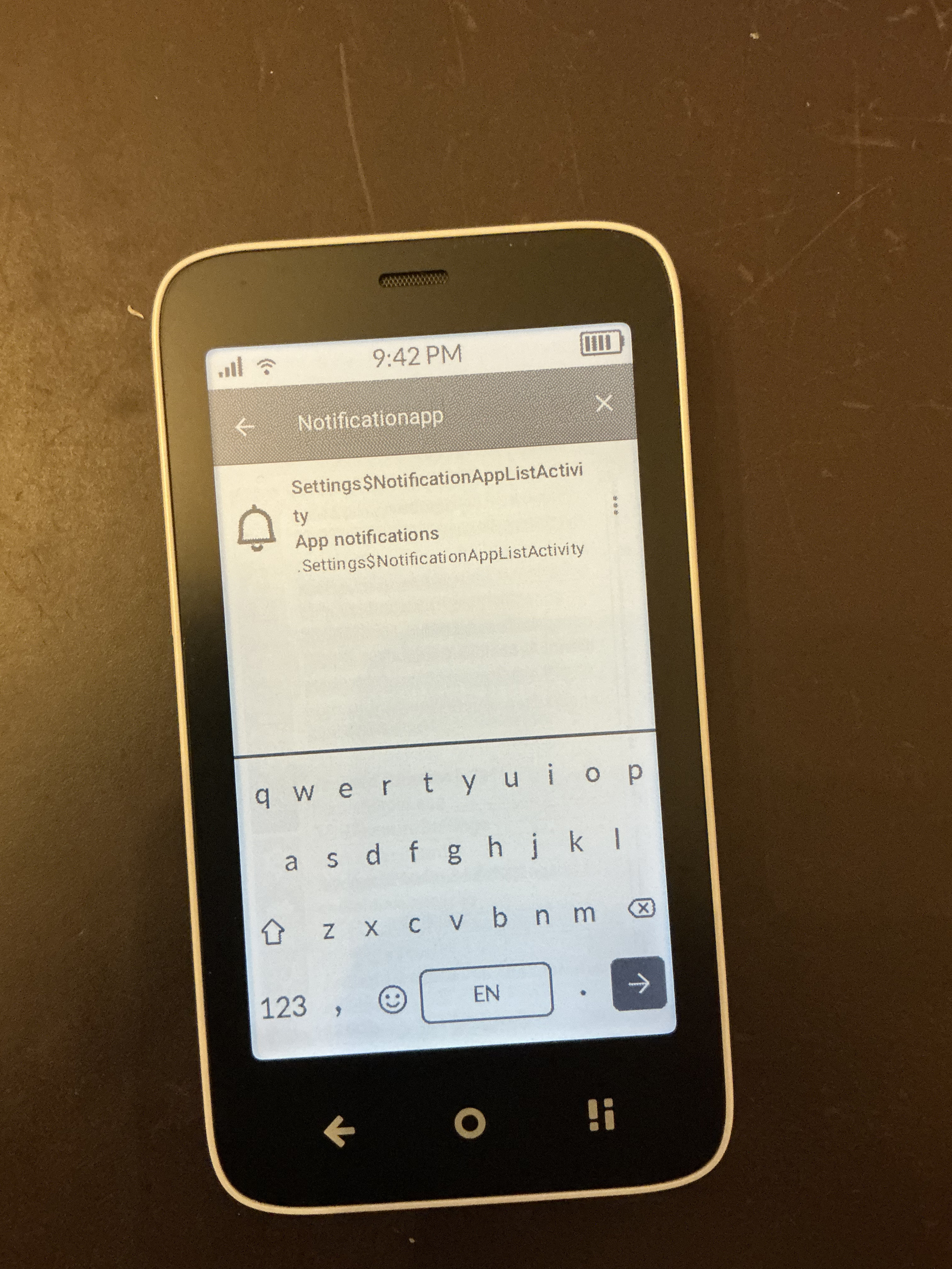

Step 4: Find Settings$NotificationAppListActivity and open it

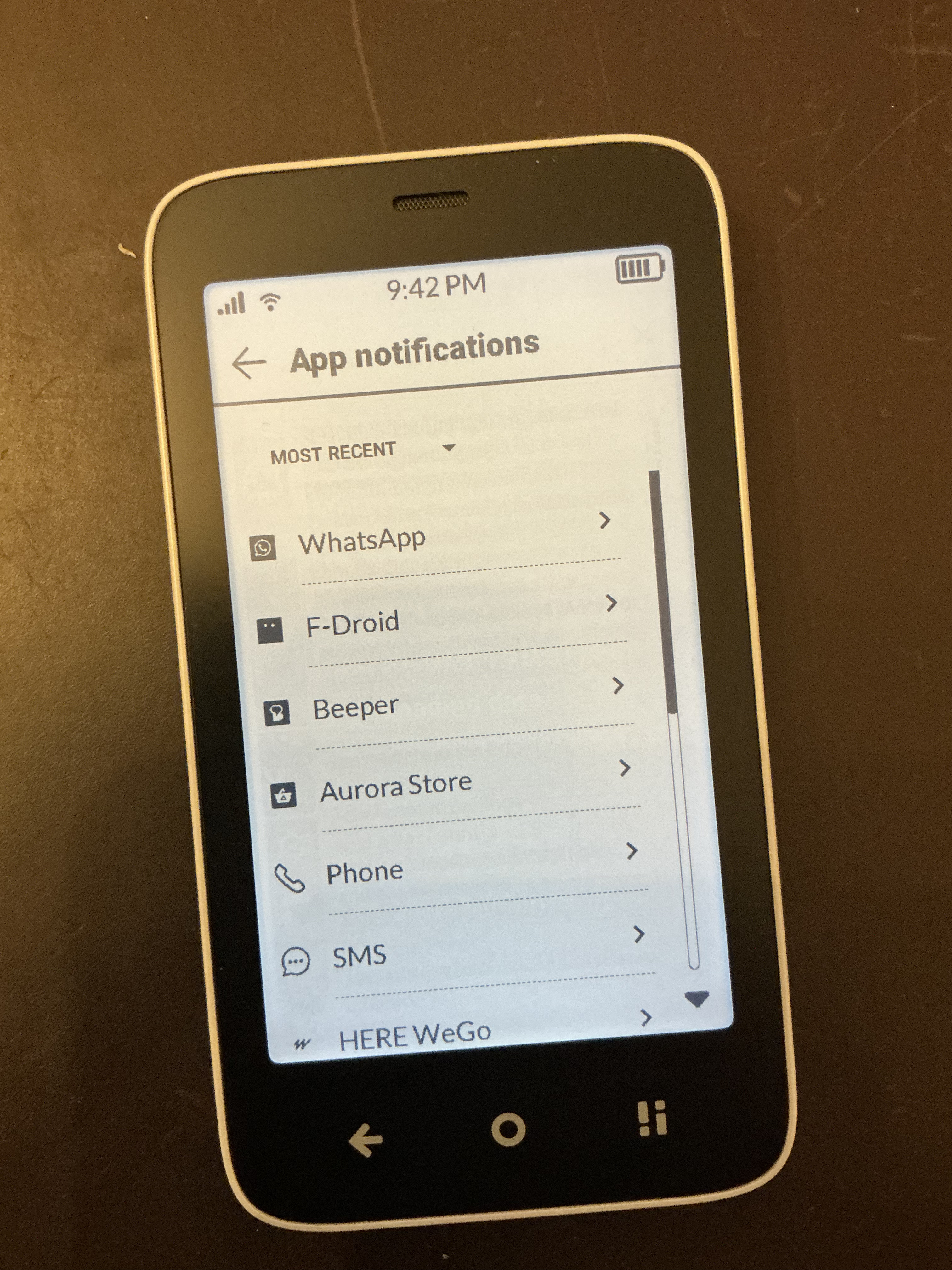

Step 5: Click on the app you want to change notification settings for

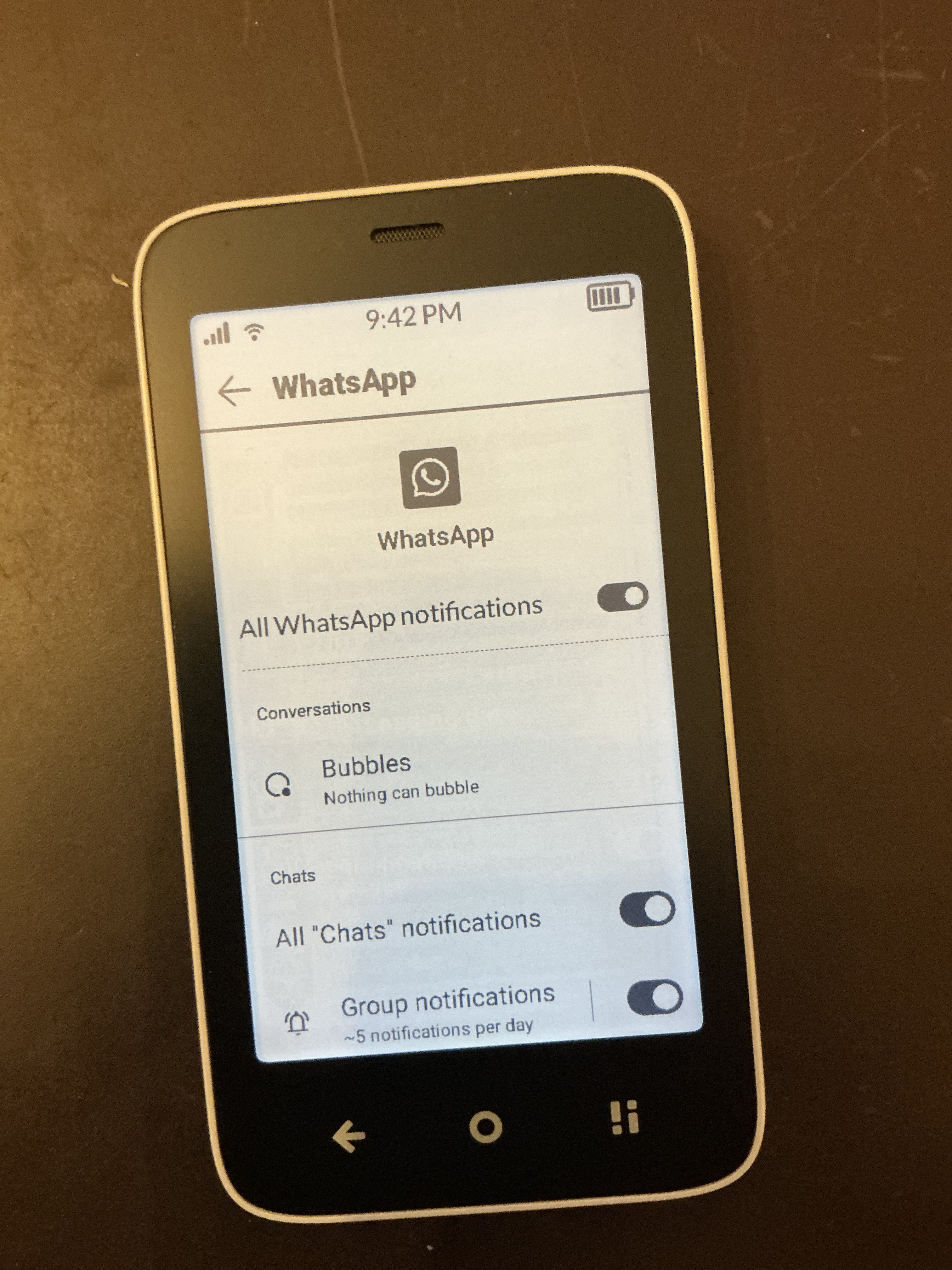

Step 6: Now you can just turn on and off the notification settings. Or click on the little bell to the left of any notification type, and you can configure its sound/vibration
