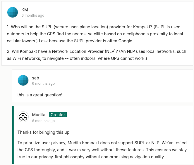

aGPS (assisted GPS) works by not only using GPS but also interpolating the signal of cellphone towers, Bluetooth beacons and WiFi hotspots. For this to work, the phone connects to a database of such points. Google and Apple provide such a database. This is a two-way communication, because the database is also updated as you go. Mudita does not use this privacy-invading service. That’s why it takes longer to get your position and indoors it may be impossible. I saw people here getting upset because the ‘gps doesn’t work’, and that’s because they got used to the aGPS of their former phone. Btw, Mozilla used to offer an privacy-friendly aGPS database but they pulled the plug last year.

@justdanwithaplan, adding to the great explanation of what @nilss posted…

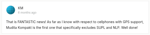

…here is the conversation that I had with Mudita six months ago in the Comments section of the Kickstarter campaign for the Kompakt:
