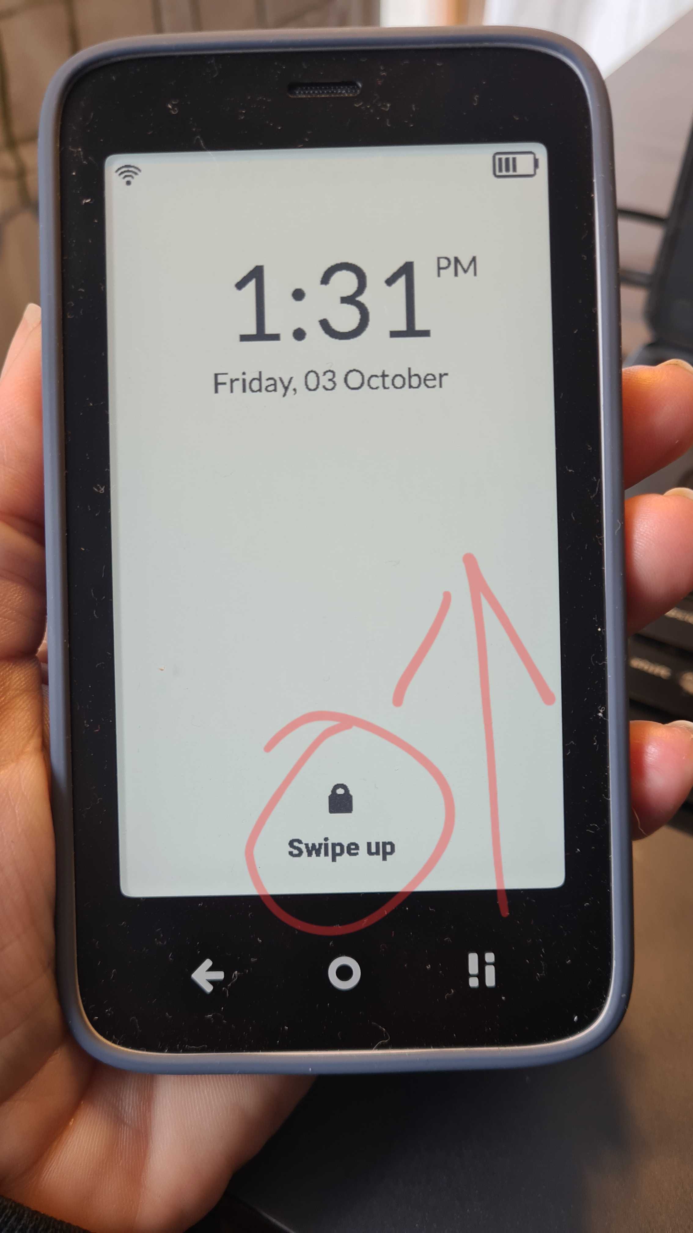

@daken Thanks for reaching out. Just to make sure I understand your correctly…
When you’re swiping up on this screen, you notice that the screen has become less responsive? Is this what’s happening?
Hi Urszula,
Yes when swiping up it’s not very responsive, takes a few goes for it to register. Sometimes it doesn’t register and you have to lock the phone unlock and try again.
@daken thanks for this clarification. Just to make sure we’re all on the same page, do you have any apps sideloaded? Or maybe a launcher?

UPDATE: I talked to the team about the swiping issue & they said that there were some changes made to the swipe gesture to make it more deliberate & intentional because we were having reports of unintentional unlocking of the phone etc.
So, now, the swipe has to be slower, more decisive in order not to unlock the phone. Previously, rapid/dynamic gestures, like an accidental swipe in a purse or pocket could unlock the phone (a least that what users were reporting).
Hopefully that makes sense.
