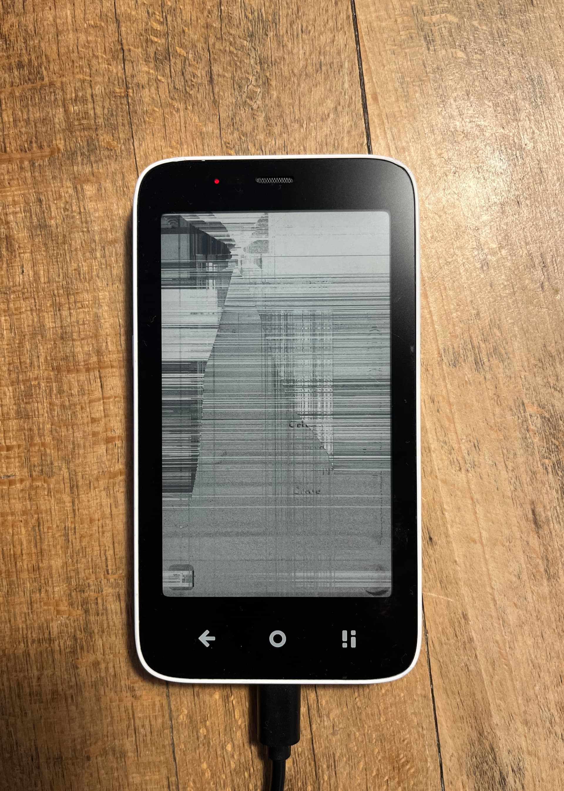

My display broke down a few days ago. The screen is fine but the display beneath it is broken. It is unusable. It had a pixel issue when I got it but it didn’t bother me - you can see that I do not care too much about small issues - and so I didn’t do anything about it. I do not know if this could have played into it. Maybe it is conincidence but the “crack” seems to be exactly where that pixel was located.
How did that happen? It was simply in a pocket with another phone. In my opinion this should not happen. The Mudita website says that Mudita Kompakt phones are built to last long! I was willing to pay the money because I though I would have that phone for AT LEAST 5 years! Now I had it for less than half a year and I need to switch to my smartphone until I find something different.

I had the same situation when I bought the LP2. Do you have a screen protector on yours? Even on my LP2 I had a protector and had this same issue happen. E-Ink is much more delicate than other screen technologies but imo I would rather have the benefits of Eink even if it means I eat the cost of higher risk in damaging it.
Hi @stranger Thanks for sharing such a detailed & thoughtful write-up. I’m really sorry this happened, especially given how intentionally and patiently you’ve been using Mudita Kompakt.
At this point, reaching out to Mudita Support really is the best next step. They’re the right team to assess display-related issues & most importantly, advise on repair or replacement options, particularly since you noticed an early pixel anomaly.
At the same time, I’ve already shared your case with our Kompakt hardware team to get their feedback. I’ve asked specifically about how situations like this can be prevented in the future, including handling & carry scenarios, and whether there’s anything else user can do.
Our team has previously said that E ink screen tend to be more fragile, but I’ve asked for some tips, so that maybe it can help others avoid similar issues.

I cracked the outer layer (digitizer) of my screen.
The Mudita replacement screen and back plate that I bought was on back order so took a long time to arrive but the Mudita instructions made replacing it myself pretty straight forward to do. I thought I had a white phone but apparently I have the slate version but reordered a white one so my buttons are now slate and my display bezel and back are now white. I like my phones new look.
UPDATE: Mudita Customer Service has done a great job replacing my screen and even adding a screen protector! Once I sent my phone (from Germany), it only took a few days for it to be shipped back.

Apparently the phone was switched out. That is no issue, except that the backup in the Mudita application is dependent on the phone, so it does not show the backups I have created on my old phone. I will try to find ways to get my backups on this new mudita kompakt.

Rename the backup file with the new phone’s serial number
That was also my first guess, however, nothing really changed after the backup was downloaded on my phone. I am trying to update the phone now to the version my old phone was in and then hopefully it’ll work.
I am assuming, though, that I will have to start all over again with my inkOS setup?
@stranger i think the backup only backs only contacts, sms, it’s not a full device backup.
As for inkOS, inkOS has it’s own backup function in Advanced / Backup. If you saved the json file you can bring it back how it was. If not you’ll have to set it up again.

When it comes to the backup, @gezimos is pointing you in the right direction.
It takes a bit of a workaround because if the serial number has changed, normal backup will not work. You need to change the file name so that it contains the new backup.
This is the easiest way:
  • Make a backup on your new phone, any backup will do.
  • Open the backup folder and copy the name of this file.
  • Then, delete this new backup and paste the old backup from your previous phone there.
  • Change the name of the file from point 3 to the one copied in point 2.
  • Now it should detect and work.
