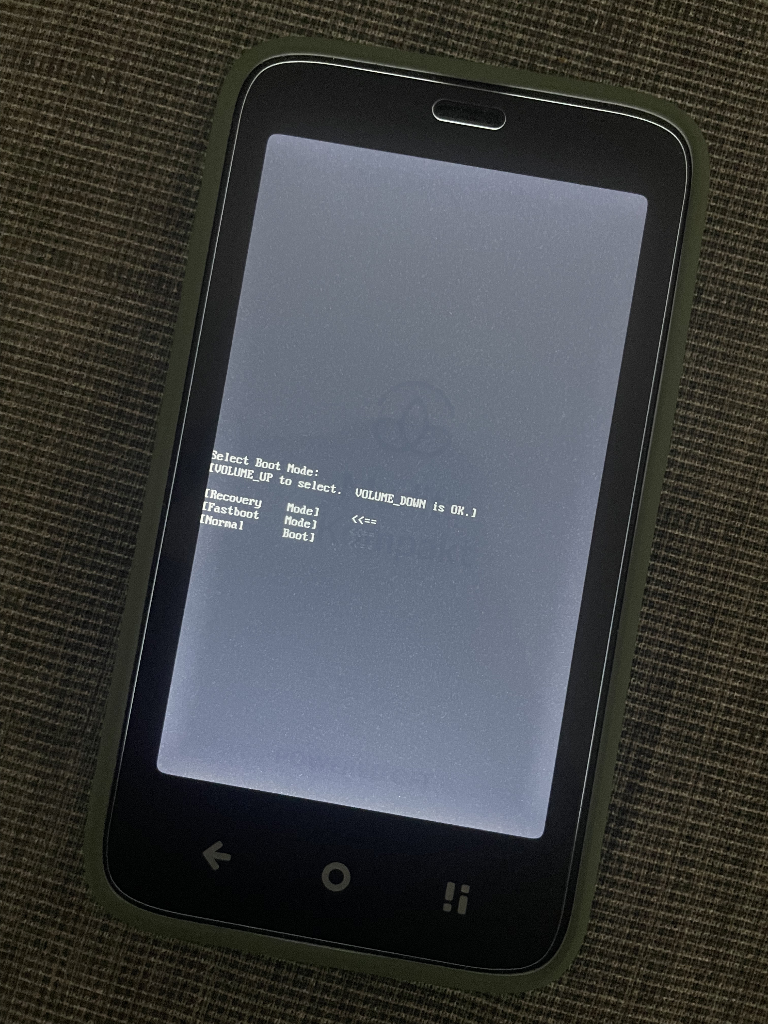

  2. Hold Power Button + Volume up key until the light turns on, then stop holding the power button and only hold the volume up key until this menu appears
  3. When this menu appears use the volume up key to scroll to Recovery mode <<==
    The screen flashes very slow here so be patient, it might look like it doesn’t work at first.
    When <<== is at recovery mode then press the volume down button.

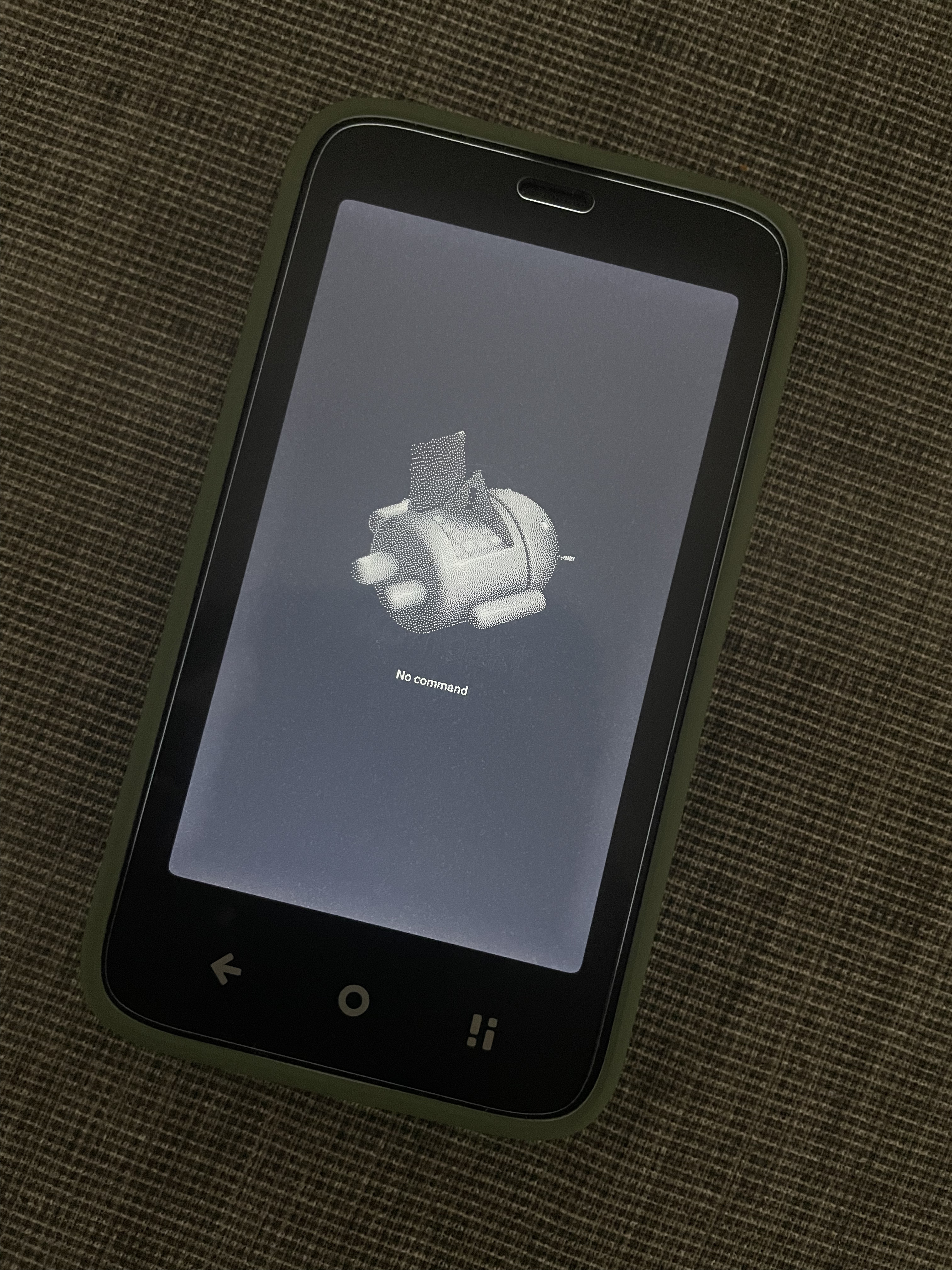

  4. It will take you to this screen
    When you get to the “no command” screen try this. Hold down the power button for 3-5 seconds and then press and release the Volume up button.

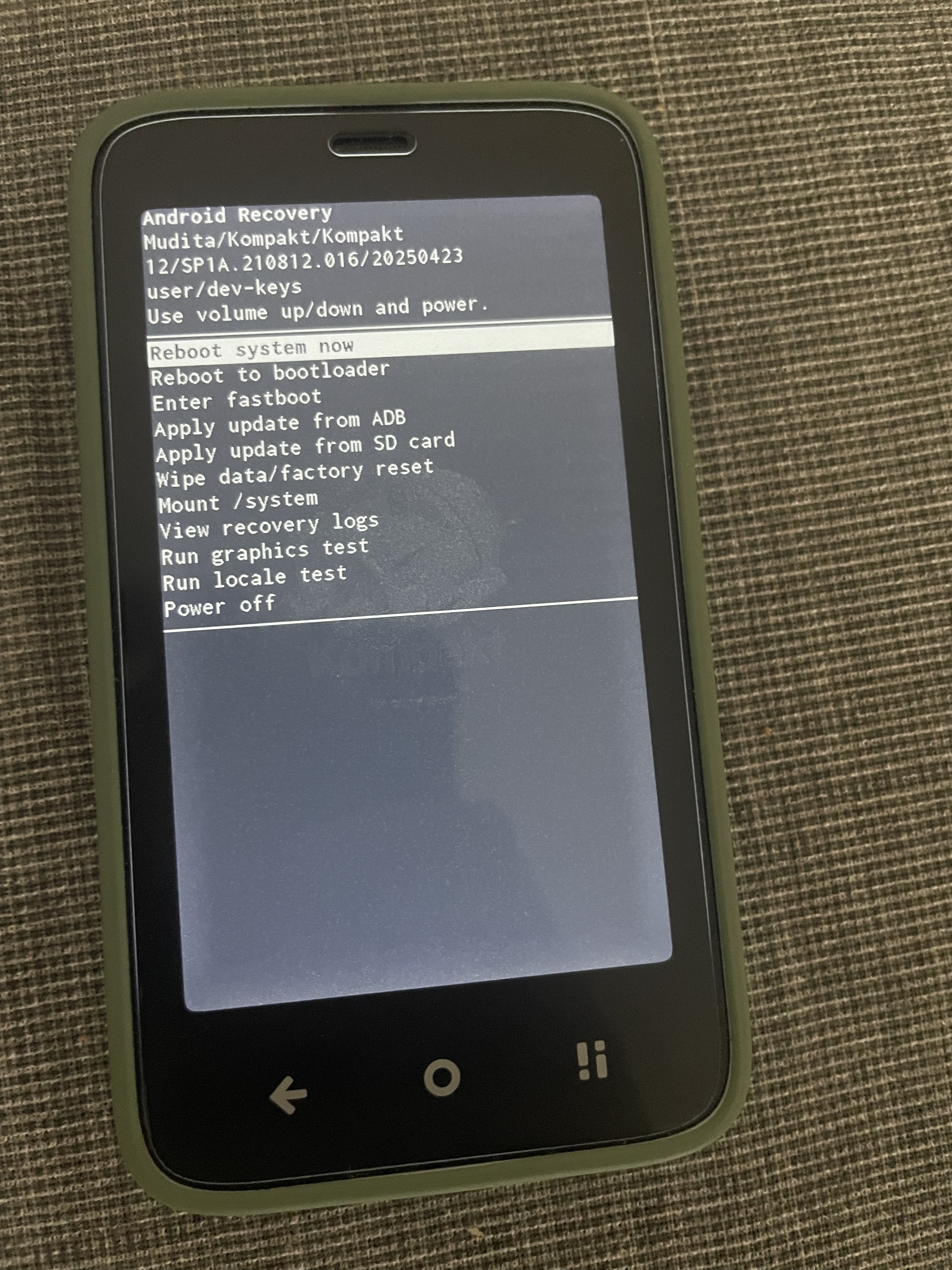

  5. This will take you you to this screen
Scroll with volume down key to Wipe data/Factory reset. And press the power button and the factory reset process should start.

I’ve yet to see the no command screen sadly. Am I doing something incorrectly?
Make sure in step 3 you’re just scrolling with volume up, the volume down is for entering. Make sure to wait up to 10 seconds when moving between the steps: Recovery, Fastboot and Normal. It might look like you’re at recovery but you might be at Normal (because the screen takes a long to refresh here).

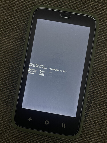

When the menu looks like this
Recover <<==
Press volume down, you should see the mudita logo flash once or twice and it will take you to No command screen.

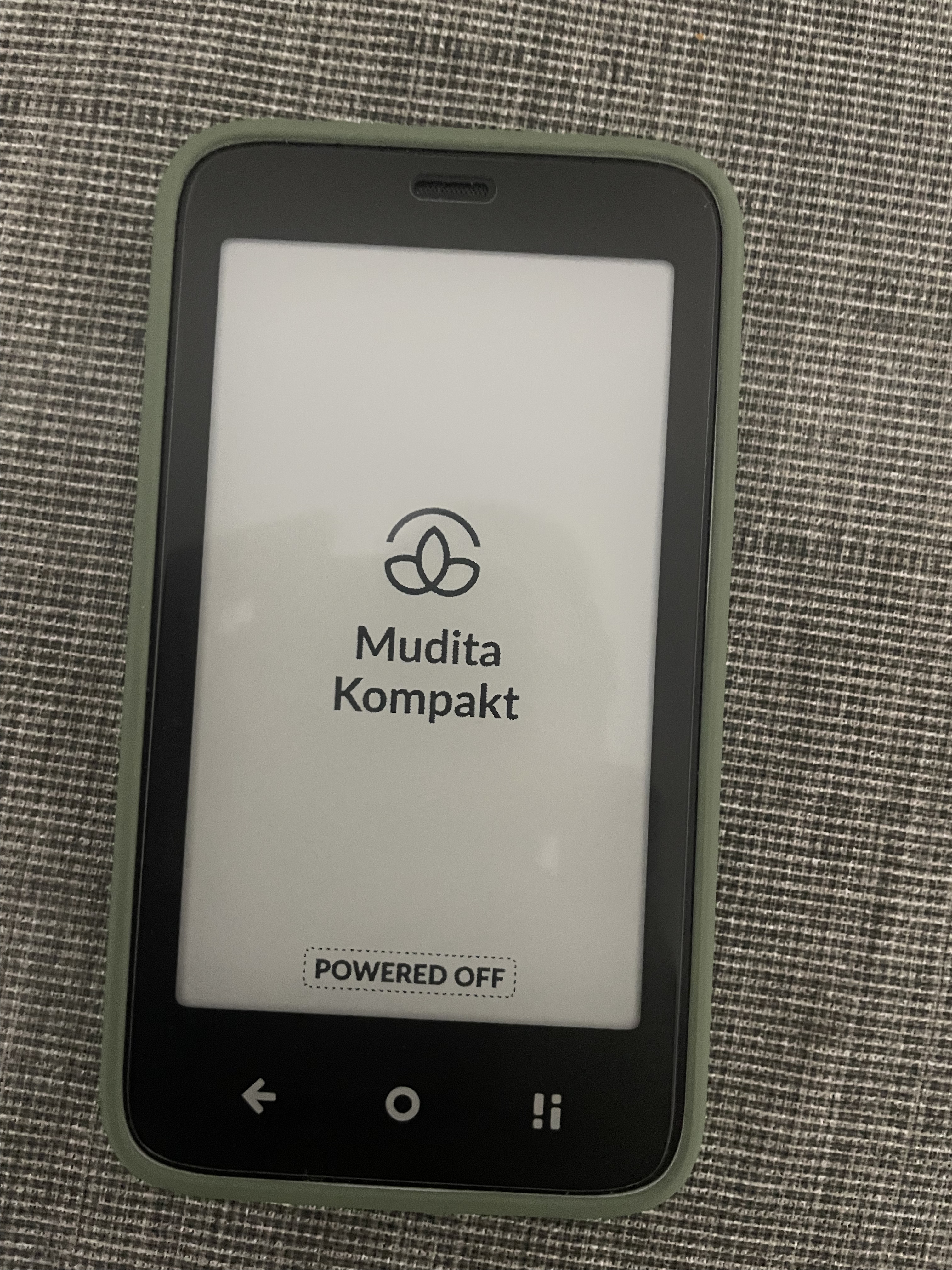

My phone is fresh out of the box, zero updates. My off screen looks completely different to yours too (mine being completely black)… So perhaps that is the case.
That explains it then, mine is 1.1.1 Global version
