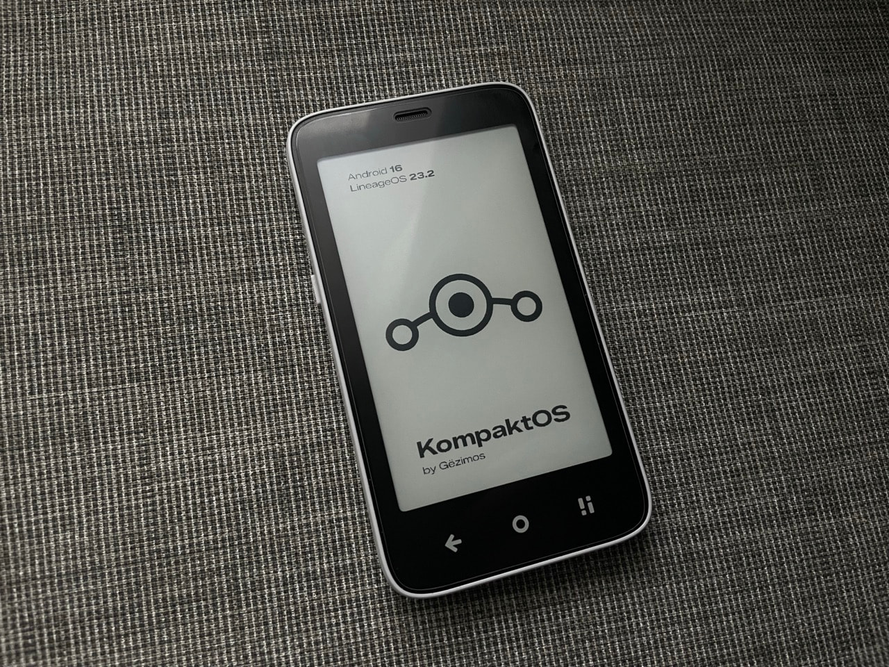

I wasn’t happy with any LineageOS build that worked on this device, mostly due to all of them having 0 eink optimizations and some of the Kompakt features not working, so I started building a custom one specifically for Kompakt.
It will be based on LineageOS 23.2 (Android 16) with security updates from August 2026.
There will be a Vanilla version and a Gapps version (Gapps as in google play services).
And most importantly, this will not require any partition downgrading. I’ve managed to patch SEpolicy for this to work :slight_smile:

Of course, this will be open-sourced as it is based on many open-source projects :slight_smile:

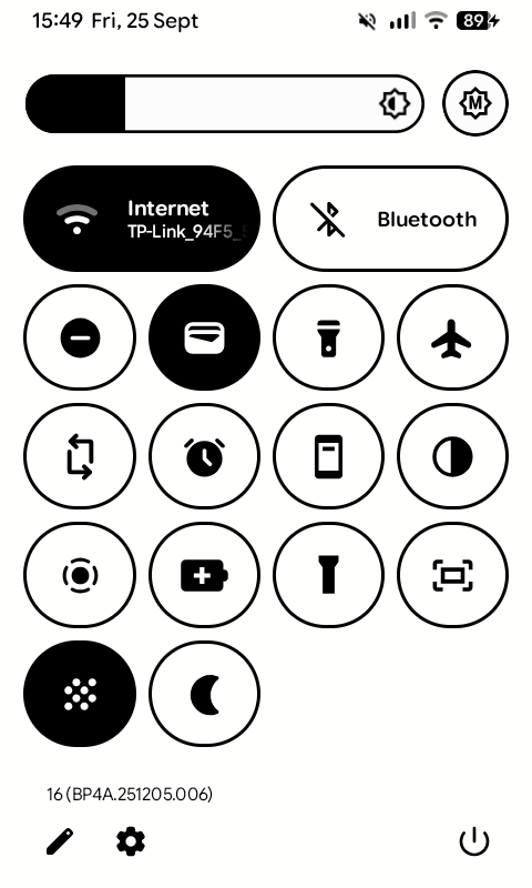

Going for mostly stock LineageOS E-ink edition.
On top of that patches specifically for the Kompakt:
  • Offline Mode Overlay
  • E-sim
  • E-ink modes per app
  • Invert mode per app
  • Functional Always On Display
  • Editable Sleep Screen image

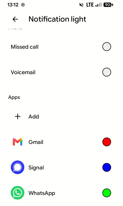

  • LED Notification working
  • Fingerprint scroll/dpad mode (+ long pres and double tap)
  • FM Radio working (even without headphones, utilizing short antena)
  • Front Camera not crashing apps (cloned back camera, so users can photo verify in some apps).

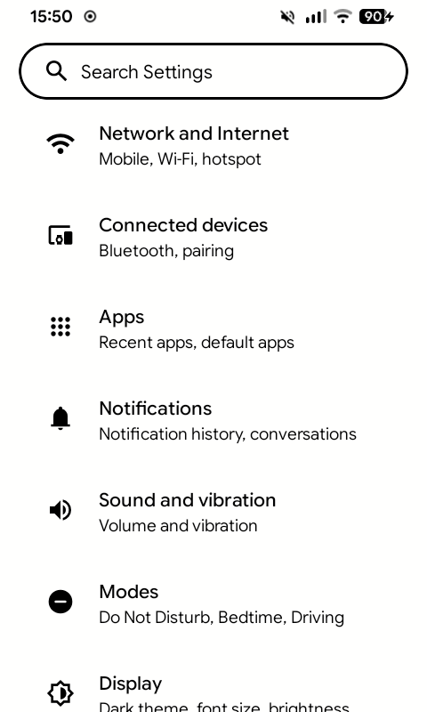

Pretty much all settings/systemui, scrolling, colors, and all AOSP & default Lineage apps to be black and white only. (might have missed a few dialogs/popups here and there, but majority have been edited).
Oh absolutely it was a nightmare to remove material theme-ing and replace them with black and white. Android themes have no logic, AOSP has dark apps in light mode (like clock) WTF!
But I’ve been able to theme both light/dark so they’re in very good state at this point.

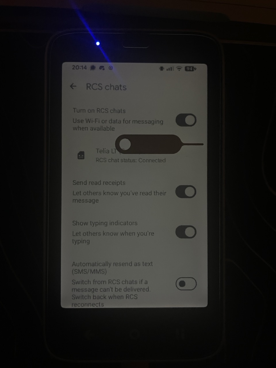

This is all super exciting. Does your build enable RCS?
Yes,it is working. (with Google Messsages of course).
There’s always the possibility of Google targeting the build as uncertified and stopping it.
There are some work around to this that would require root.
