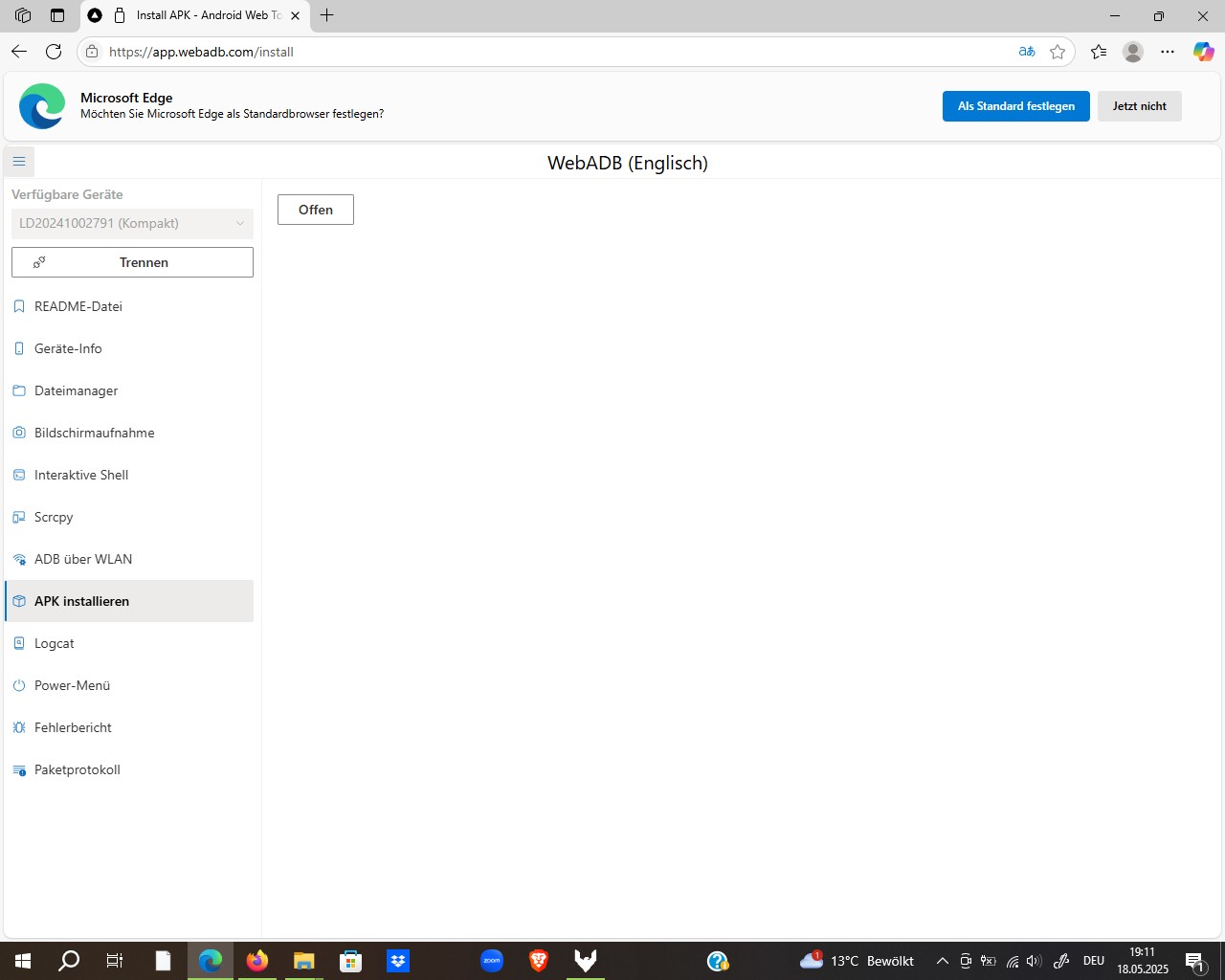

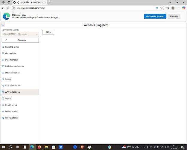

There , I have the option open , but, i think there is something missing :neutral_face:
appreciate help thanks
You may want to check if your browser can run webadb. From their website : " only Chromium-based browsers (Chrome, Microsoft Edge, Opera) support the WebUSB API."
Then you need to click the “connect” (trennen on your screenshot) button and everything should work.

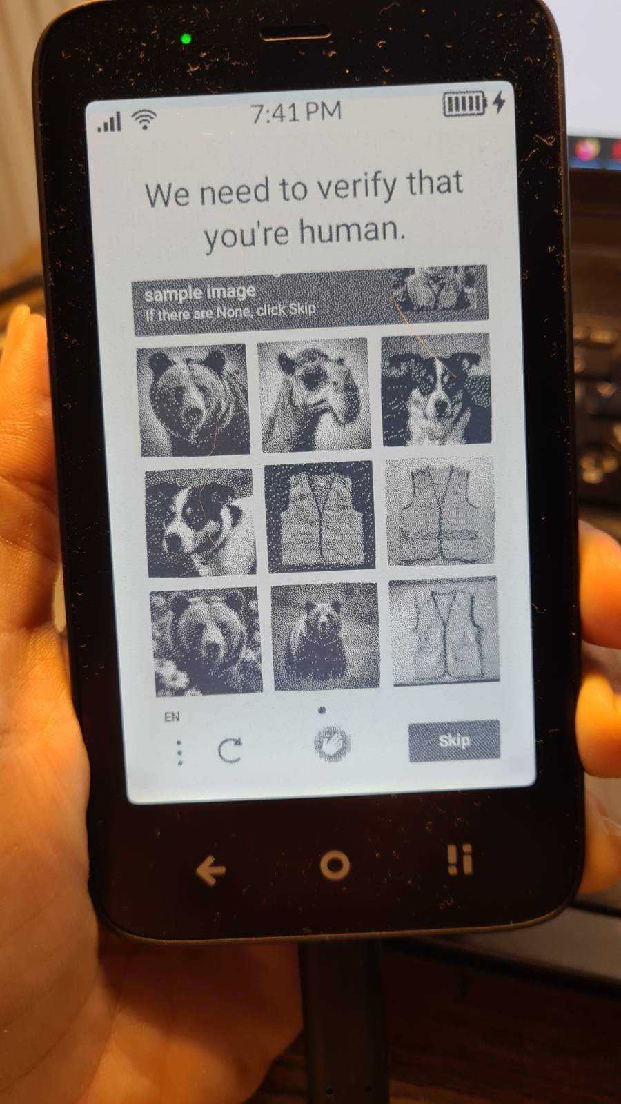

I have Spotify downloaded but can’t get past the Capcha. Even when I think I have answered correctly, it just hangs on the page saying I need to verify I’m a human. Ideas?

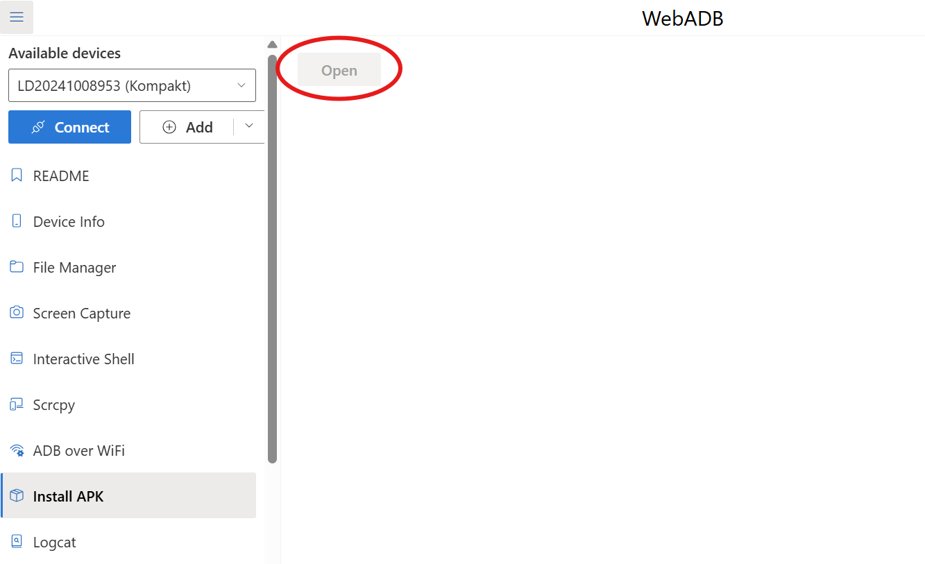

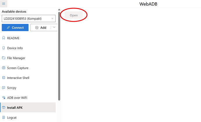

The “open” button is grey. I can’t click on it, therefore, can’t add the aurora or f-droid apk. How can I fix that?
It looks like you haven’t clicked the blue [Connect] button on the left yet. Try tapping on that first (you might need to approve it on your phone also).
I can’t believe how dumb I can be sometimes! All solved, thank you so much, Damian!
