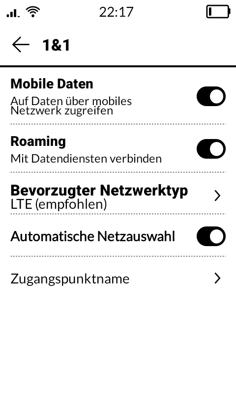

Hello, I’m just wondering if there is a possibility to activate VoLTE at the current state of development? Had a phone call yesterday and totally missed the speech quality of VoLTE. Somehow I have read that Mudita Kompakt does support this for some specific carriers, but I do not know where to find a list or so and if this will be extended in future.
For me, I do not see any VoLTE option in the phone settings. My carrier is 1&1 Germany, running on Vodafone 4G cell phone network. Thank you for any information. I would suggest to add this to the FAQ on the website :slight_smile:

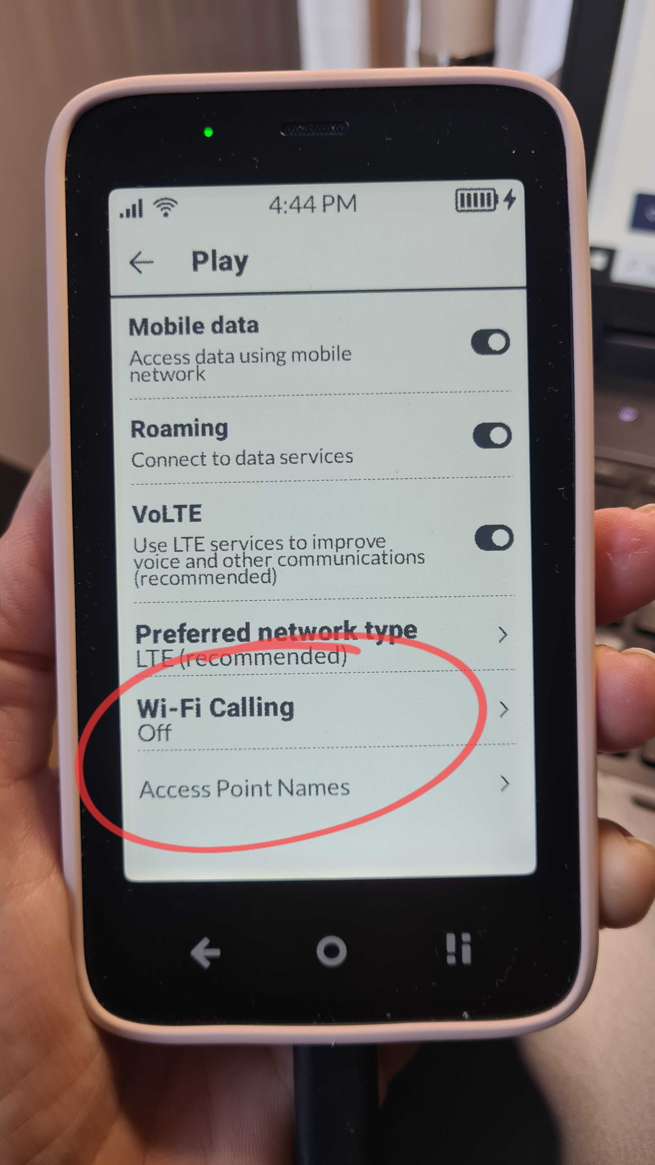

Wifi calling is also available
Yeah I saw that in the other thread, but for me VoLTE is invisible as well as WiFi calling. What can I do to solve this?
That’s interesting, it’s exactly where I have both options.

@MicKitten We did some digging & we found out that 1&1 is in the process of building its own VoLTE network (they don’t have one yet), BUT they are using O2’s resources for VoLTE. So this may be the issue with your connection.

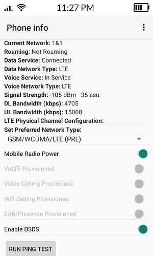

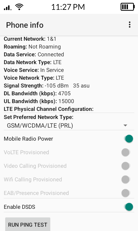

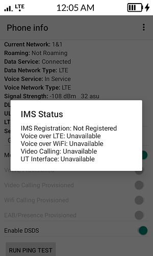

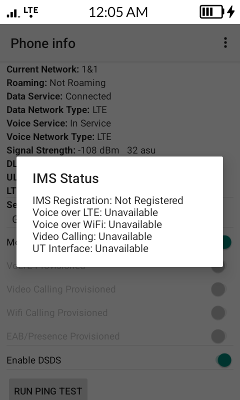

Thank you for the research. I dialed * # * # 4 6 3 6 # * # * and got the following response. I think “VoLTE provisionised” should be enabled, but first the “IMS registatration” state should be registered. On the 1&1 website they say that users can easily activate VoLTE in the phone settings. No restrictions mentioned there. From what I have read through several forums (it is obviously a very common problem), the smartphone manufacturer has to implement the VoLTE functions for each carrier in their firmware. So maybe this one is just not supported from your side?
