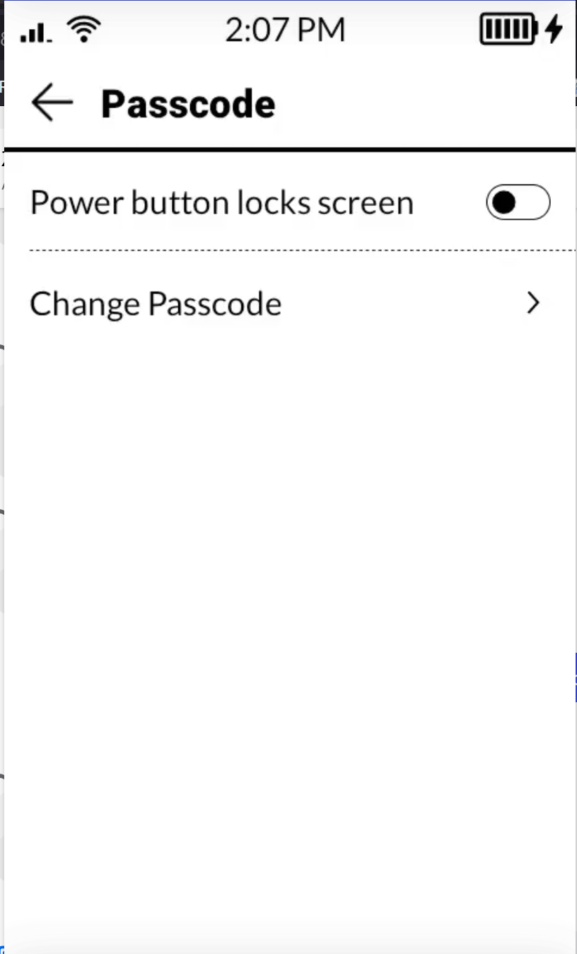

@ovy
Do you have this enabled?
disabled :slight_smile:
