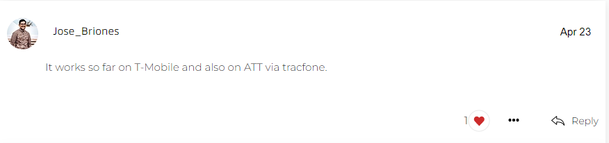

Sorry to hear your experience. The phone is definitely in need of optimizations for the American market. It only works “reliably” with T-mobile per my testing. And even then, the phone disconnects from the signal half the time. Hope you can get a refund.

Some of our users reported, as recently as last month, that they were able to get service on AT&T
