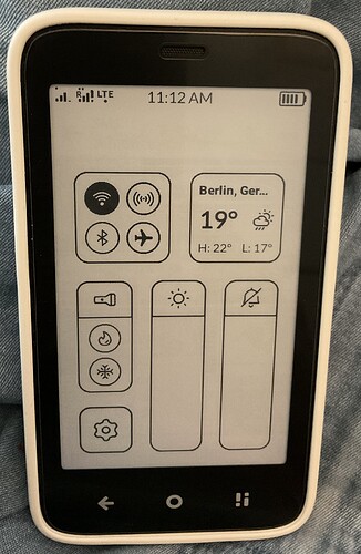

I always use brightness at the lowest setting I can manually adjust. Depicted is what I my optimum. I mean that’s what I always thought eink is for. For me the backlight switch should be 1/0 in the drawer, with an option for light detection but only to the preset level!
