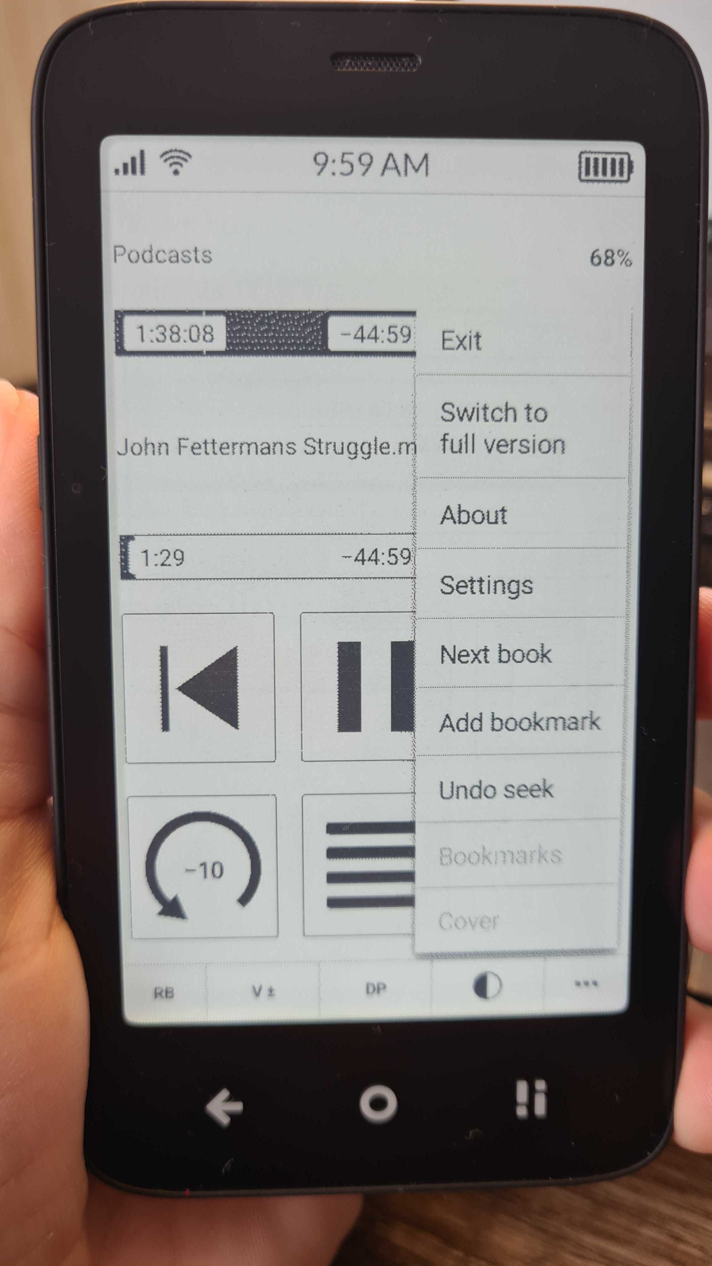

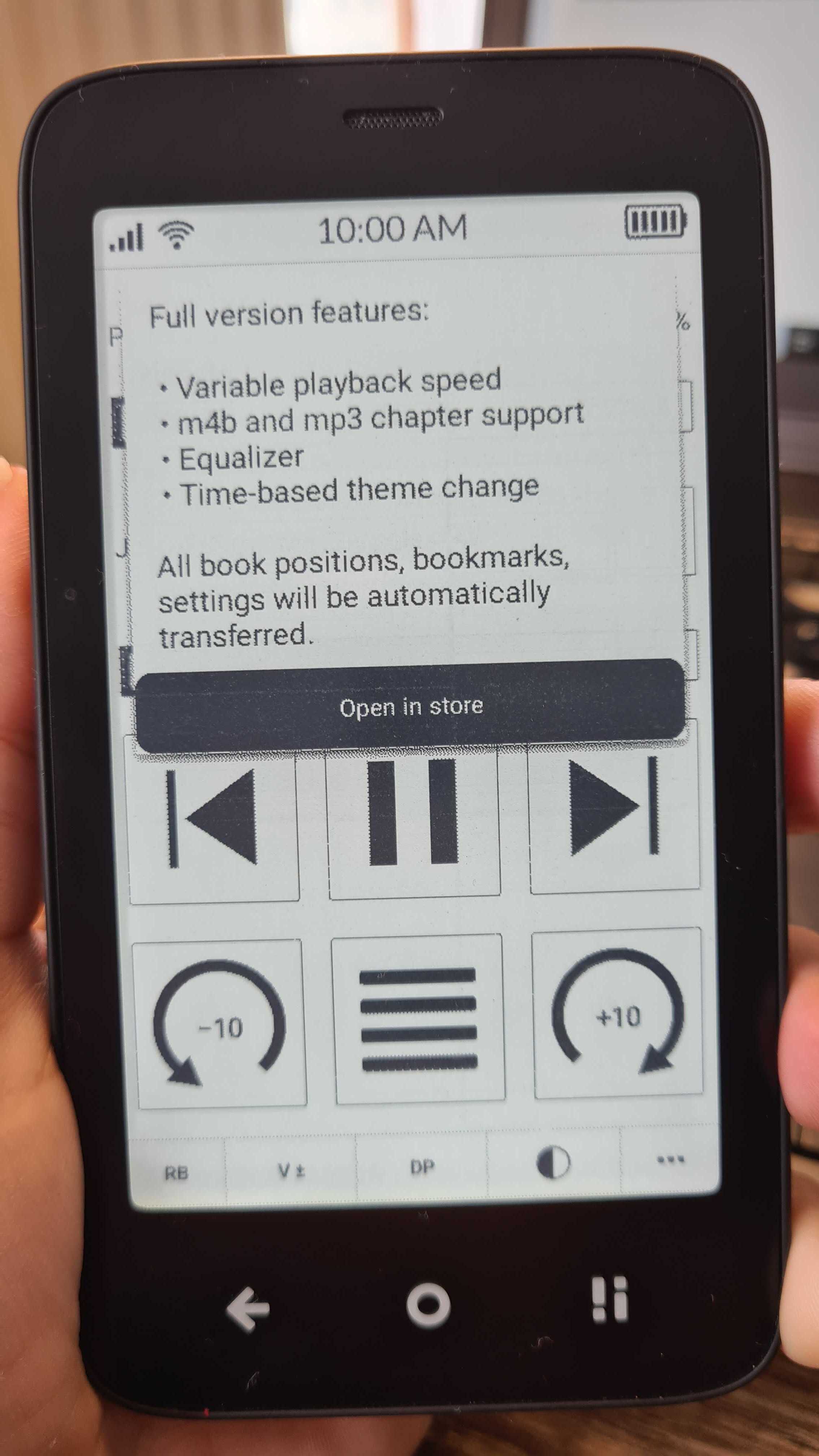

@kirkmahoneyphd Someone on this forum suggested Simple AudioBookPlayer- (Simple ADB Free ) It’s actually B&W in its original form, so on E Ink it actually looks really good (I didn’t like the way AUDIBLE looked).
Thank you for the recommendation, @urszula! I now am back to using my SIM-less deGoogled Pixel 6 for listening to podcasts (AntennaPod) and audiobooks (Audible). I already was using the Pixel in this way as a supplement to my Orchid – a minimalist cellphone. I realized that I can do the same for my Kompakt – another minimalist cellphone. The Pixel’s speaker does a good job with playing podcasts and audiobooks. And, I realize that I was trying to cram too much – for me, anyway – into the Kompakt. Thanks again!

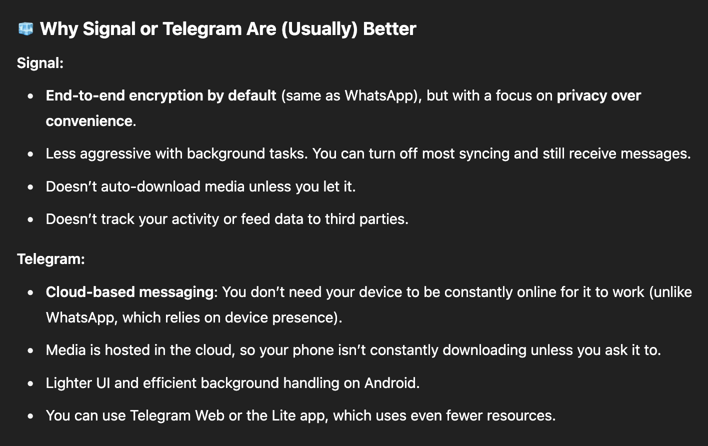

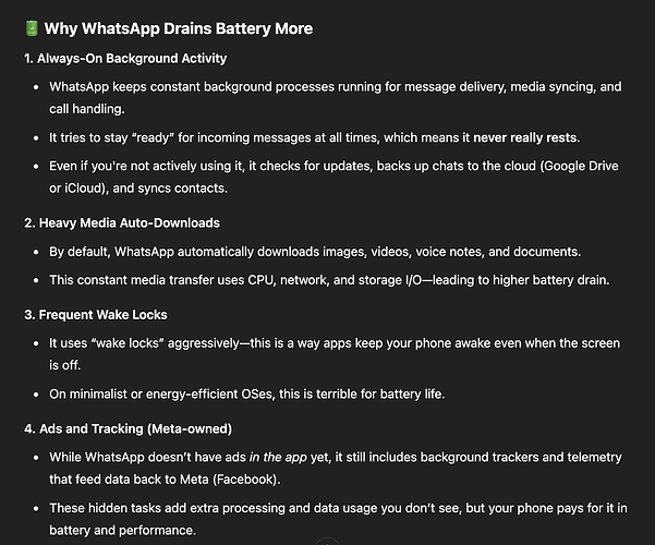

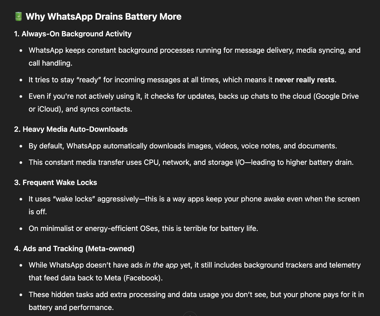

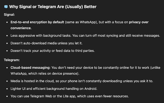

I’m considering which messenger apps, if any, I’ll sideload when my MK is with me. It seems whatsapp is just a bigger drain than most, by default. I also looked into Beeper’s battery drain (because boy, wouldn’t that be convenient if it was battery efficient and all messages could be consolidated) but it seems Beeper may be worse than whatsapp, since it syncs all messages and bridges to other services via their servers. It requires a persistent internet connection apparently (this is all from chatgpt).
Whatsapp / Signal / Telegram info below
Also, apparently Facebook Messenger is a big drain
