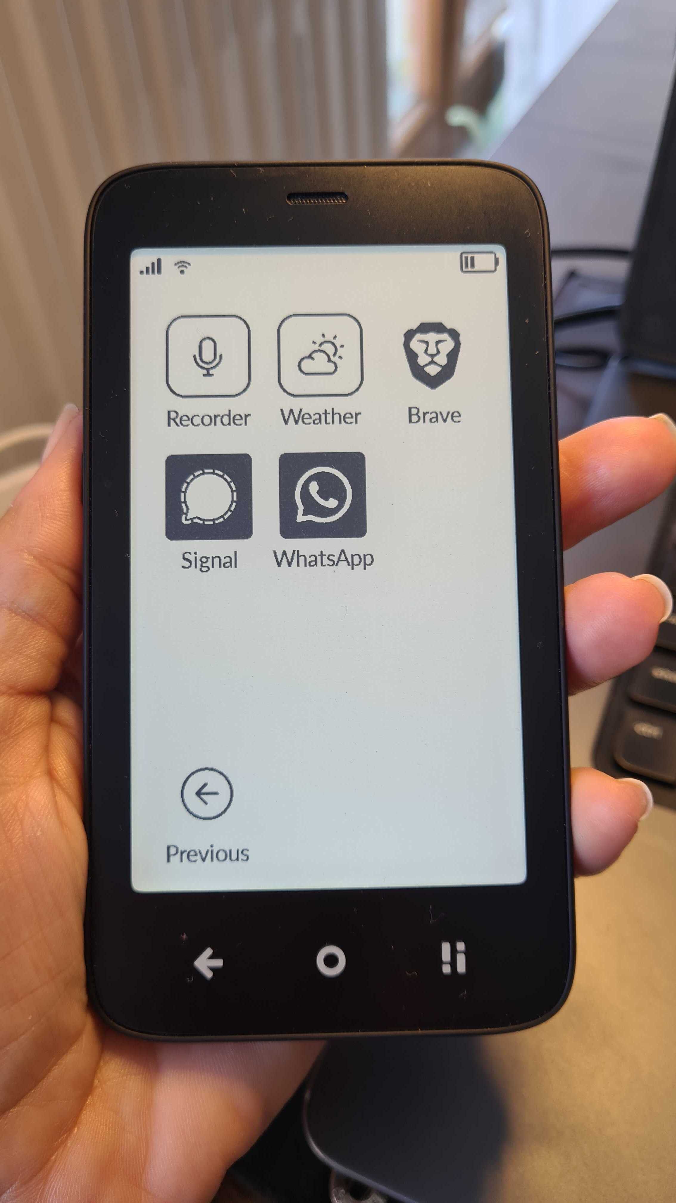

  • Sideloaded WhatsApp, FUTO keyboard, Here WeGo and PocketCasts via aurora store. I leave WhatsApp open in the background, but quit the podcast, maps app after I’m done using them

As per my knowledge, WhatsApp working in the background drains battery very fast. If it’s possible, you can try to disable WhatsApp and check if the battery performance improves.
What would be the way to tell Whatsapp not to run in the background?
What I mean here is, I open the ā€œmanage appsā€ menu, click the app, then choose ā€œForce stopā€
Thanks, although I believe @urszula (and others too) are using WhatsApp, and even other messaging apps, and not quitting them each time - yet somehow achieving a week of battery life (if my memory isn’t wrong)

I’ve been watching the battery a bit more closely. Quick summary: After uninstalling WhatsApp and keeping bluetooth and wifi off, the phone is lasting much longer. In particular, the battery doesn’t drop so drastically when I’m not using it. I’m going to add WhatsApp back to see what happens next. More details below for anyone interested.
  • Fully charged the phone ~ 24 hours ago, and now at 76%. So trending at 4 days battery life…much better!
  • 15 minutes of hotspot usage drained 1% of the battery. So I assume 1 hr = 4-6% (accounting for some likely rounding issues)
  • 1 hr podcast listening consistently uses 5-6% of battery
  • Lost only 3% of battery during 8 hours of sleep. Previously it was dropping ~10% (with WhatsApp sideloaded, bluetooth and wifi on)
when I kill WhatsApp each time after the usage my battery can last 4 days. Without killing, 1-2 days
Great to know, thank you. Killing WhatsApp is very tedious unfortunately, so I probably won’t do that in the long term. Do you still receive notifications from messages after killing the app? I assumed not, but didn’t check.
Nope, there is no info about the app after killing it. But this is kinda good :slight_smile: Less distraction :slight_smile: I can control that by not killing the app if I need notifications at some timeframe
