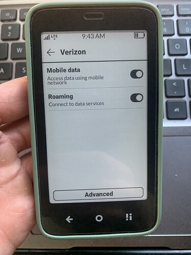

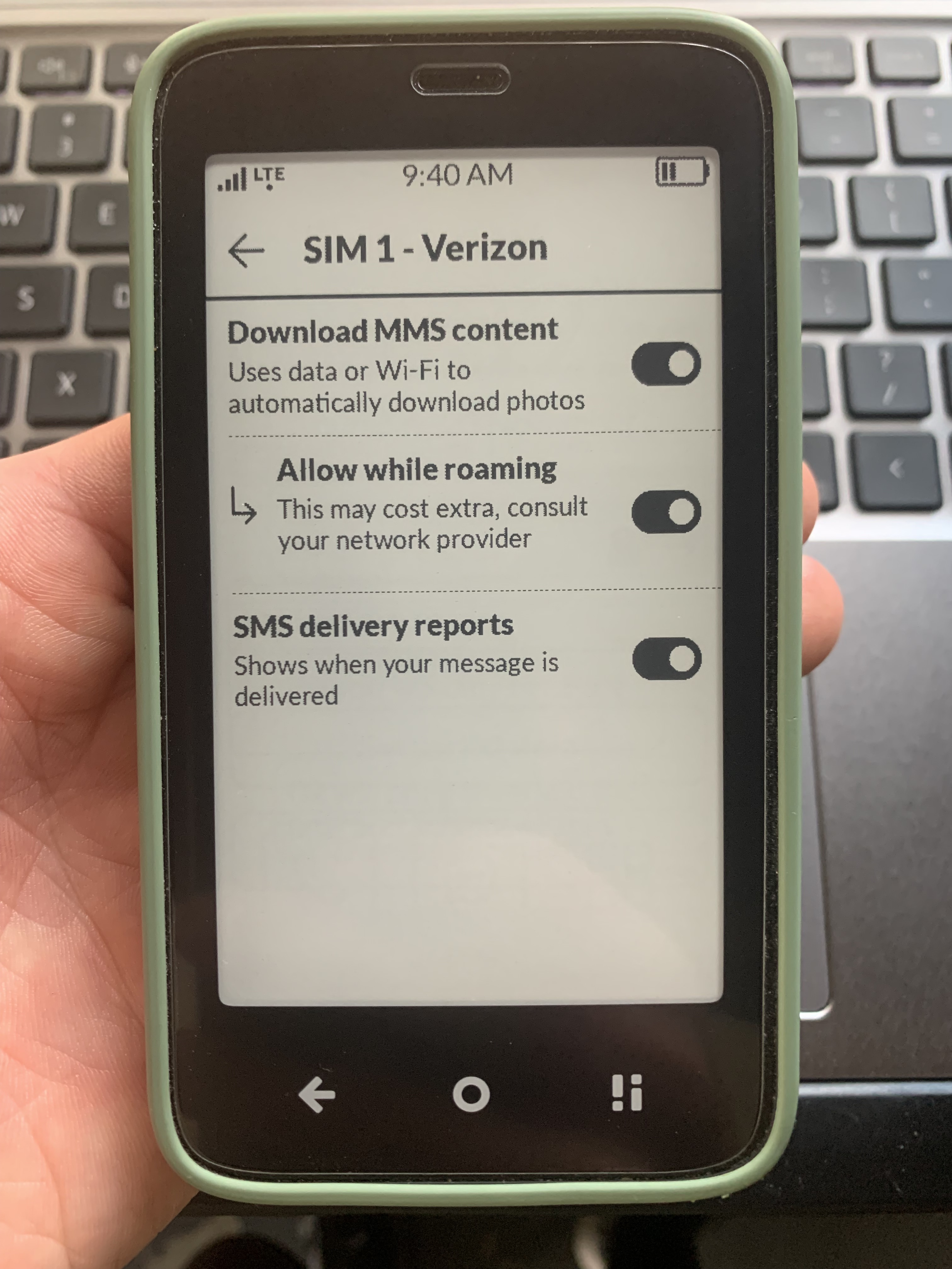

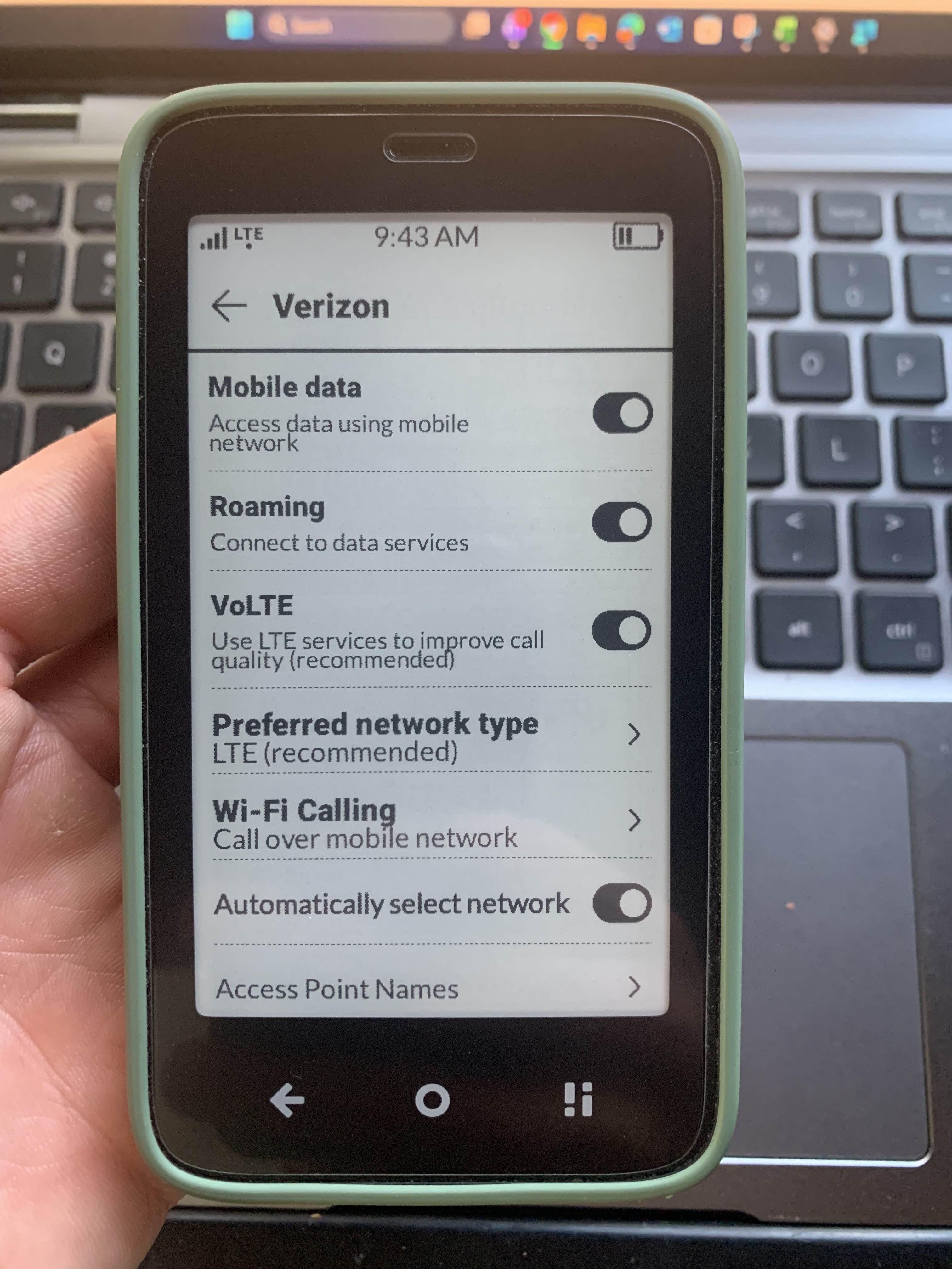

@blazemiller1989 Did you enable MMS messages on your phone?
Believe I have these all set correct yes, tho mine looks a bit different than yours
