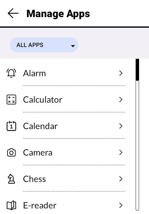

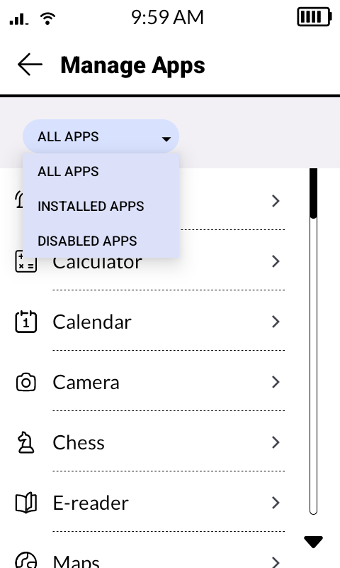

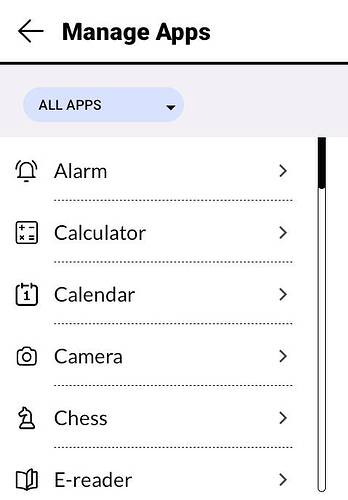

@xyz, I see that you’ve noted that some apps are missing from the default apps section. Do you play poker? I see your issue and raise you: For me, under the ‘Manage Apps’ section, ‘default apps’ is missing altogether. (See screenshots.)

First of all your settings page looks weird: this grey bar with a dropdown menu - it’s not a part of Mudita software - I thought that those parts of system cannot change even with sideloaded apps.
As for Music widget - InkOS has no access to lock screen. You have to press the button without unlocking the phone to see the widget. Are you using fingerprint?
If yes, change unlocking mode in settings (safety > manage fingerprints) into two step option: press and touch.

Aha. The plot thickens. I should say that the grey colour only appears in this screenshot, not on the e-ink display. But @ume_1138, are you saying that you don’t have this drop-down at all? Have I boobed somehow?

Some light grey shades are displayed as white on e-ink, but the whole bar with dropdown for sure is not stock - different layout, font etc. Also on your screenshot this bar hides the top options and arrow on top of page indicator (or scroll bar - whatever it’s called). Can you see it? First item should be Default apps, second Alarm - maybe it overlays top item on the list?
How about fingerprint setting/button press - widget issue?
