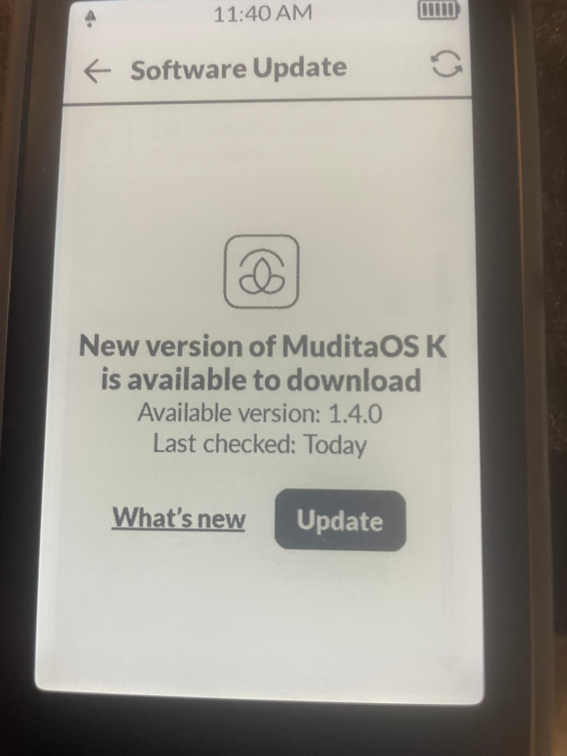

Apologies if this has been brought up elsewhere. I am trying to update my Kompakt, but nothing happens when I click the actual “update” button. Everything else seems to work fine. I have wifi and it’s checking for the update (and tells me there is one) and I have the latest updated Mudita Center, but I cannot update. I have tried restarting the phone. Any help would be appreciated.

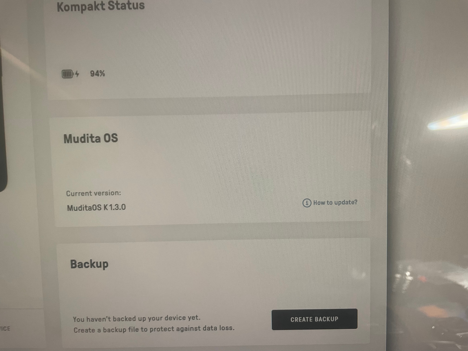

  1. Download and open the Mudita Center on your computer.
  2. Connect your Mudita Kompakt to your computer using the USB-C cable.
  3. Once the device is recognized, go to the Overview section and click Check for Updates.
  4. If a new OS version is available, click Download Now or Update Now and keep the phone plugged in until the process finishes. [1]

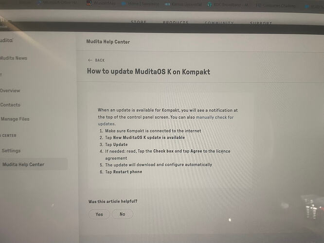

Unfortunately, none of the suggestions help. I do not have a SIM in the phone right now, but I didn’t last time I updated either (this isn’t my first update as I’ve had the phone from the beginning).

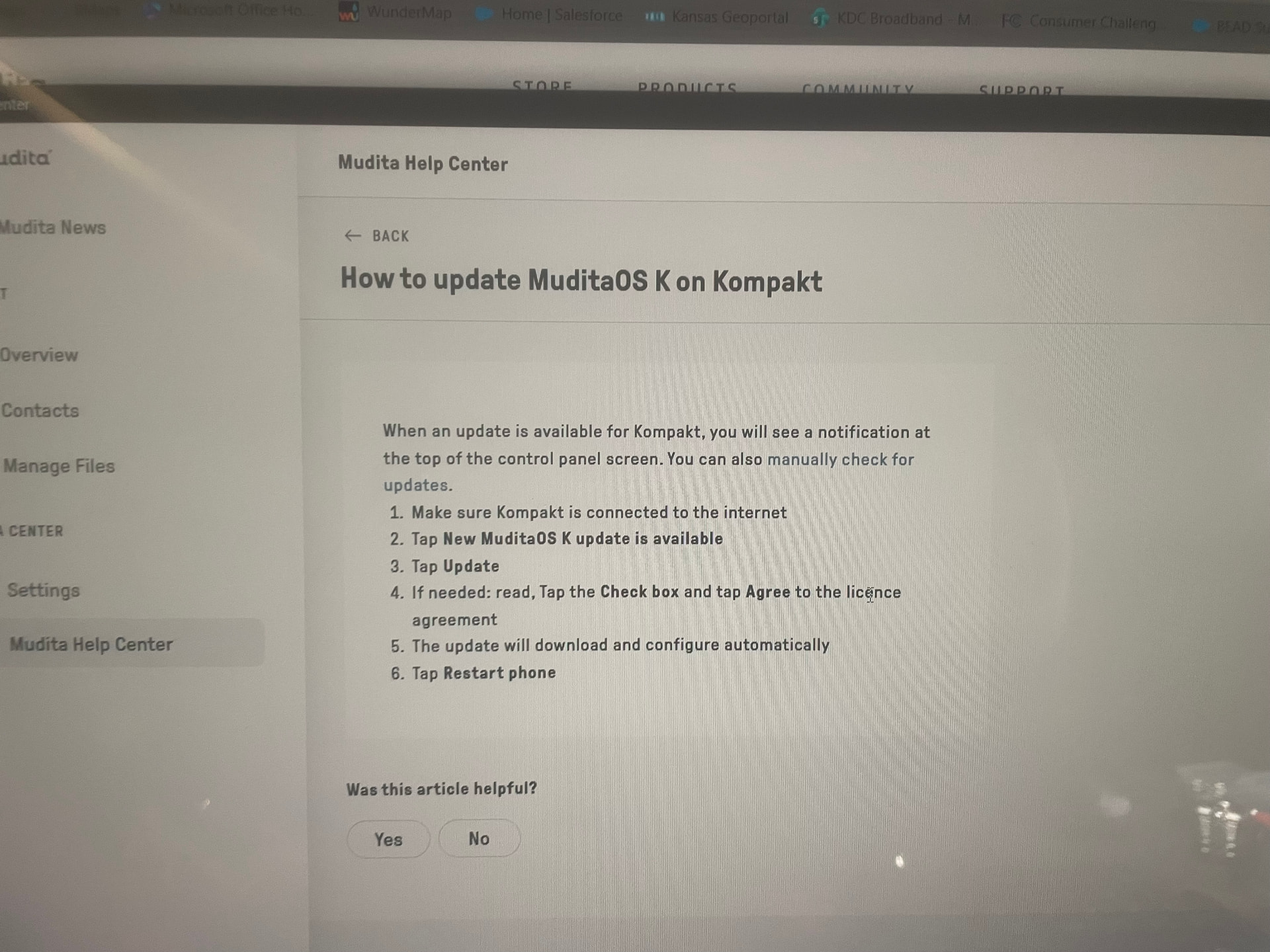

There is no Download now or Update now in Mudita Center; just instructions on how to do it on the phone, which I can’t do due to the aforementioned “Update” button on the Software Update section on the phone not responding (almost as if it’s ghosted out).

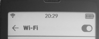

It looks like your wifi might not be on?
Upper left, icon for wifi on…
What yours shows, wifi off, in the picture you attached, but maybe when you tried you had it on?
“Update” button on the Software Update section on the phone not responding (almost as if it’s ghosted out) I think it would be nice if a screen pop up told you that WiFi isn’t connected :sunny:
The WiFi is on…I checked it and it say it’s on but “limited connectivity “, which I don’t understand because it’s enough WiFi to tell me an update is ready and I can refresh (check for updates).(if I turn off WiFi there is a pop up that tells me).
