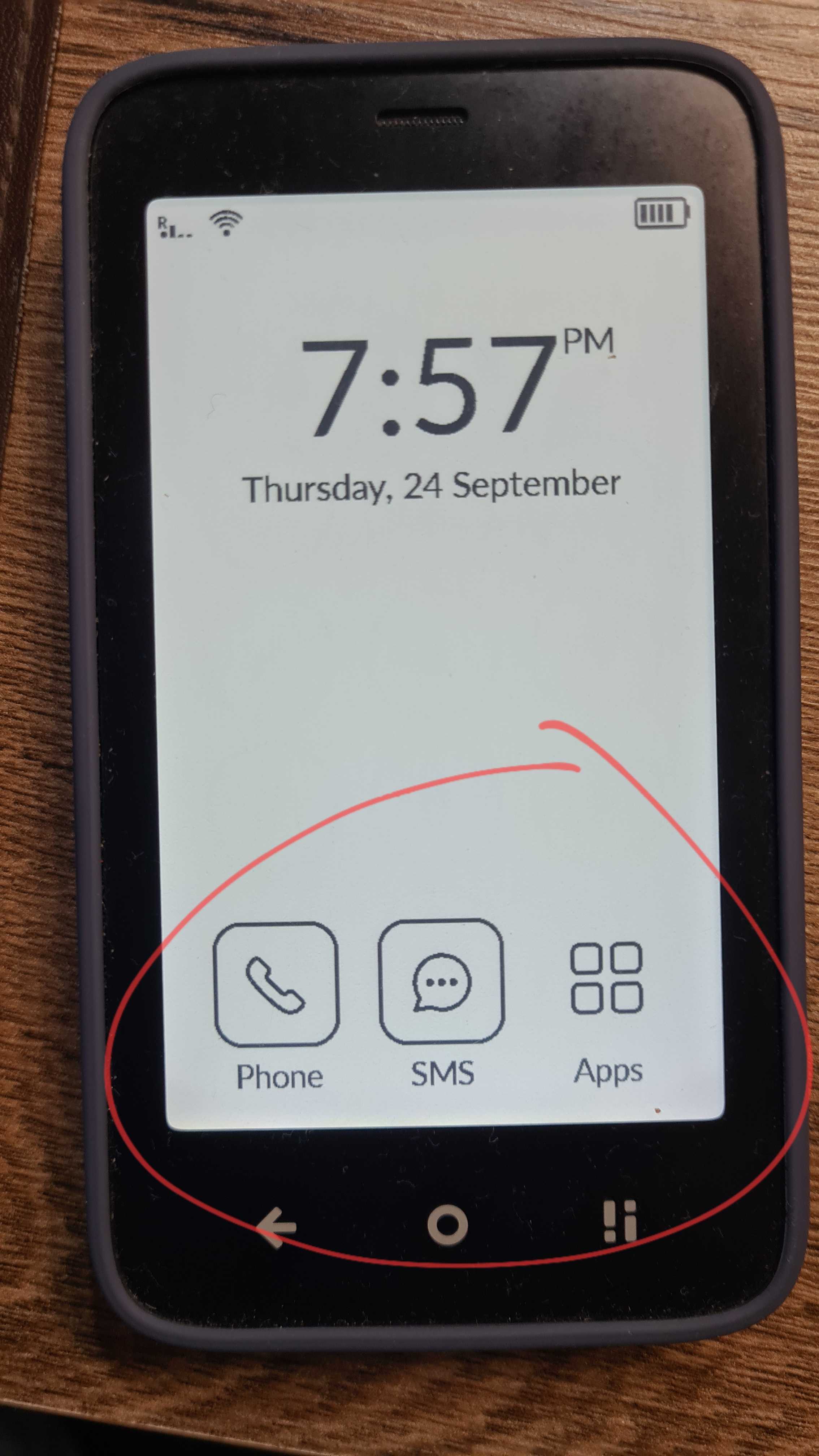

I also wanted to as you, if you don’t mind a more unrelated question real quick, :grinning_face_with_smiling_eyes: if you know if the “Phone” and “SMS” apps will be able to be moved off and reorganized to a different position on the home screen with upcoming updates. In the 2.0 promo pictures, “Phone” and “SMS” are always the first two options on both the standard and Kalm launcher. I was wondering if those will be able to be moved. (Example: On the home screen, Phone and SMS not being present at all, instead placed in the “more apps” section, where things like Alarm and Calendar are.)
With the Kalm launcher, you’ll be able to customize your home screen. Right now, this is the only option in the standard launcher:
Are you asking if with the Kalm Launcher, you can remove them? Or replace them with something else?
I’ll have to ask the team about that.
Yes, exactly, I was wondering if they could be removed and replaced with something else. I am wondering if the update would allow us to do that for both the standard and/or Kalm launcher. Say if you use Whatsapp for phone calls only or Fossify for SMS, and want to replace each one respectively. No rush, just curious.
I’ve asked the team about this. It does make sense if you use different apps for these functions.
